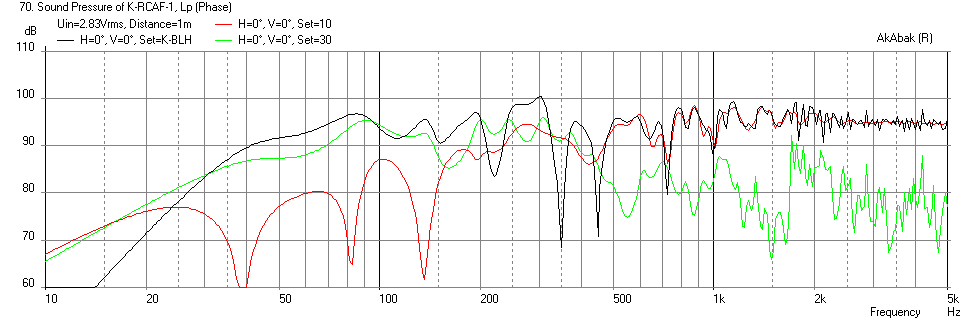

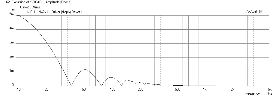

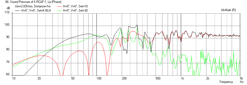

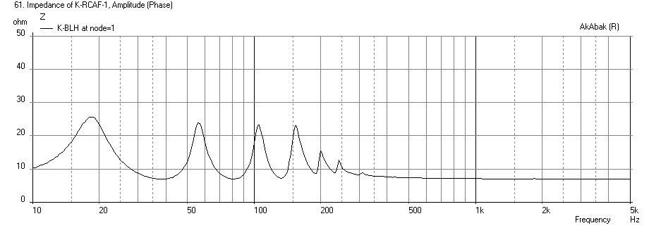

Sim with W8-1772 in Akabak
I just completed my model of the K-slot loaded RCA Fan back loaded horn speaker. Here is the sim with the TB W8-1772. This speaker doesn't have the best bass gain - and as a result cab benefit from 1.5mH+6ohm BSC compensation to tame the HF from this driver. The results qualitatively resemble the AJ Horn results above from the impedance plot and SPL vs Freq as the notches sort of line up.
SPL vs Freq no BSC
Impedance
Cone Excursion
SPL vs Freq with BSC

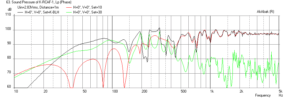

FE166E Sim

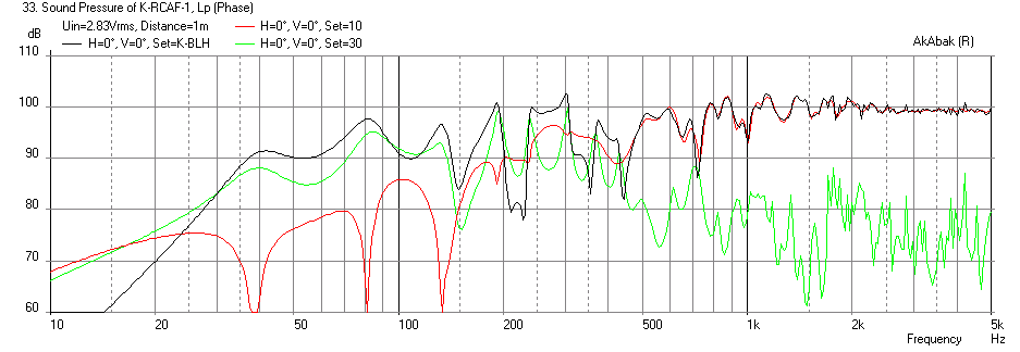

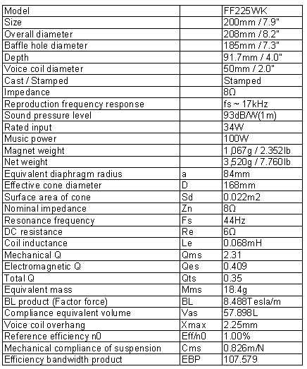

Here is the Freq Response with the FE206E - consistent with observations above. The Fostex is able to produce 94.4 dB at 40 Hz and 88.7 dB at 35 Hz. However, it has a 99 dB peak at 82 Hz that could be problematic.
This morning, I replaced one of my TB-1772 with my 6.5" fostex FE 166E.
Running test tones,
1. Generally speaking, this fostex isn't as efficient above 100 Hz or so.
2. At some point around or below 100 Hz, the fostex is significantly more efficient (I really need to get some measurements going).
3. Additionally with the fostex, low frequency response was extended down to the mid - late 30 Hz area.
In short, the tangband has more midbass, but the fostex seems to have lower bass and better bass definition and extension. I'd bet this is because the stronger magnet is better able to drive the horn air mass.

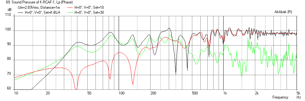

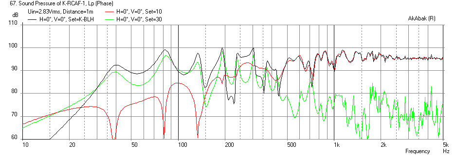

FE206EN
Your wish is but my command... 🙂
pretty cool - how would it look with fe206en?

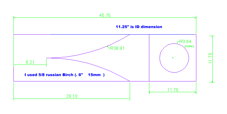

thank you very much - - what benefits might there be to this blh's Fulmer slot vs a square/rectangular mouth terminus? did the aperture require as many ducts/etc. as your k15 model? - its interesting to see the off axis prediction.
would the original Fulmer article cabinet work without a large hole in its response? - it appeared to have almost a straight cross-section - it would be a nice size to put in corners.
according to the drawing, the slotted pipe cross-section is 8.5x9.5"
http://img451.imageshack.us/img451/8349/fuld3px.jpg
just in case a reader isn't familiar with prior art

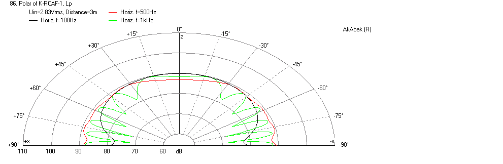

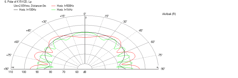

Freddi,
I think you will be pleased to learn that the K15 with its driver located behind the Karlson aperture performs better than the K-slot BLH at 1 kHz (not surprising really as with the BLH mostly it is direct radiation from the driver face, whereas with the K15, it is all funneled through the slot as an acoustic lens). Below are polar directivity plots at 100 Hz, 200 Hz, 1000 Hz at 3 meters for the Beta 10CX. I used this driver because I know it works well in a K15 cabinet already. From the plots I would day that there is a 40 deg or so cone of uniformity with the BLH and about 80 deg with the K15 before lobing becomes a significant issue. These are for sims with the speaker cabinet 48 in away from a back wall.
K15 Polar directivity
K-slot BLH Polar directivity
thanks - we can see that Karlson is vindicated on the issue of dispersion (at least in the mids) - would the factory Karlson 12 essentially scale in dispersion performance? does it matter much in dispersion characteristics with K15 whether the speaker is a 10" or a 15"? 1772 should work in a regular K - I think K12 could have had a slightly smaller rear chamber for 1772 (?)
