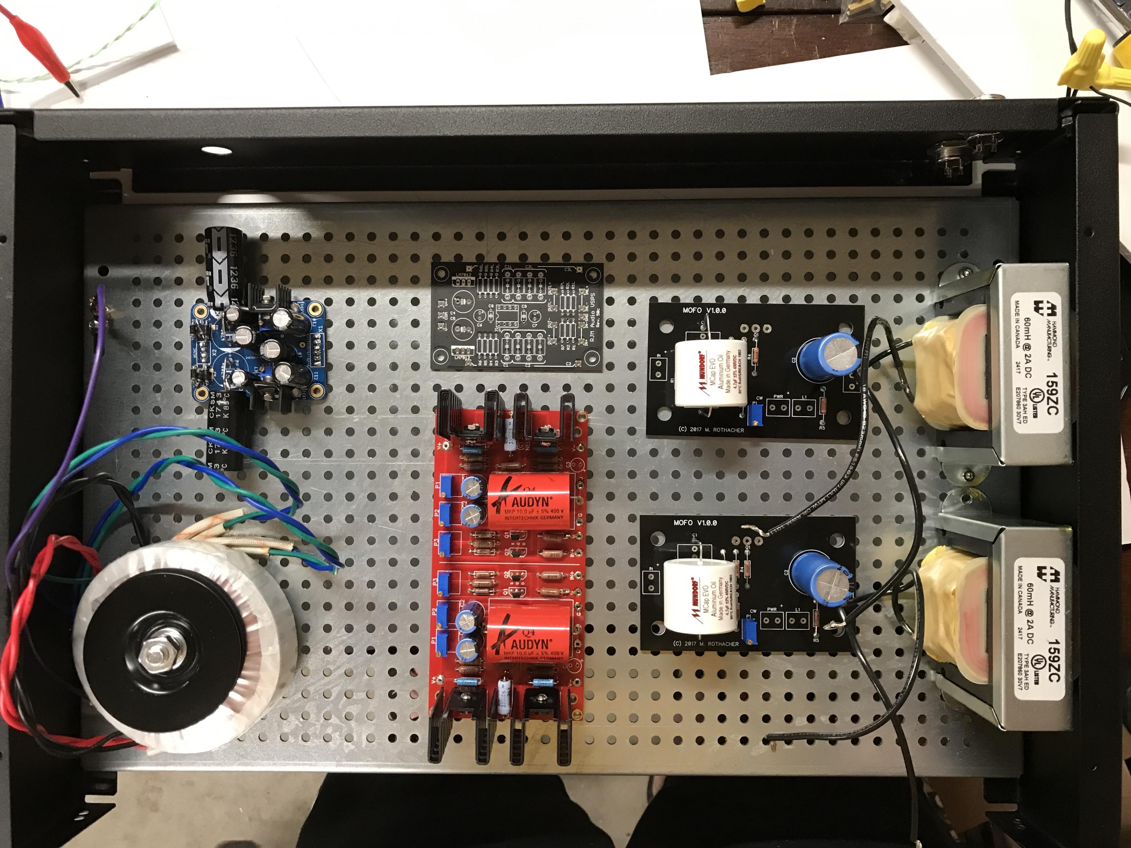

So here’s the mock-up of where everything will live basically. I still need to fine tune the position of the MoFo boards and figure out the left to right to allow for the selector switch and attenuators rods. Coming together we’ll so far though.

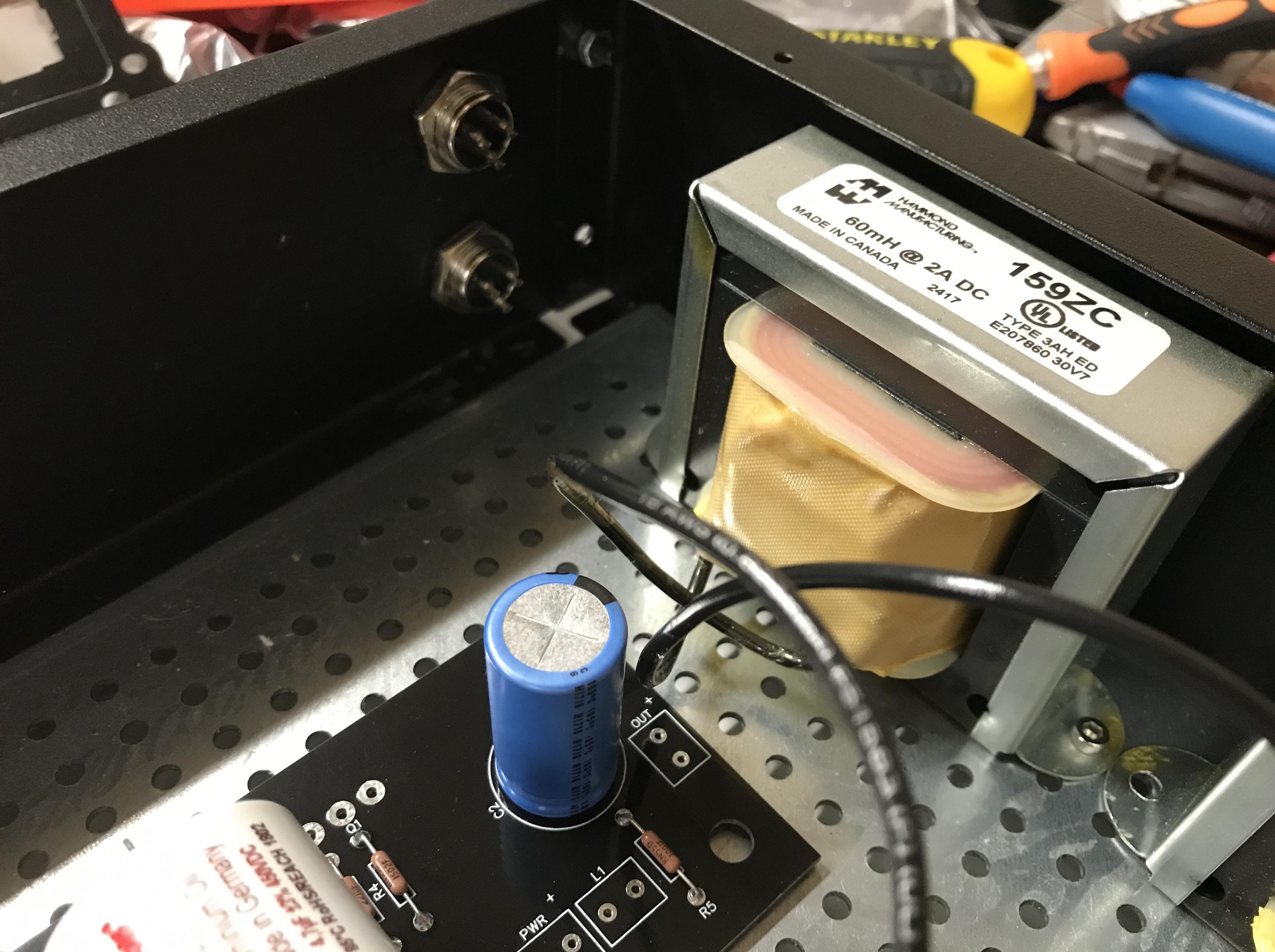

I measured my chokes tonight and they are both coming out at about 42mH. The 159zc are spec’d at 60mH with a 15% tolerance. Do I have a garbage LCR meter or does the inductance change depending on current applied and temperature?

Nice stuff jwjarch,
How are you going to power the whole thing, 2 power transformers?
I'm also in the process of putting a preamp and a big MoFo into the same chassis.
I started a thread in the power supplies section asking about an easy way to power the preamp (requires bipolar supply) and MoFo's, has learnt a few things there.
Precise measurement of a choke will depend, precisely, on the frequency that your meter uses to measure it. Inexpensive meters just measure and don't indicate what frequency is used - these probably use DC current to measure. More expensive meters will allow you to select from a small range of AC frequencies with which to measure. Super precise measurement requires an even more sophisticated approach with more equipment...
I think you'll be pleased when you are finished with your BA-3 & MoFo combination - mine sound very nice together!
Beautiful work Jwjarch! Super that it fits all in 2U! Outstanding form factor, albeit with some nifty CPU coolers hanging out the top. Sort of Mad Max look in a way.

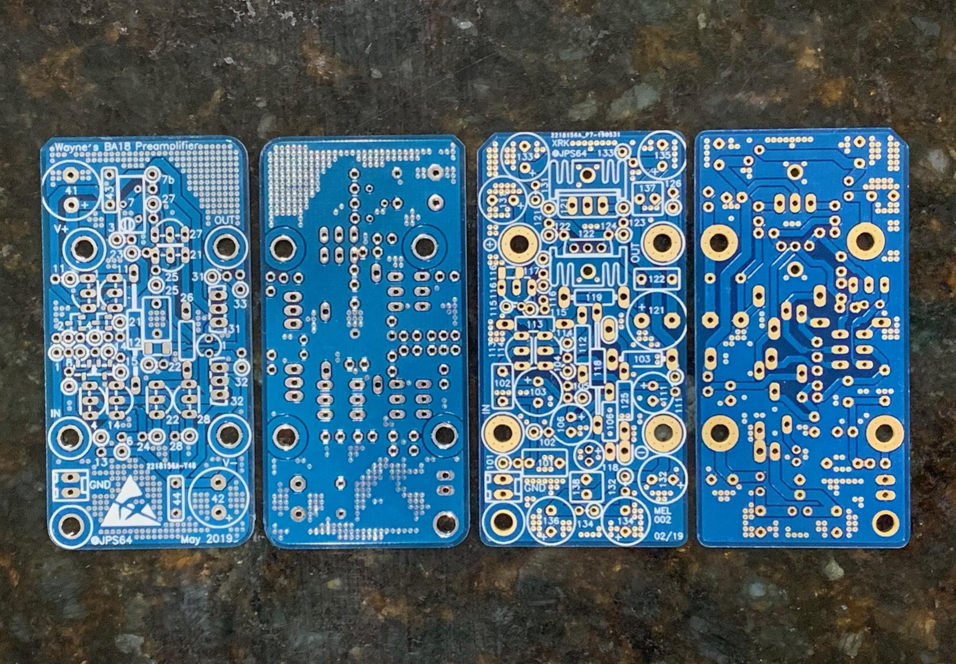

Stay tuned for the Wayne's BA 2018 preamp module for the Yarra (or stanalone) as a preamp. I just got the verification build PCBs yesterday. Looking forward the hearing that and how it sounds with my MoFo as well.
The WBA18 is the one on left:

I use the Dayton DATS v2 woofer tester in LCR mode and it gives inductance as a function of frequency - nice tool.

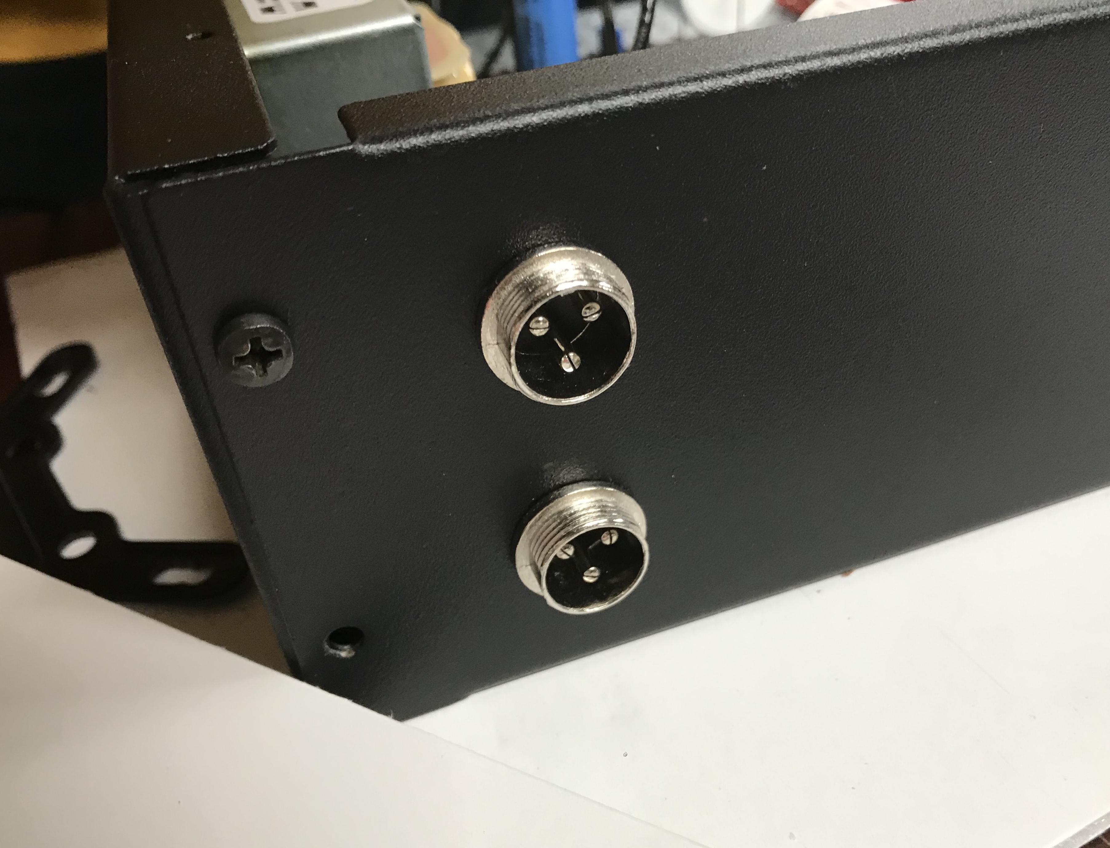

Thanks EmeryBB! I'm going to use the toroid (Antek AS-0520) along with a Prasi SMT Cap Mx board (good call X!) for the BA3 and VSPS dual rail supplies. The MoFo boards will each get a 19.5v, 90W HP laptop power supply. I already modified the cords on the HP supplies to accept the 3 pin aircraft type connectors you see in the photo. I read through your thread in the power supply forum. Interesting initial approach. I didn't want to try and power everything off of the same transformer so I went with the toroid and laptop SMPS's. Good luck with your build!
Eric, thanks for the measurement explanation. That makes total sense. There are too many variables and not always enough standardization of measurements, especially when it comes to audio, i.e. amplifiers rated at a million watts when measuring a millisecond peak wattage at a 1ohm load. Looking forward to hearing this combo sing as well!
