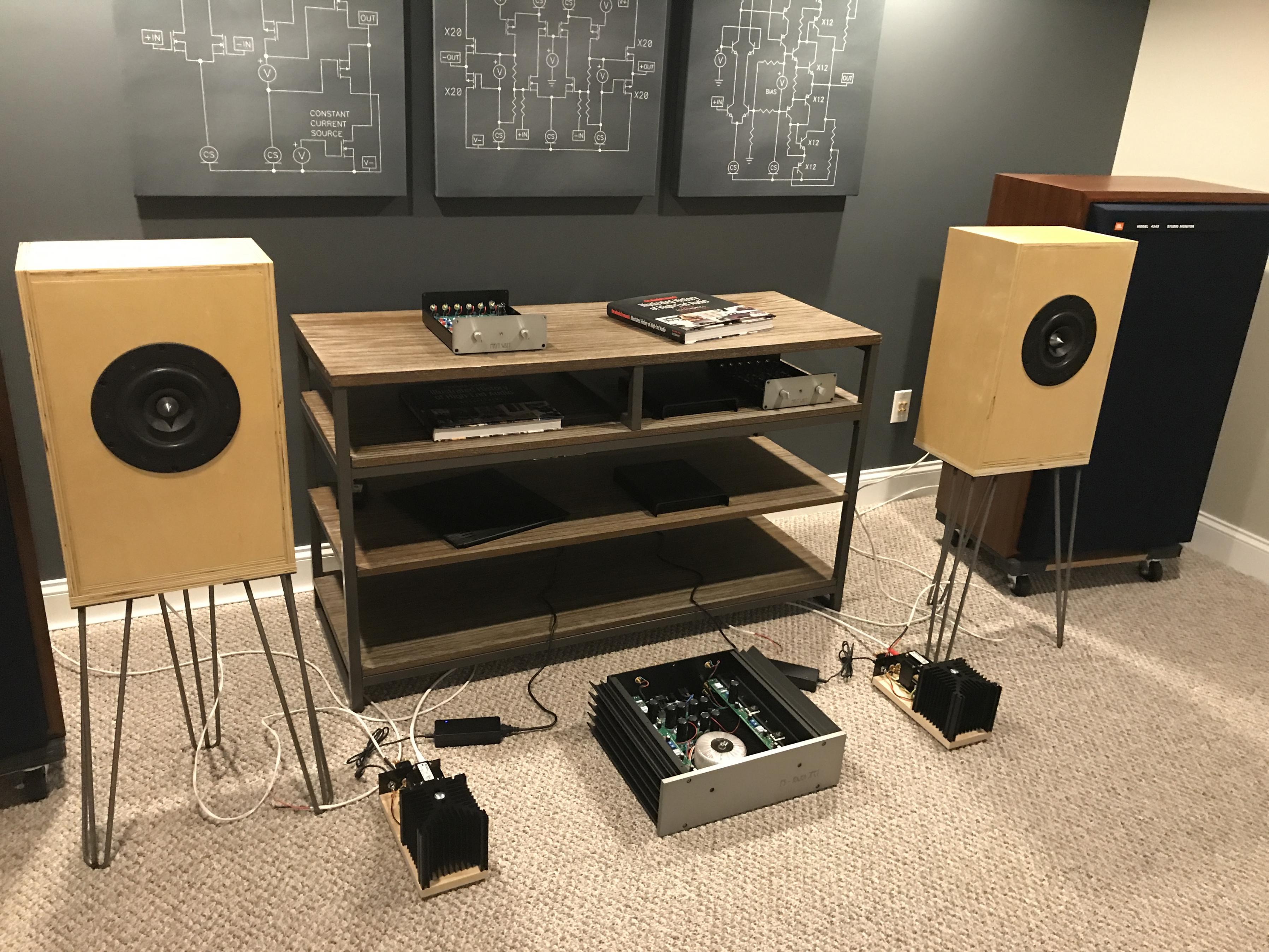

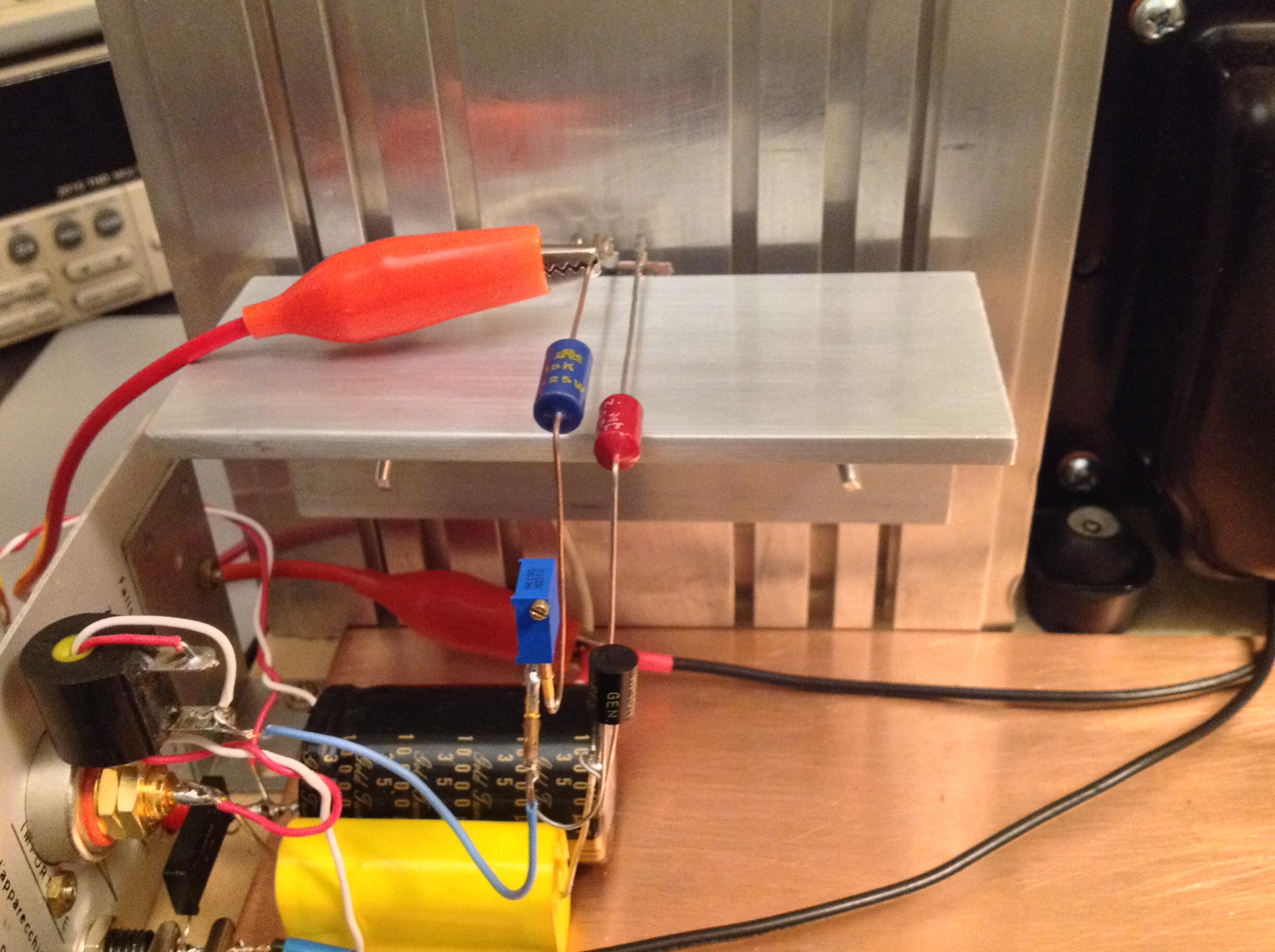

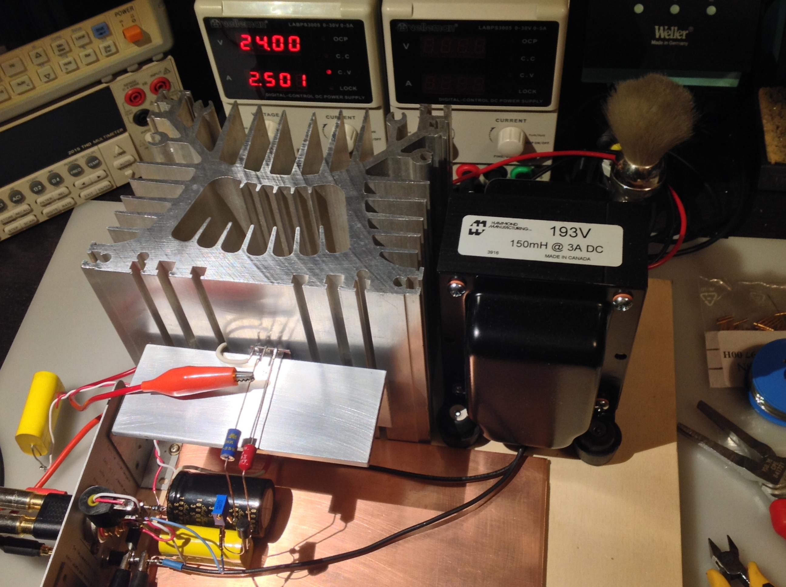

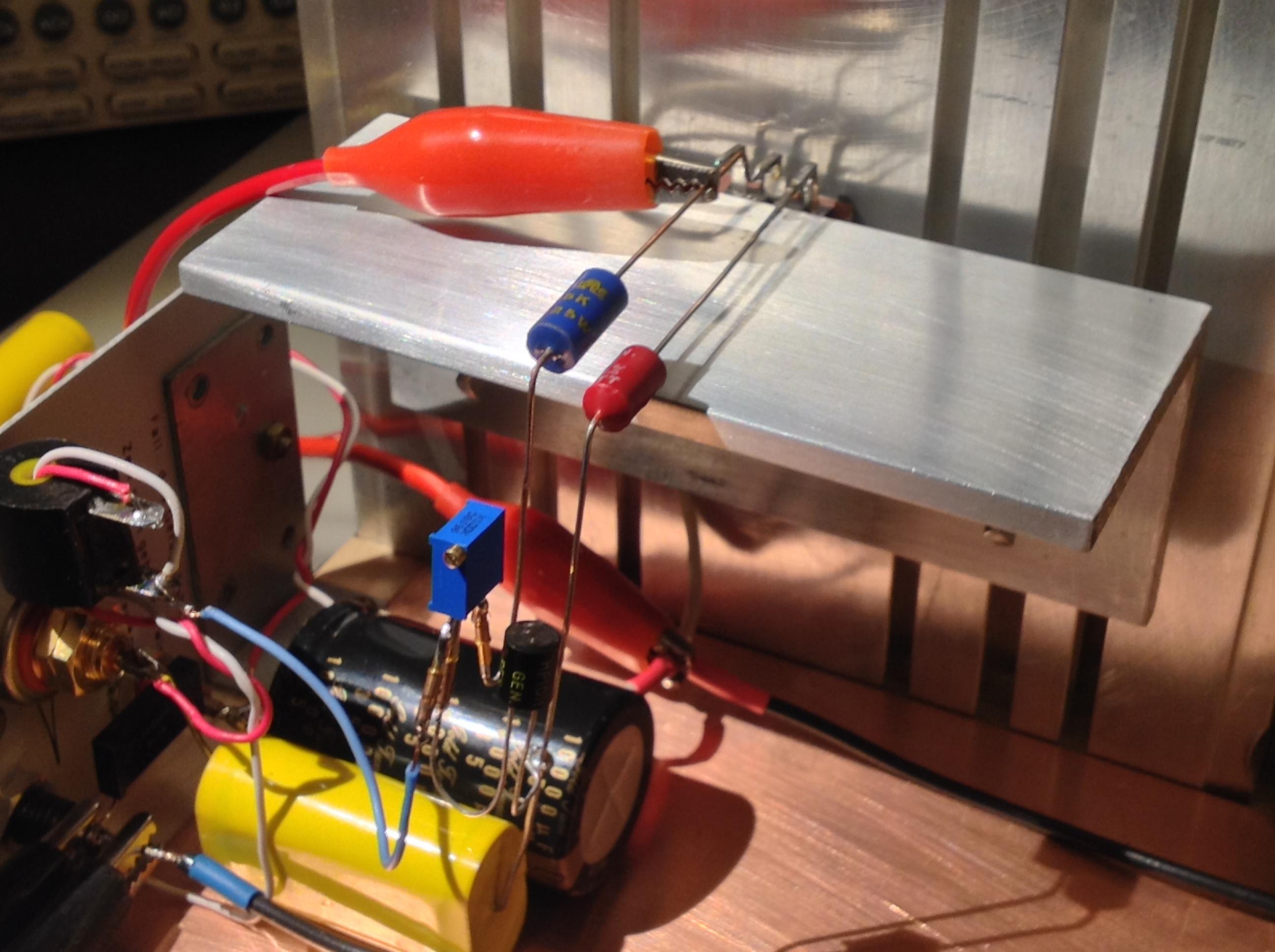

Some pics 🙂

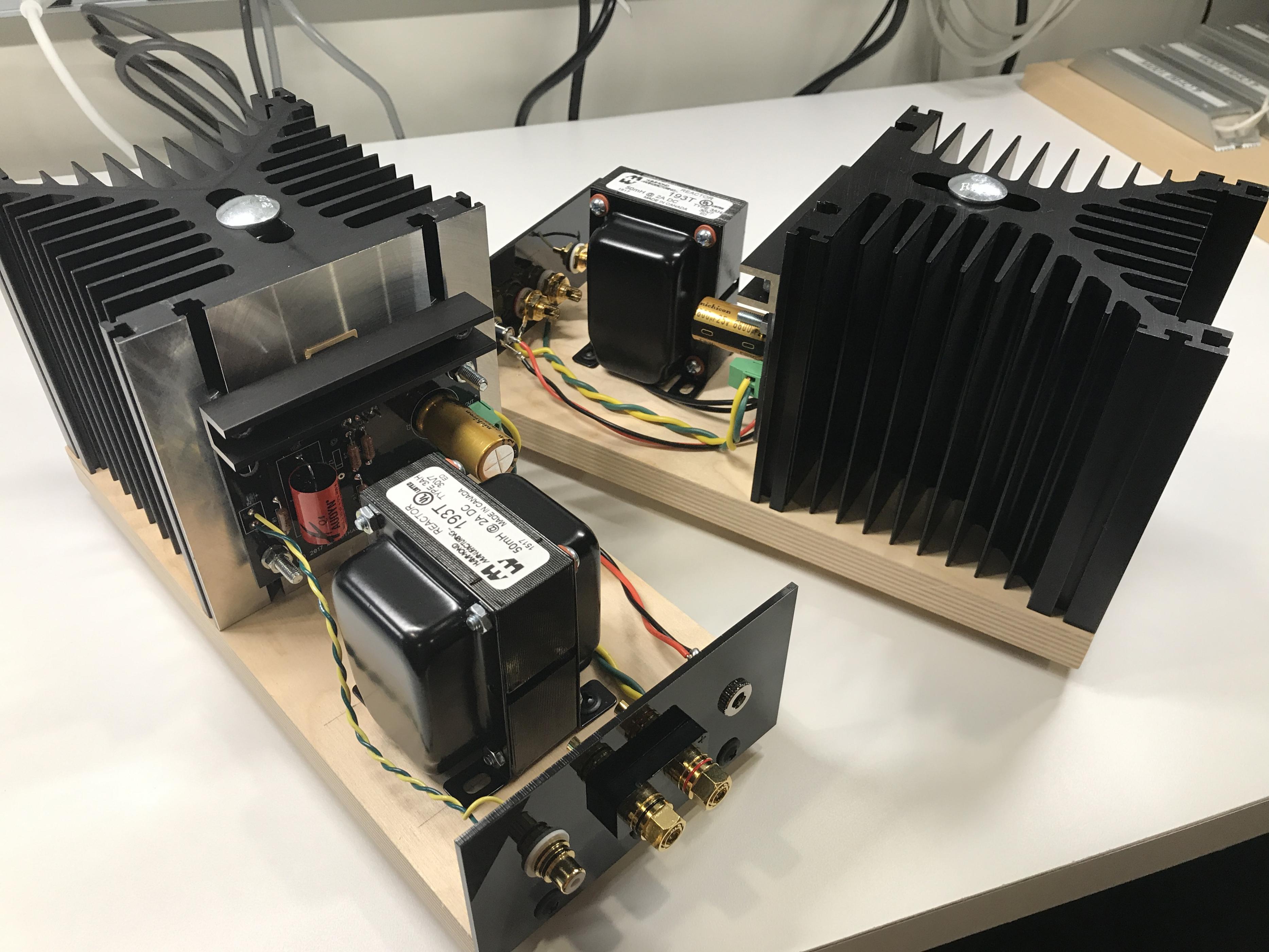

MOFO sing with charming voice

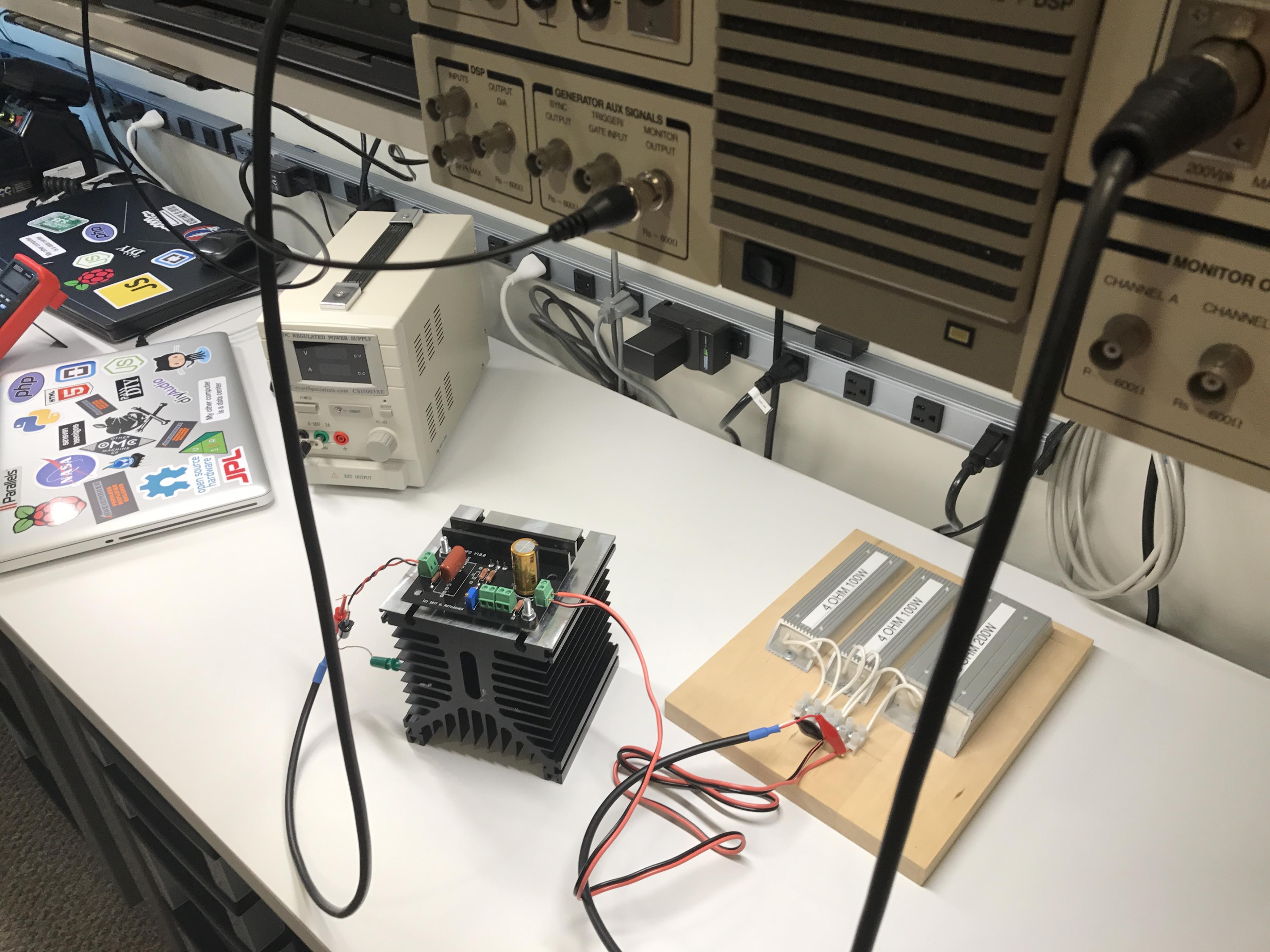

Is now few hours I play music through MOFO amp with a high gain triode preamp and class A audio source. IRFP240 is the horse not IRFP250.My first impressions are Easy, Quick and Fun point to point build with what I have found in a drawer today. PSU = 24 Volt bias = 2,5 A is big 193V Hammond version. Amplifier with his own character :note:
Thanks Michael is BAF projects who make me happy :cheers::house::deerman:
