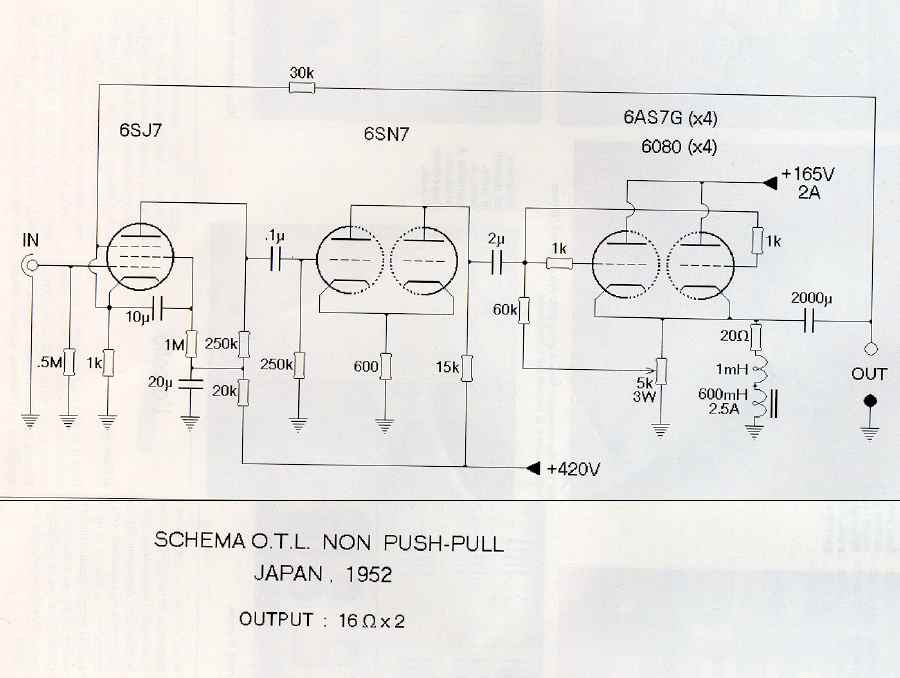

Xrk971, that big 10lb coil of #10 wire will have about 4.5 more ohms of dc resistance so your maxium voltage swing would be reduced by about 7.5V . And one thing I would worry about with big air core coils is if you wern't careful there might be some mutual inductance, About the concern about the distortion in these iron core chokes if it indead turns out to be a problem a possible solution was talked about on Tube Cad and even used in this very old OTL. If you look at the circuite a small aircore coil in in seriese with the much larger iron core inductor. Sort of like we use a quality bypass cap across a big electrolitic

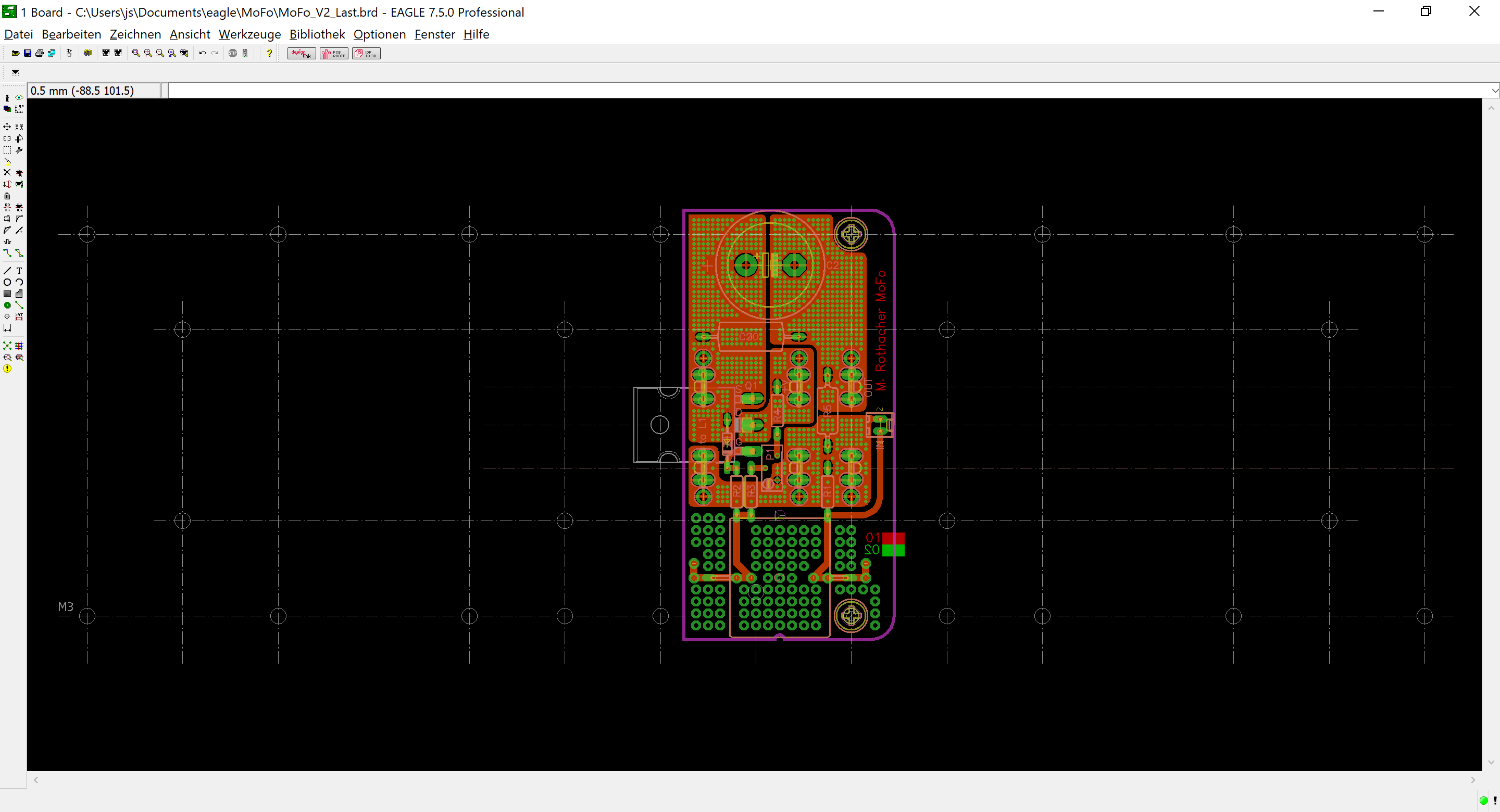

... rapidely... MoFo meets UMS and spades allowed...
JP

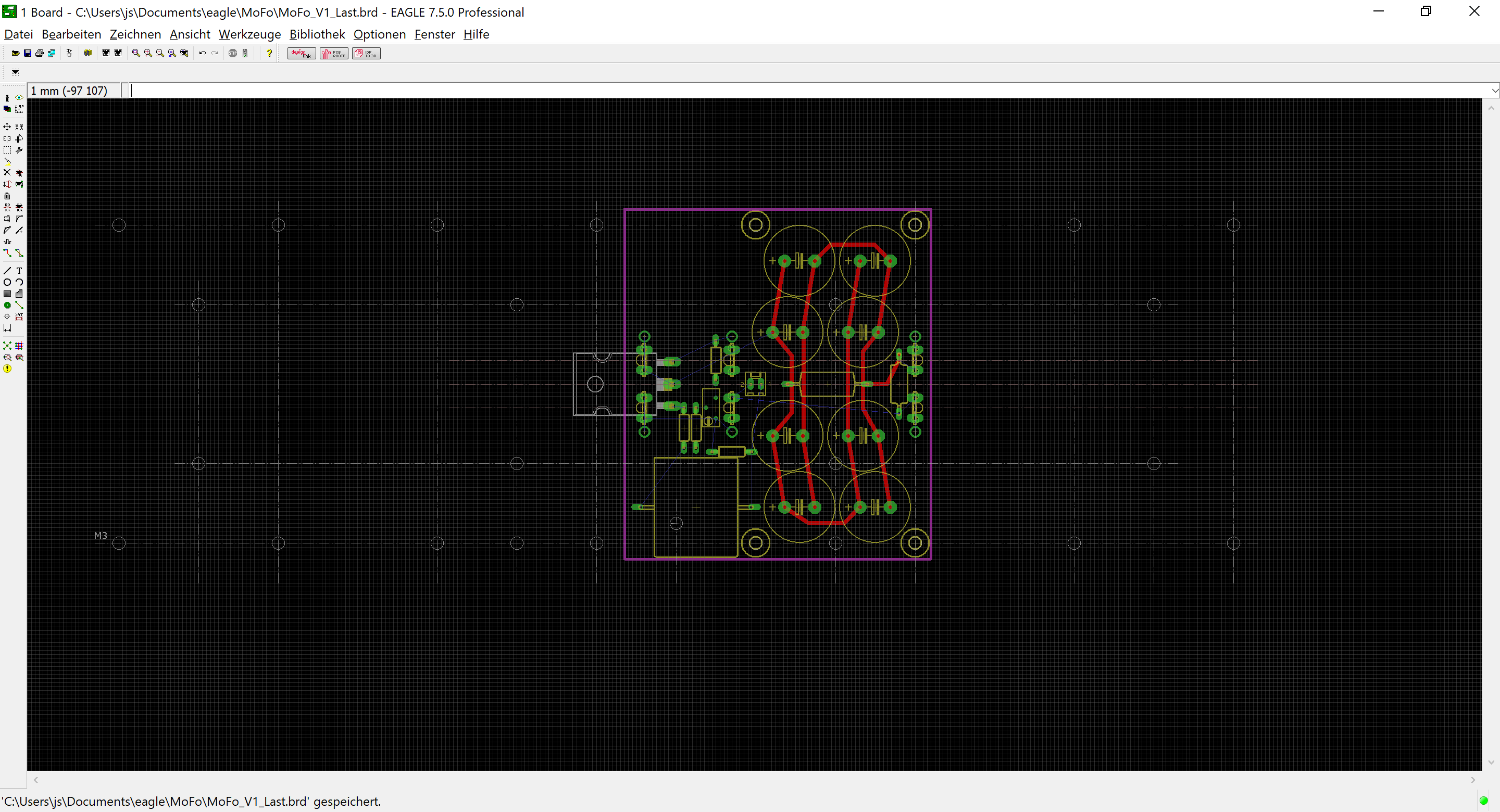

From original MoFo 2 caps to 9 pcs.
Haha 18 caps stereo !!
Only 12 steel spades for two chanels + 2 connection's for free :rofl:
Cheap gold and diamonds and let's go maximalism.

@Soundhappy
In the ACA thread, Mr. Pass recommended paralleling of n+1 ELNA Silmic capacitor!

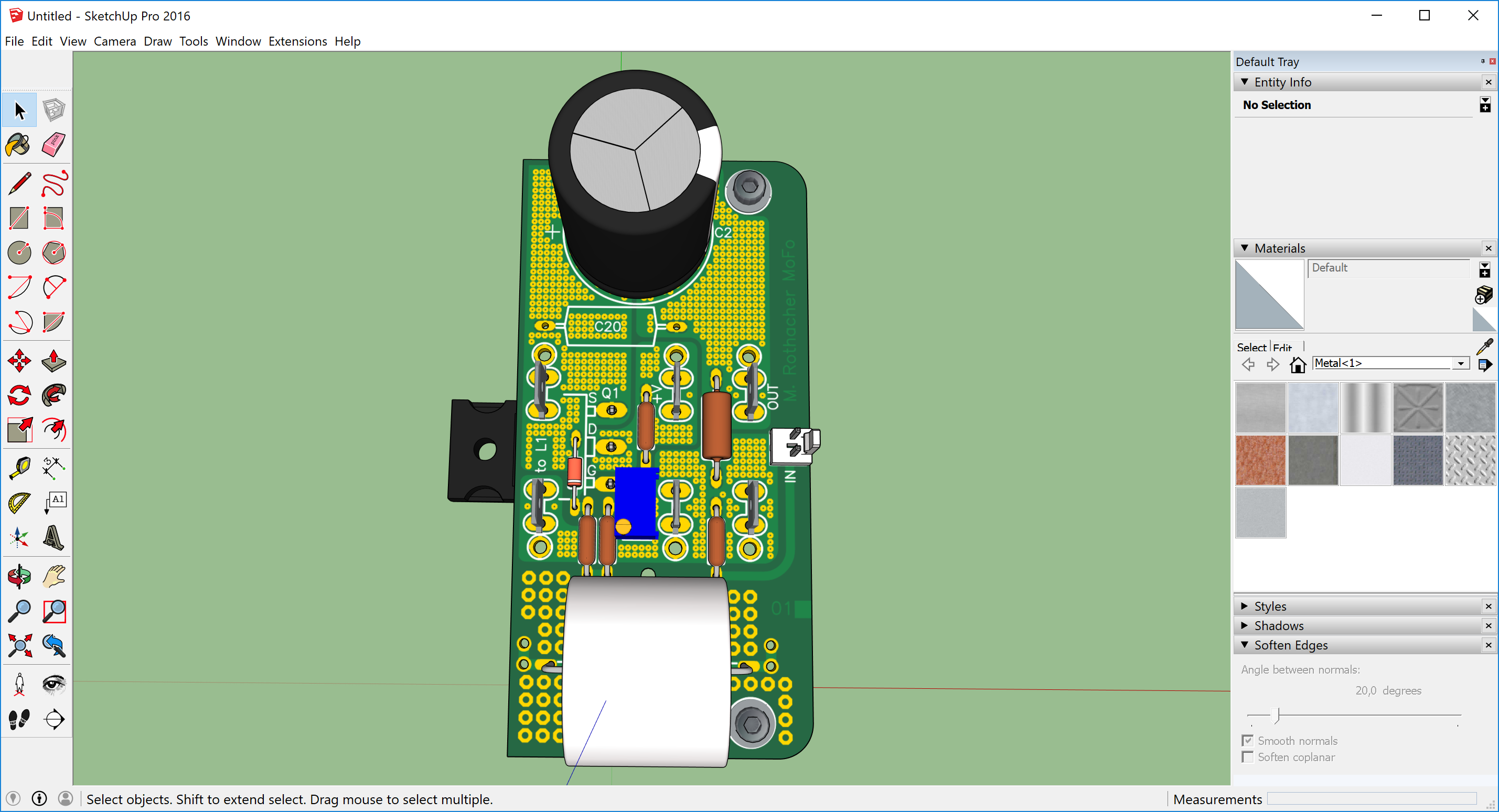

For experimentation, place holder for MKC one (I´ve a big batch Vishay´s 1860 from Pollin).
2mm holes for spade hater.
Vishay/Dale resistors.
Finishing dummy definition for input coupling capacitors to fit different manufacturer ones (Mundorf EVO showned).
Placing done, breadbord for evaluation can be start before finishing PCB.
JP
Mr. Rothacher boards existing therefore I´ll never GB my board!
I pick up the design to build one for my own listening pleasure, and yes also for mp3 listening. Just DIY!
Merci/Danke/Thank you Mr. Rothacher
P.S. same procedure and rules for my own Korged B1!
Thanks for the bypass choke tip! Trying to wrap my head around it but now makes perfect sense. The inductance on the big MoFo steel core may drop off at higher frequency. Which is where you want the air core to kick in. Cool!
