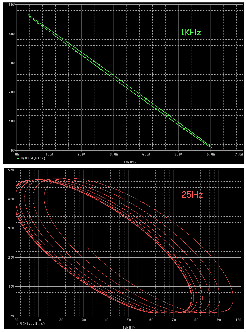

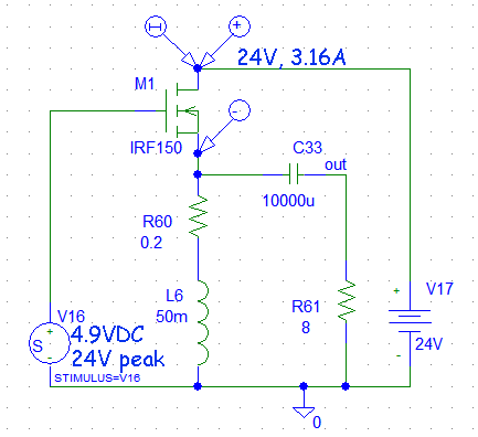

PRR if this was inductor loaded common source amp your calculations would apply but I believe when used as a source follower things may be drastically different. Just look back at the article and you see the amp is only down about 1/3 db at 20 hz.
That's small-signal response.
We may want large power at low frequencies.
me> 50mH will support 8 Ohms down to 26Hz.
Whichever end of the MOSFET we load at, 50mH at 25.5Hz is 8 Ohms reactance in parallel with the load. This bleeds-off the limited maximum current available from this amplifier. Maximum output is reduced.
Here's plots. At 1KHz we get a near-linear loadline. At 25Hz we get a wide oval which, for the same level, clips at both ends, not the same, so bias-shift also.
