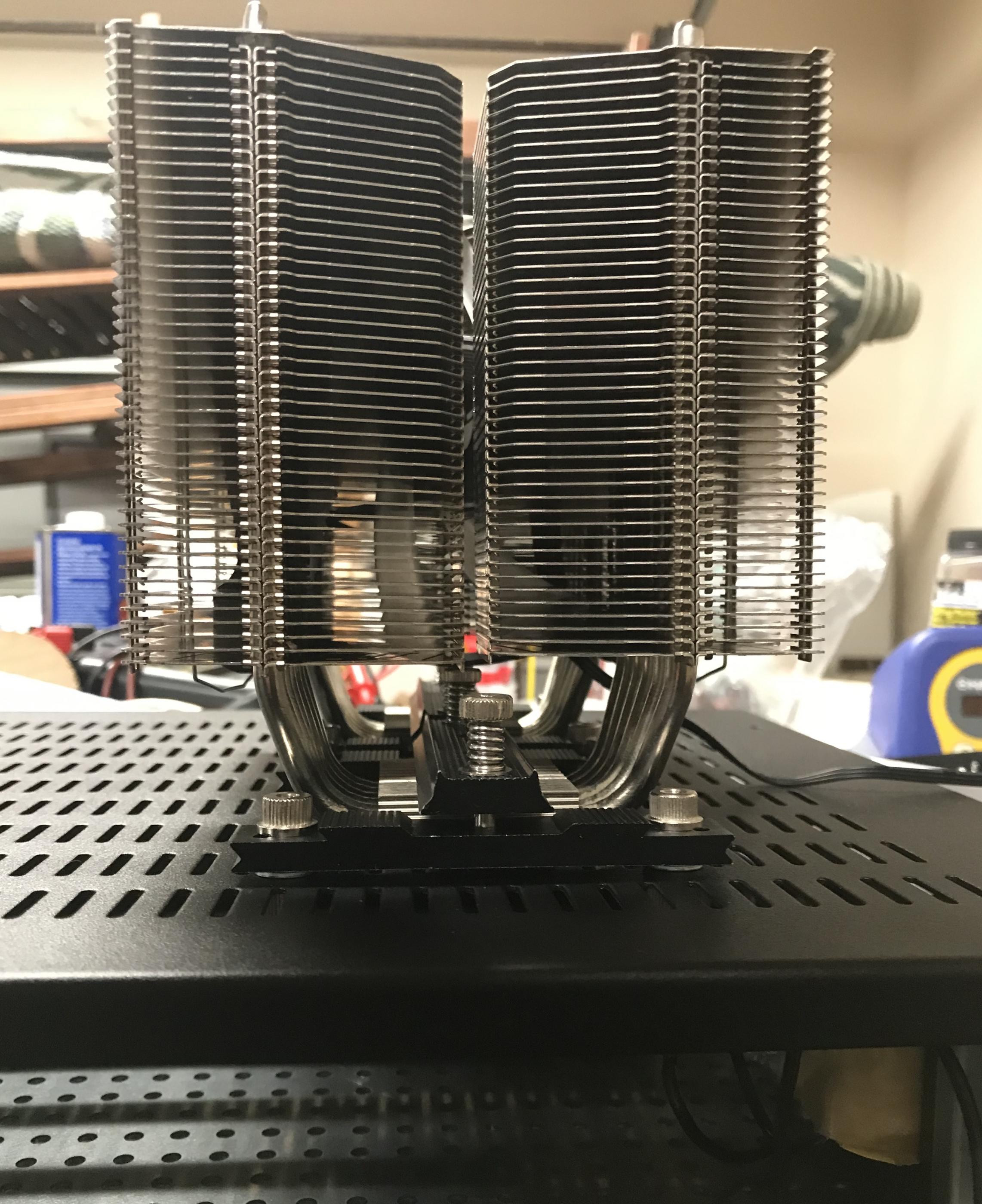

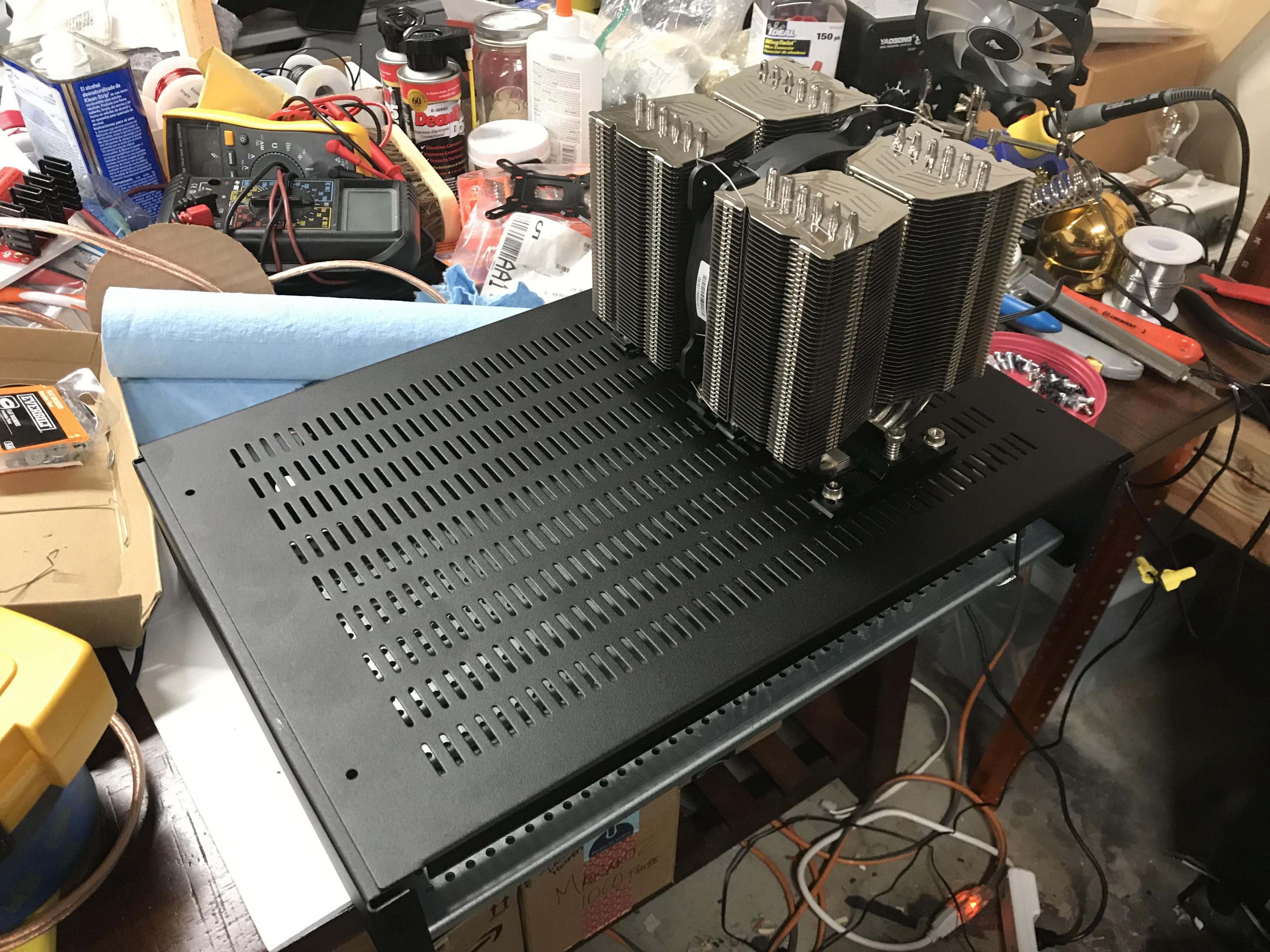

Sharing some progress on my MoFo. I’ll just say, this isn’t going to be quite a standard build. I plan on using most of the space in this 2U chassis. Curious to see if anyone can guess what I’m up to. :cool:
Love those CPU coolers with a single fan for sucking and blowing in one. The second one will get about 6C hotter air if that matters. (vunce tried same thing I think). I am guessing the rest of the 2U case is the Yarra/Melbourne preamp?
How will you fit any 67mH inductor inside a 2U though?
Joined 2014
Hi JW,
I used a similar setup with my Alpha20 with tunnel and the downstream cooler was approximately 6-8°C warmer.
The Big MoFo with cpu coolers works excellent!
Looking forward to seeing some progress pics ;)
Good stuff MEPER, X and Vunce! A tube pre is not in the plans but I do plan to make the pre somewhat "swap-able" in this case. The starting pre-amp is a very special one indeed. If you look in one of the photos you can just catch a glimpse. ;)
The chokes I'm using are Hammond 159zc's which fit nicely in a 2U chassis. I realize they only handle up to 2A but that should be fine for now. I was contemplating wiring (2) zc's in parallel per channel. In theory, it would halve the inductance and resistance, and split the bias current between the two chokes, correct? The chokes would be pretty close in proximity but I think I could potentially use an coupling to my advantage, in an additive configuration, yes?
Since this is an integrated build I also have an RJM Audio VSPS going in. We'll see how everything plays together.
And yes, I expected the rise in temp on the 2nd CPU cooler. I wanted to keep the top of the case as clean as possible so I went with a single fan for now. If temp becomes an issue, which I don't expect with 19.5v supply and 60mH 159zc's, I can always rotate the sinks and add a second fan.
More pics to come!
Joined 2014
More pics to come!
Ahh, with this power supply and cpu’s you’ll be “cool as cucumber”.
I wouldn’t worry about the downstream cooler. Keep the aesthetics clean and tidy :)
