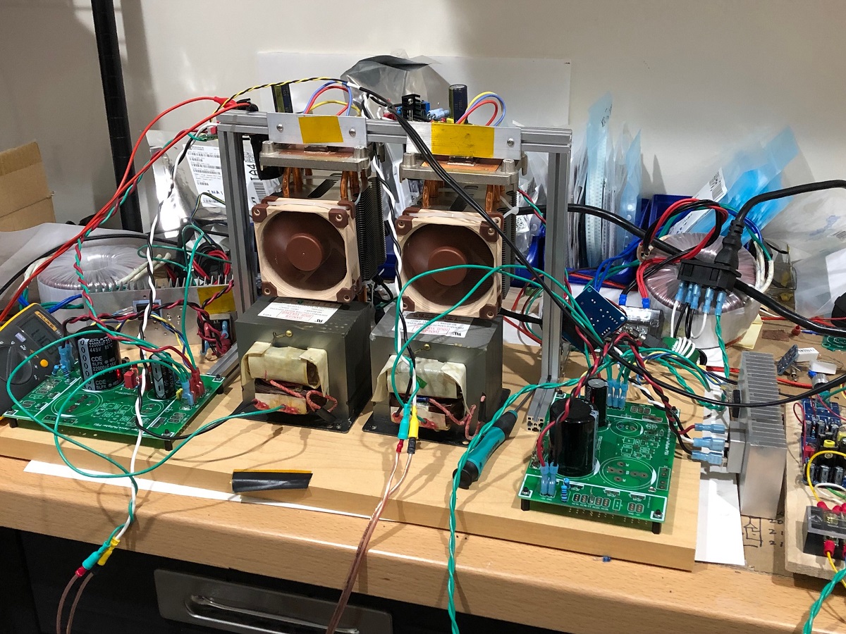

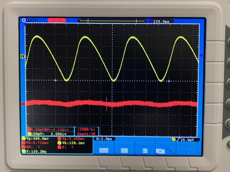

I’m starting on another MoFo but this time using an SLB SR power supply. Will be fed by Antek AS-3222 which will provide about 25v at 3A. With the SLB SR, I am getting less than 1mV rms ripple as measured with 8ohm 100w Dummy load.
Here is scope shot of input (yellow) to pass-BJT and output (red) of the ripple eater:
I will be using JPs64’s Excellent MoFo boards:
Will drive with an Aksa Lender pre running at about 27dB gain with a 48vdc power supply.

The limiting factor is heat removal. I ran mine at 37.5v and 4.35A - that's 163w per channel. Had to use an IXYS MOSFET, CPU cooler and fan but was getting upwards of 49w. Of course, you will need a clean preamp that can drive 57vpp.

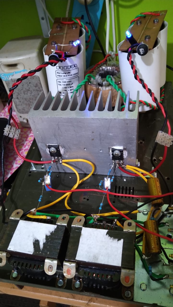

Hi all,
MR, thanks for the design. Here is my attempt to build the amp.
Custom ordered choke not the Hammond ones (different specs from the Hammond). Voltage drop across the choke is about 2.7 volt (2 ohms Rdc). Modded a bit to adjust with available components in my drawer. Currently set to about 1 A bias (fluctuating AC mains) and of course, the HS gets really hots after ten minutes of music play. Hunting for bigger HS now.... 🙂
Once getting a bigger HS, higher bias current will be exercised.
