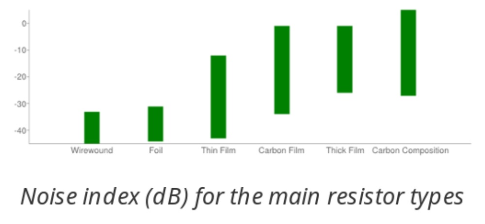

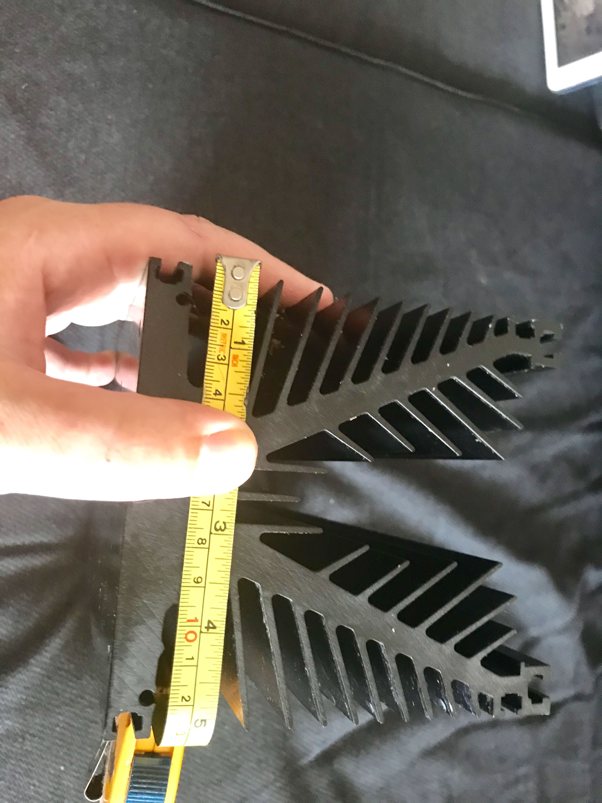

Building two Mofo mono block is my new audio project and I start to list all components to order...
I would like to use the best of it and I am feeling a little bit lost concerning resistors ( too many reference, different temp. coefficient, etc)..
Please could you advise me with precise references ( Vishlay n°…)

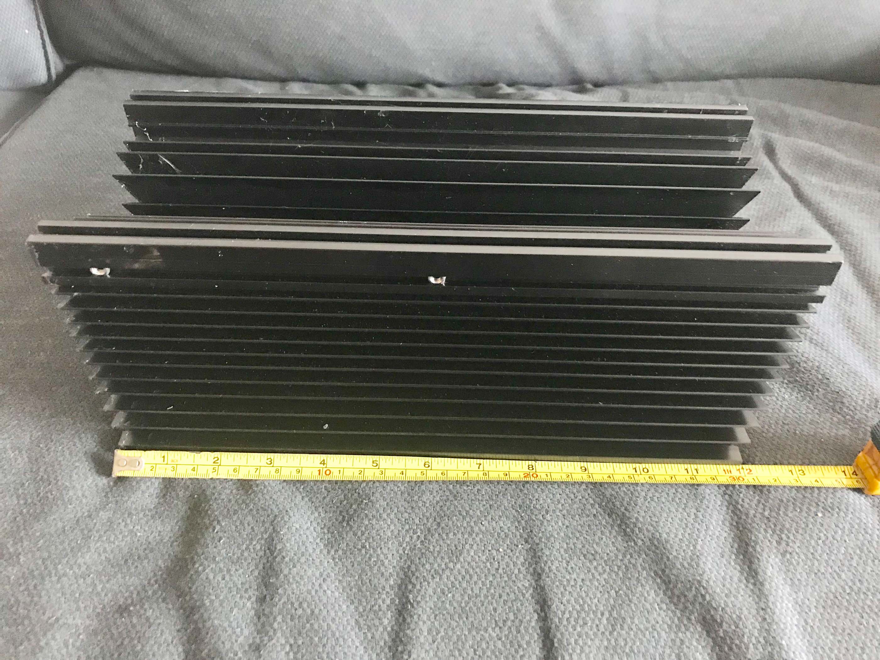

About heatsink, do you have, please, link to interesting products. I am looking for efficient and beautifull sculptural extrusion. I would like to build attractive design.

..I would like to use the best of it and I am feeling a little bit lost concerning resistors ( too many reference, different temp. coefficient, etc)..
You do not find such high quality resistors in many commercial amplifiers
https://www.mouser.fr/datasheet/2/427/cmfmil-109690.pdf
Vishay Dale RN60 or RN65 or CMF , RL cost more..

This Vishay Dale resistor has great audio quality / specifications / price ratio.
It's easy to spend money on more exotic boutique resistors like non inductive Mills wirewound, Tantalum,Z-bulk foil etc.
but You need experiment by yourself and find conclusion is worth or not.

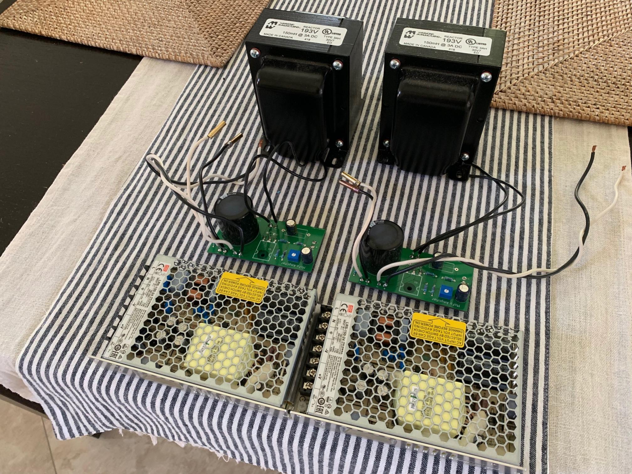

If anyone is interested in building one i have this laying around.
2x Hammond 193v
2x Meanwell PS
2x Build PCB (mosfet on the backside)
Shoot me a PM with a offer. US only please

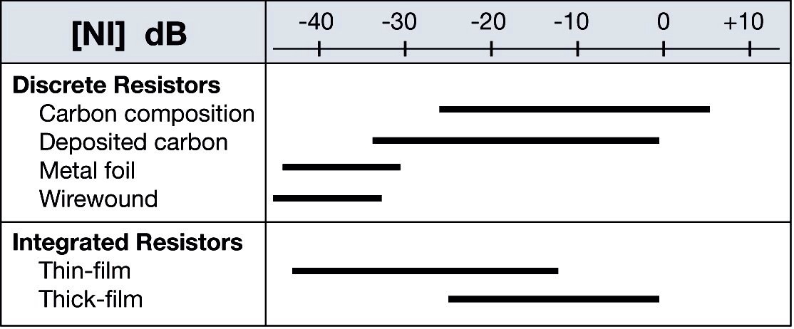

Some very very good wirewounds are Vishay Dale NS series. NiCr Ayrton Perry non inductive for the input. I tested them on my modified 30w Hiraga, and they sounded a bit cleaner thand the RN series to my ear.I didn't know wire-wound resistors were that good. Thanks.
