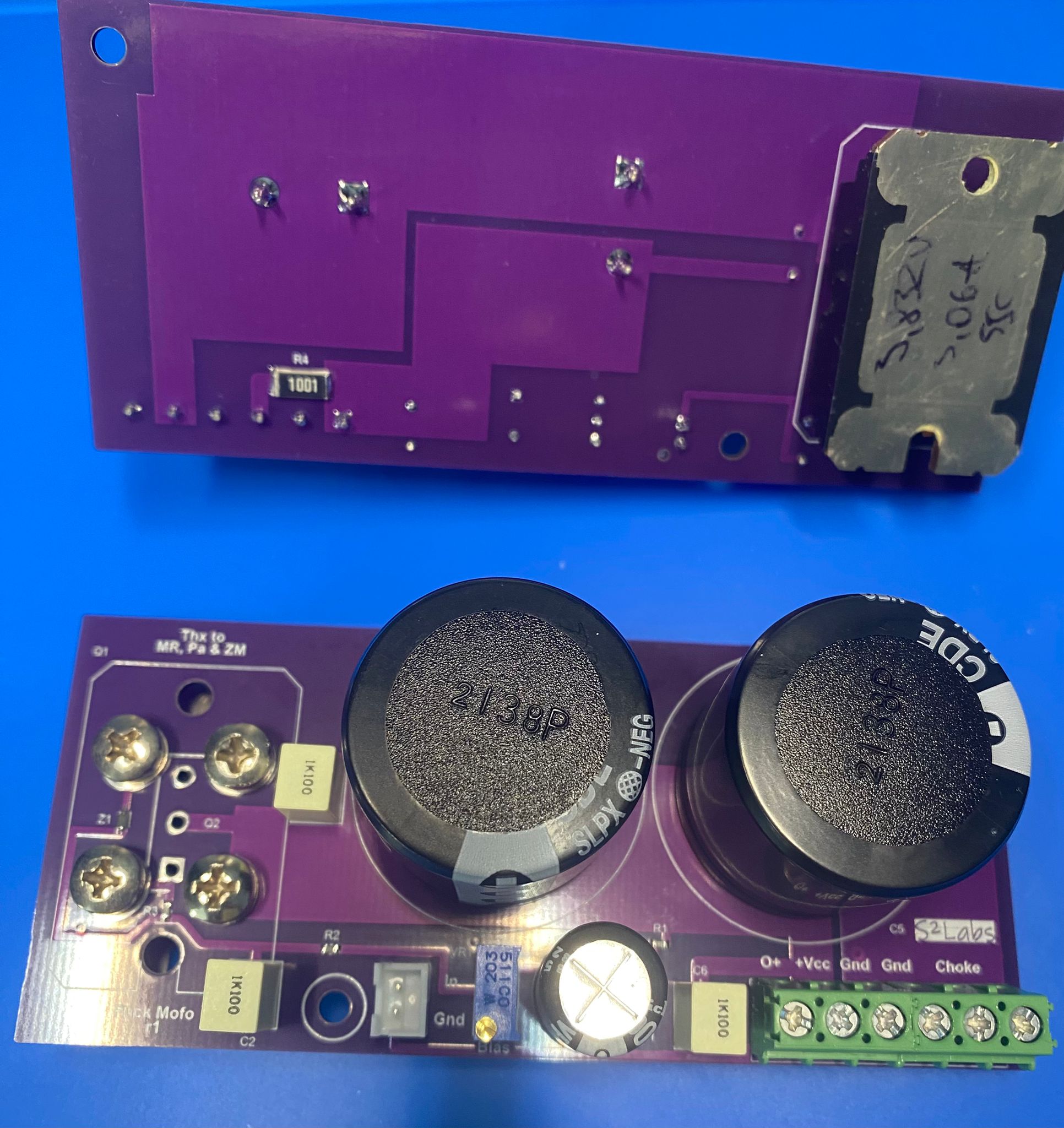

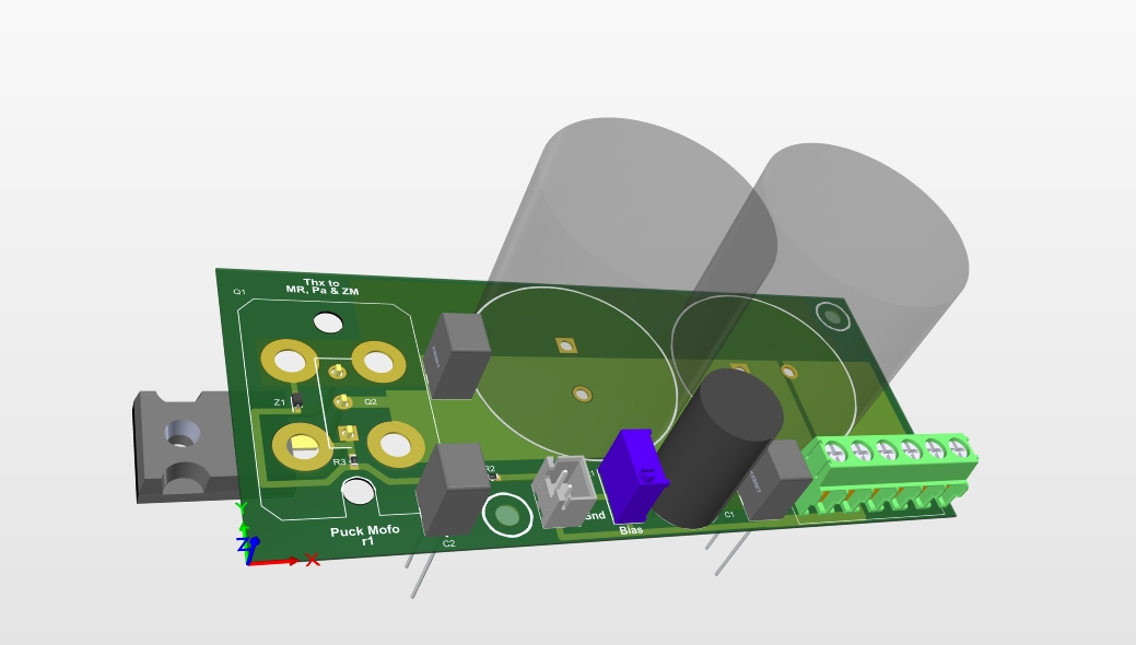

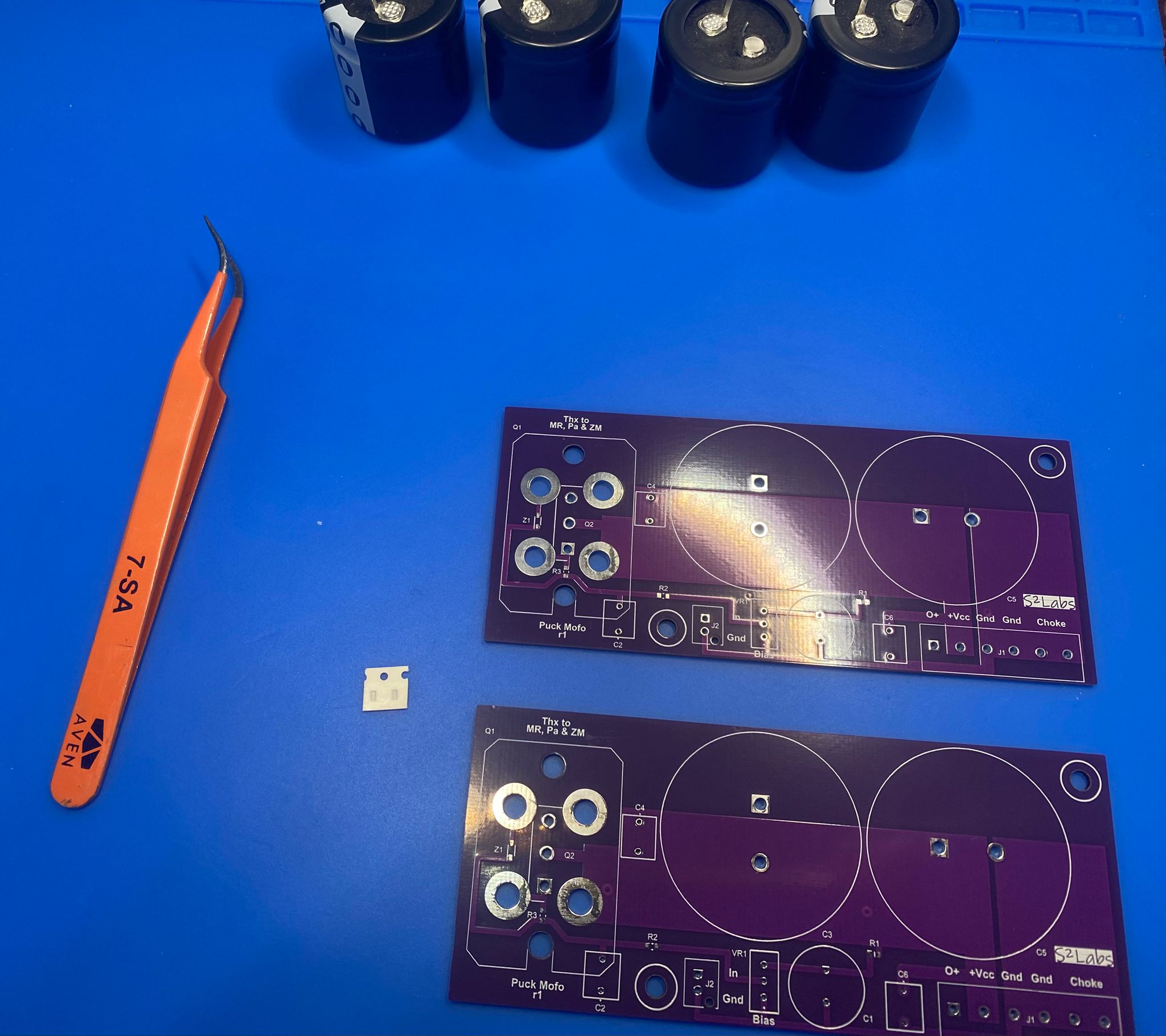

I have two board sets (2 each for stereo) that I'm happy to give away no cost. I ordered extras when I had them produced. I'd like them to go to two different people, ideally anyone who is on a tight budget (but then, how would I check?). I'll even cover shipping provided it isn't too expensive. Please PM me, don't post here. I'm saving two more sets for my kids in case they want to try it out. Those may become available eventually if they aren't interested.
