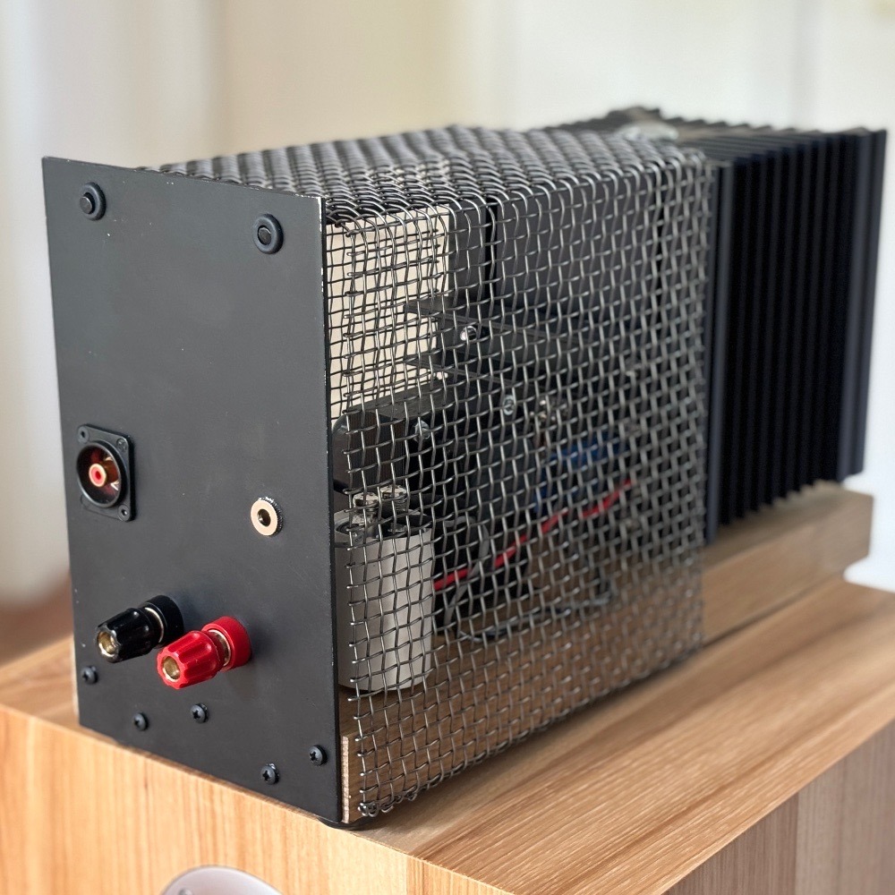

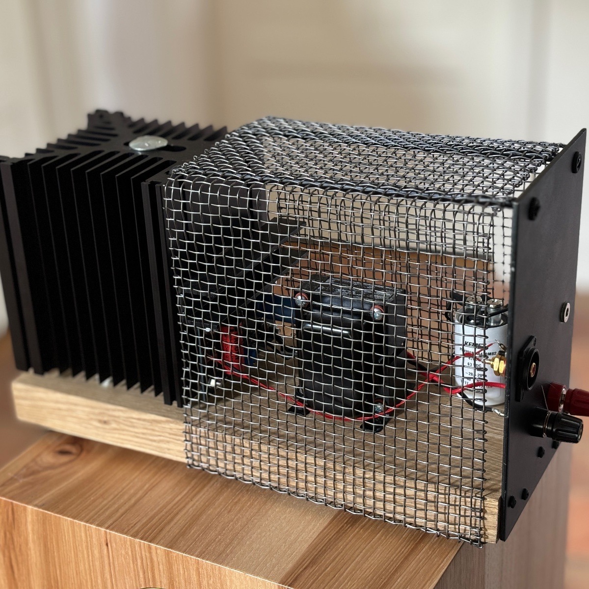

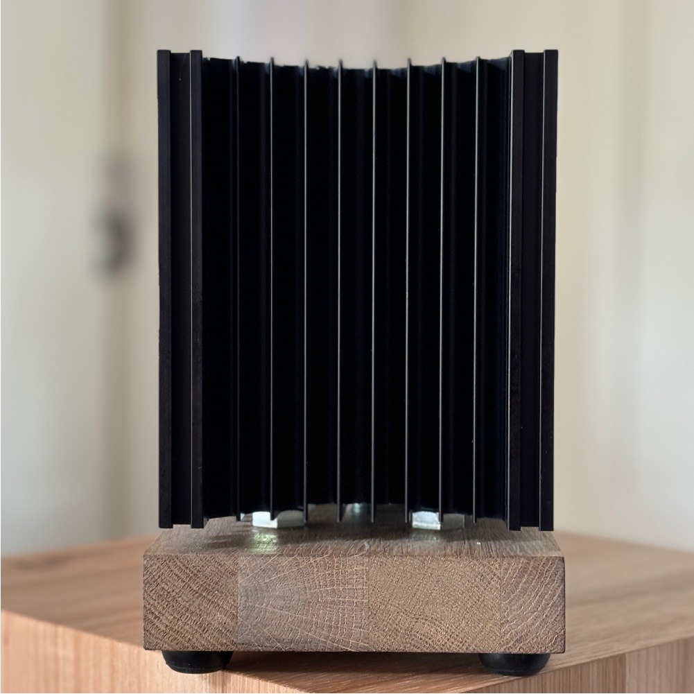

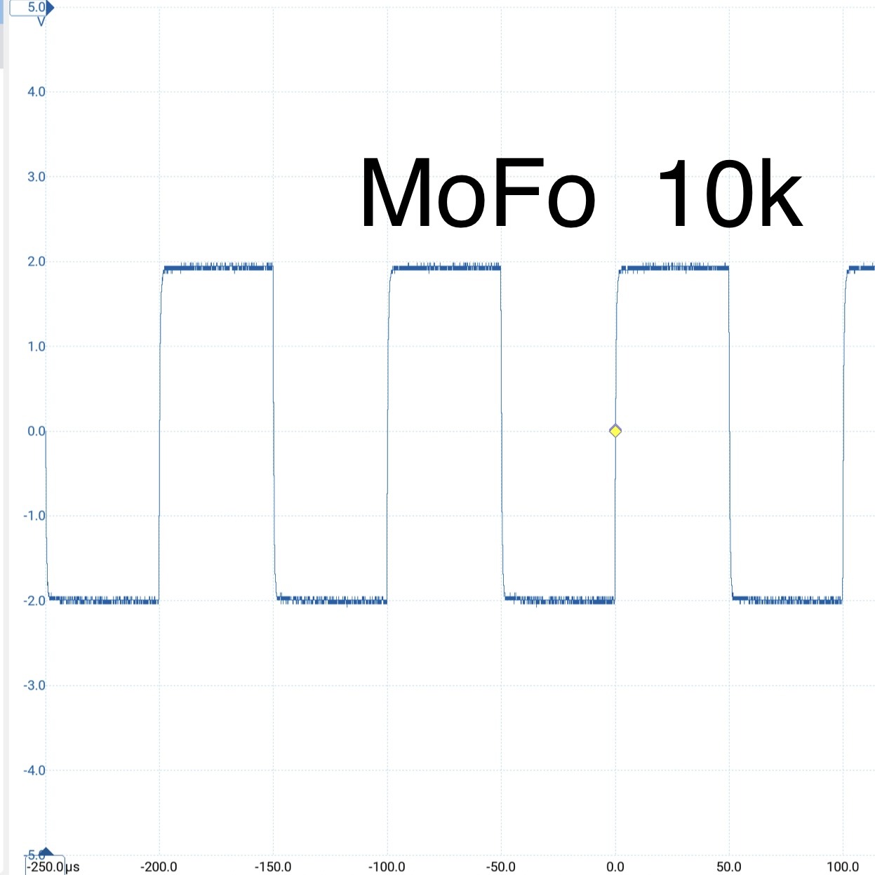

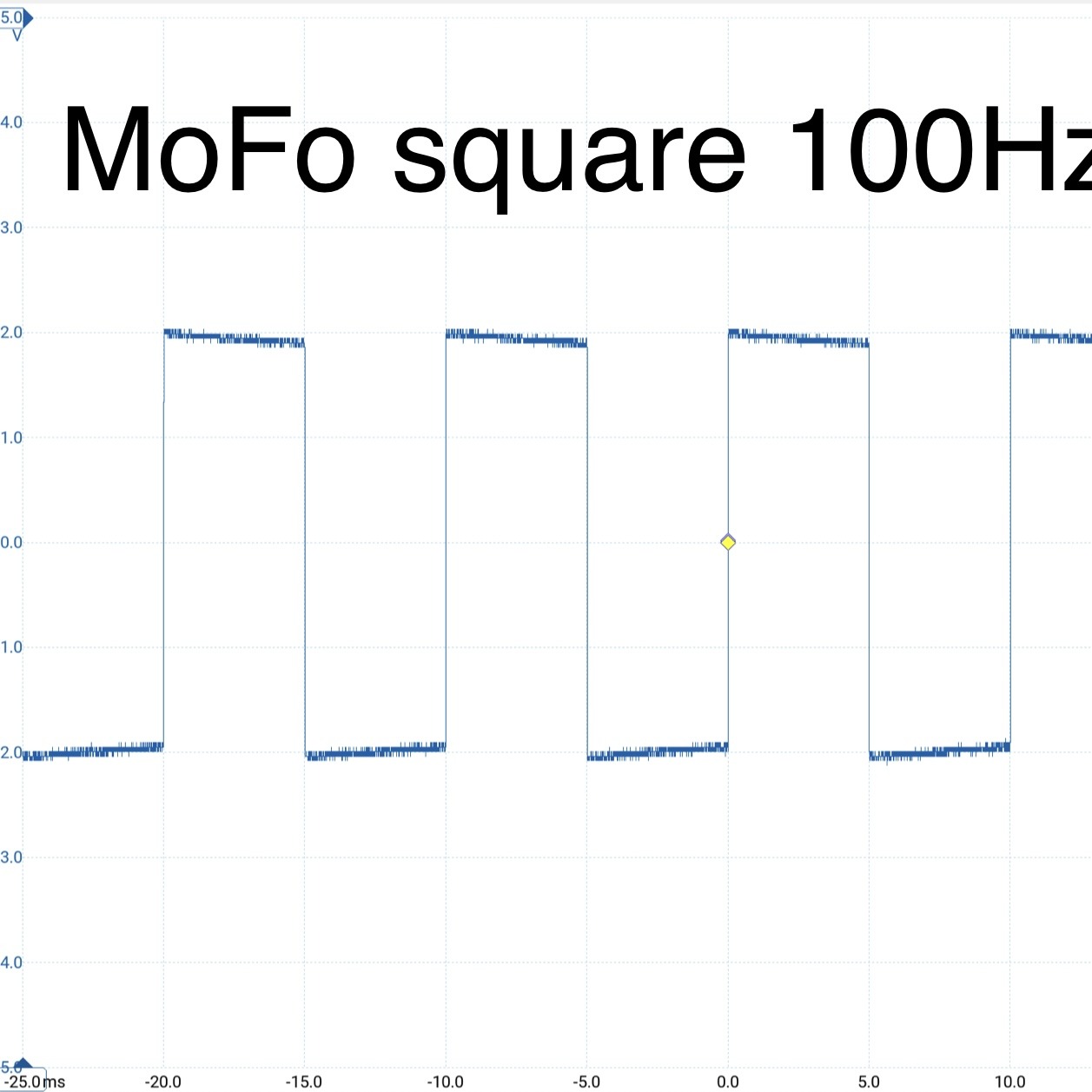

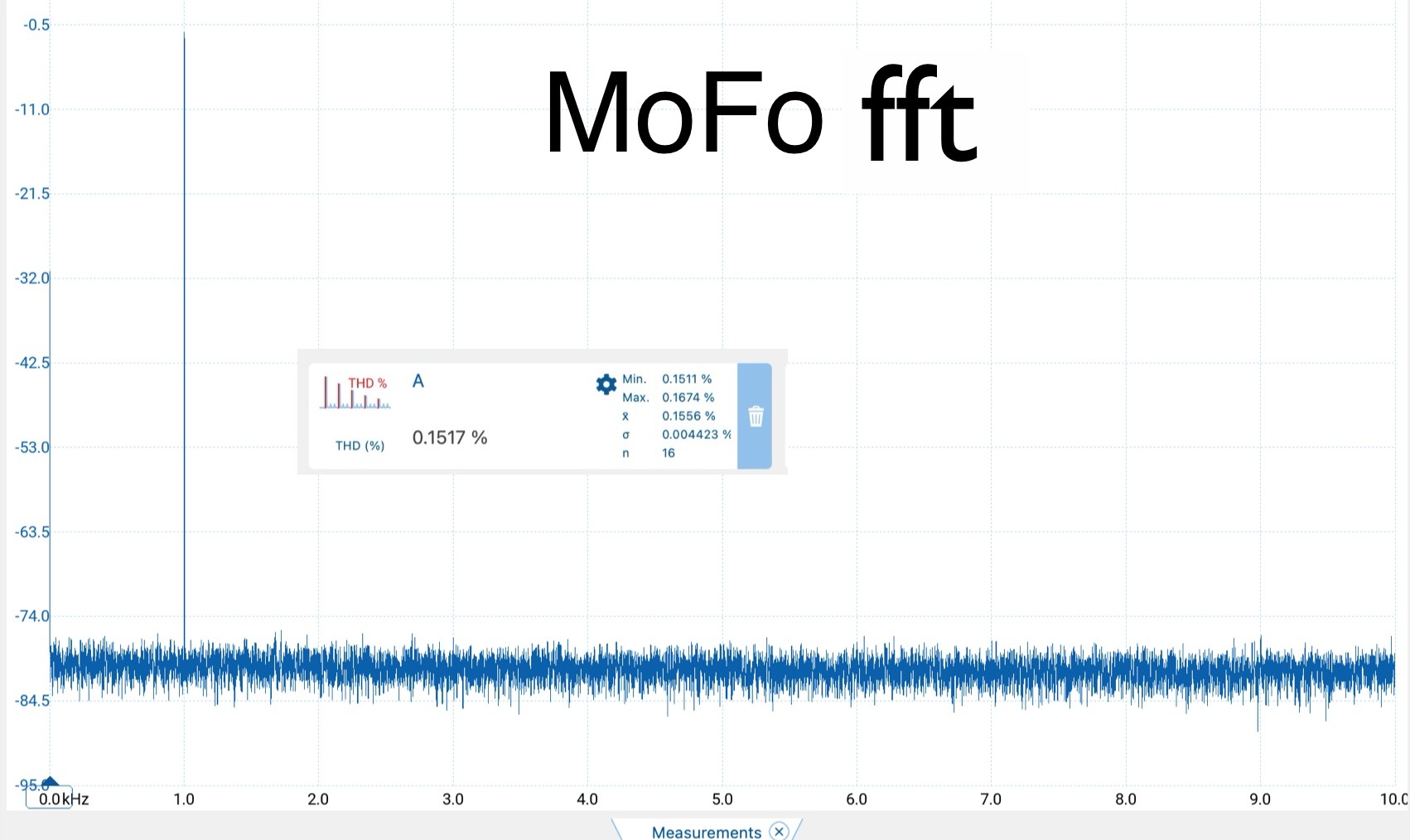

Thank you, Michael, for a very learning and enjoyable building project and thanks to all contributors. I made mine to a tribute to the original design, plus a cat fence. They sounded better than I hoped, really nice. My PC oscilloscope can’t measure better than 0.15% and have a lot of inbound noise but got some decent square waves, without load. I hope to battle my way through REW settings and get some nice loaded fft’s but haven’t succeeded yet. The sound is not as precise compared to other followers but laid back, not offensive and enjoyable. You can have really short speaker cables with mono blocks. 🙂
I messed up one pcb at output. I had to reroute. Is new pcb prepared for cables or screw socket?
How much gain can 193T handle, papers say 2A? I have biased them to 1A75. Heat sink is moderate warm after hours. Maybe a step up in inductor … hmm.
Pre: Turtle Iron Pumpkin strapped at 6 dB gain
Alt pre: FE2022 gain ~7 dB as gain stage
Speaker: medium size 95 dB, 38 - 22k Hz
nicely done sov! how are you powering it? I'm looking into building one myself. Have you checked out Arta for FFT? its free and easy to use (https://artalabs.hr/)
