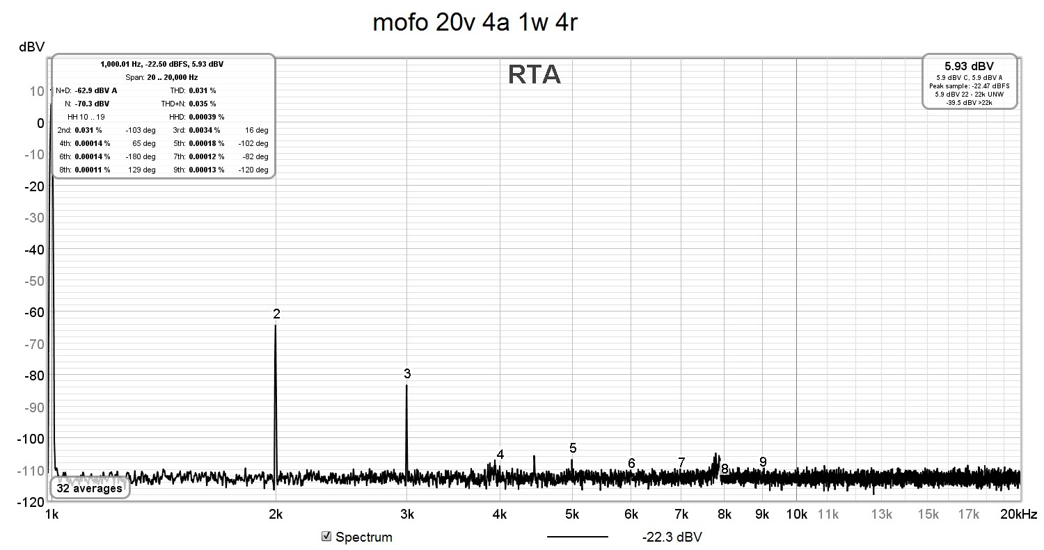

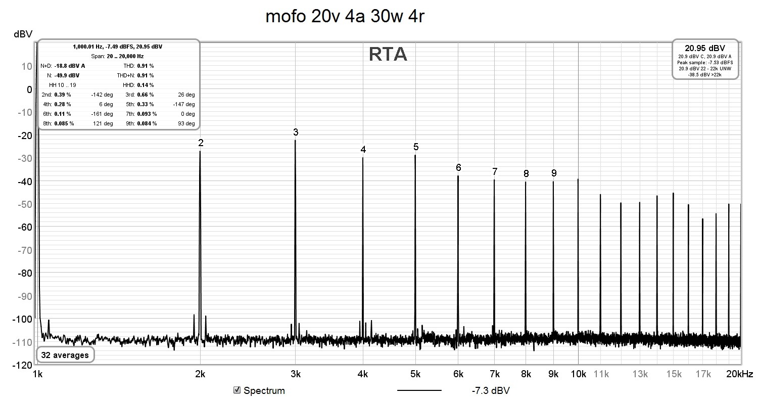

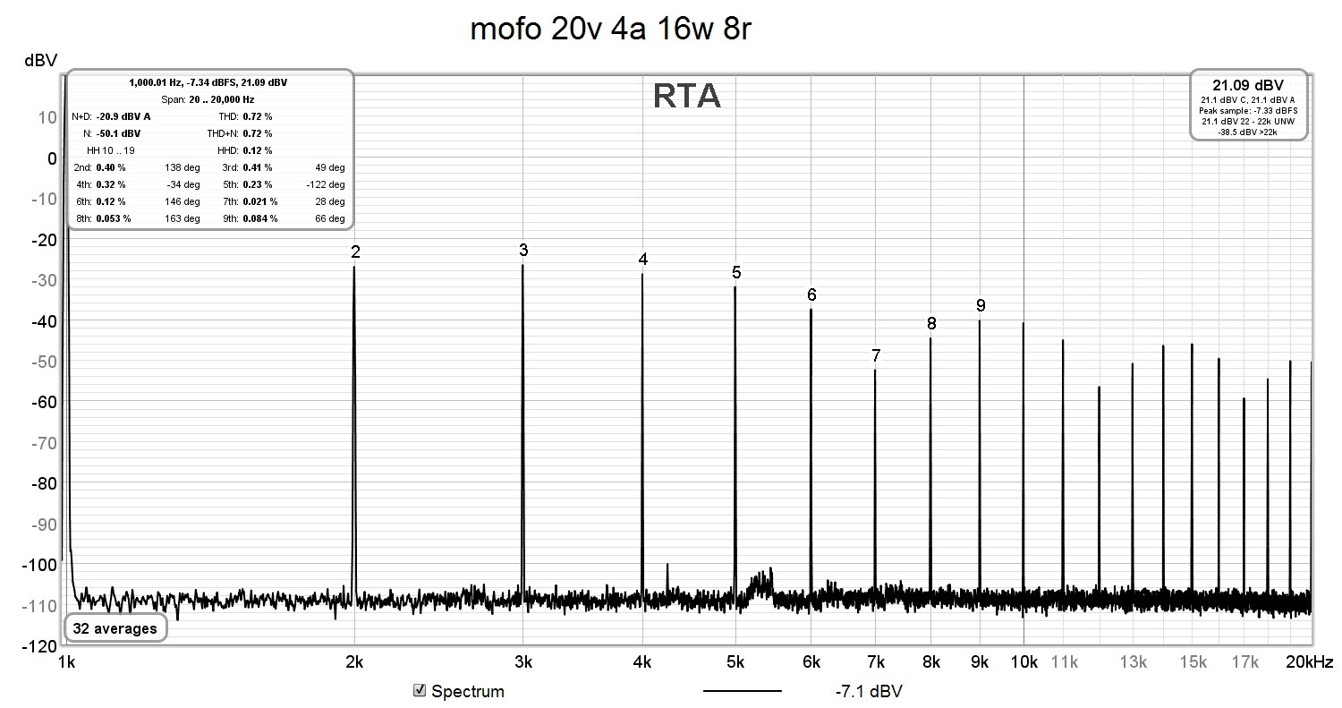

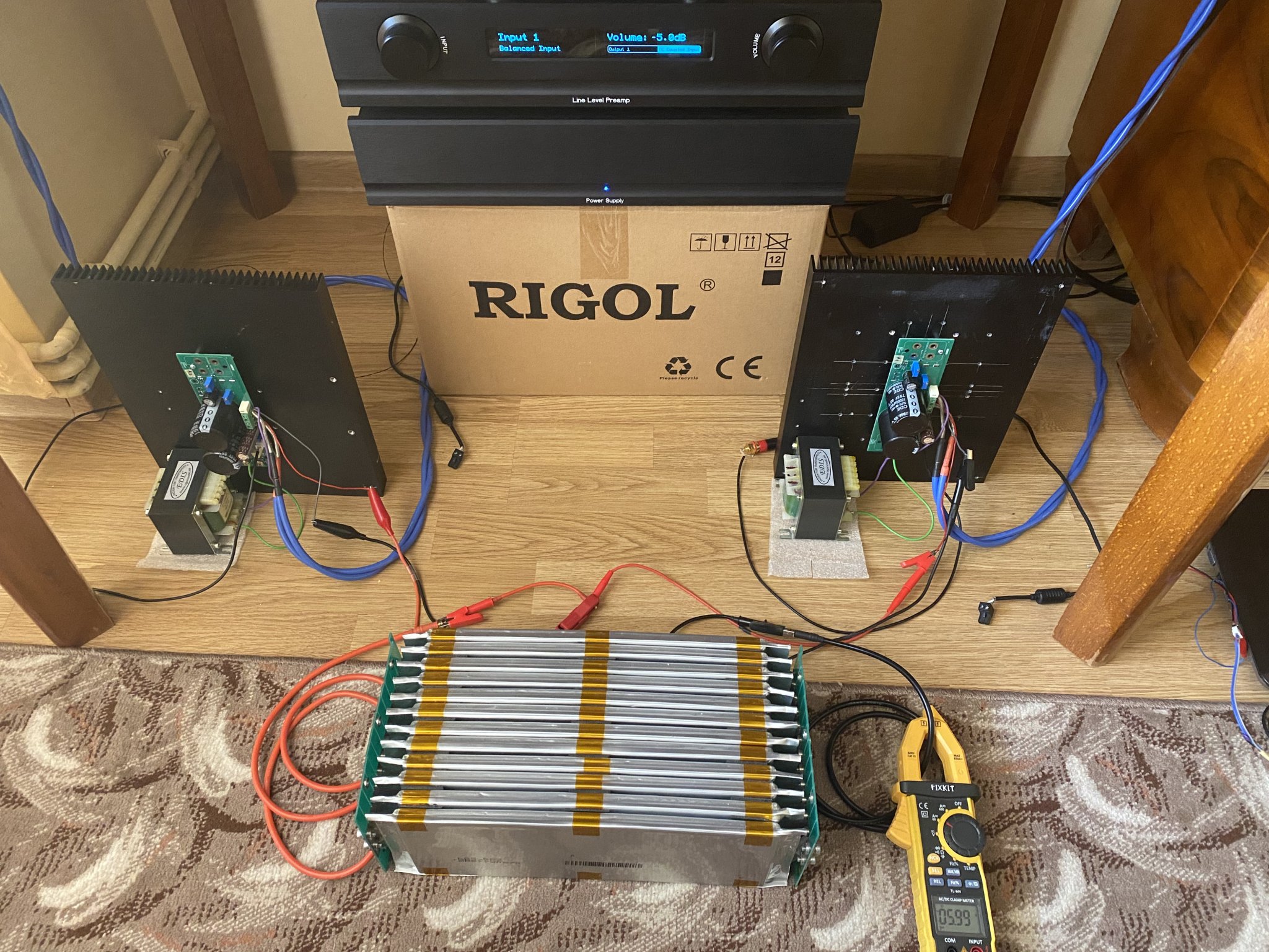

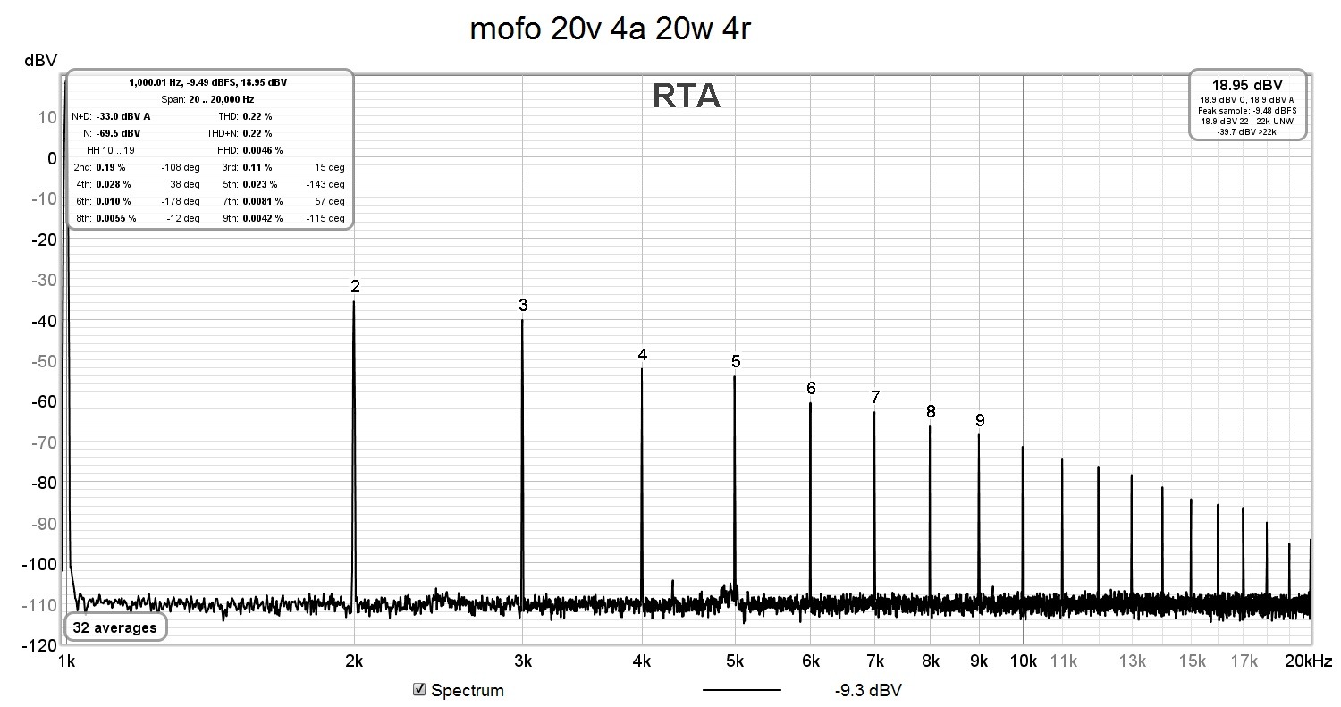

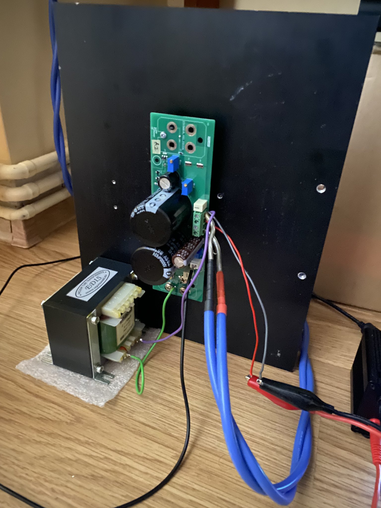

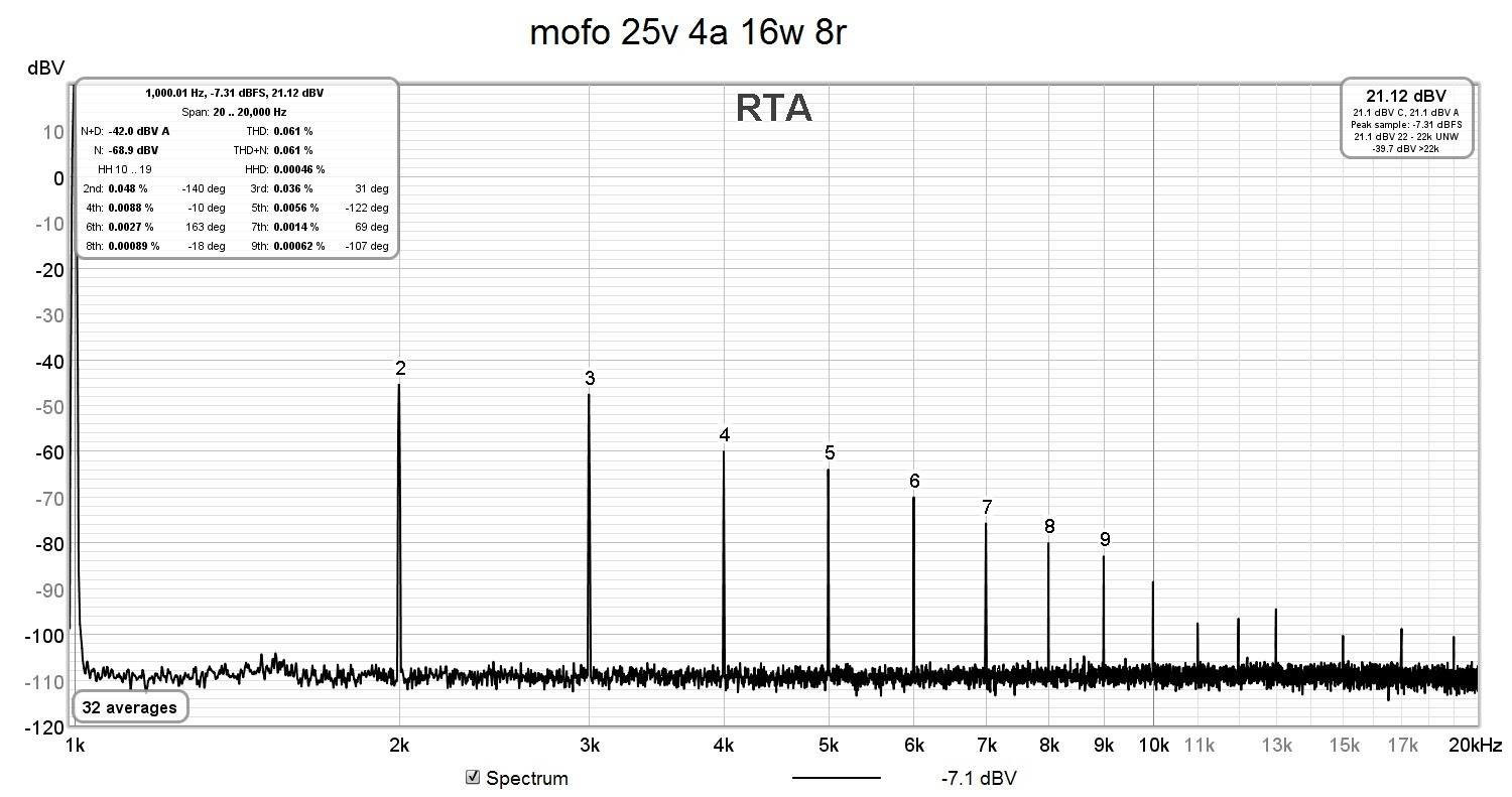

Seems the pucks can sing in the mofo too.. I can say that they do it nicely with a big touch of warmth from the generated heat.
