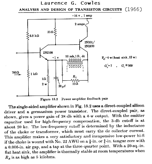

In theory, there is nothing stopping you from making a choke loaded bipolar follower.Would it be possible to build a Mofo With Npn transistors?
The things you need to solve are:
Bias circuitry.
Potentially lower input impedance.
Start a thread with your Idea. sounds fun.
HTH
Would it be possible to build a Mofo With Npn transistors? A Bifo?..
Here's choke-loaded bipolar from 1966. As DougL hints, it wants a second stage to get a decent but still-low input impedance (and there must be an input cap). The way the NFB works, it is more current source than voltage source (low damping); but some folks like that too. This form does have decent voltage-gain (~~1Vrms in for full output). You could do NPN Darlington and get voltage-source and maybe 5k Zin but need 10Vrms drive.

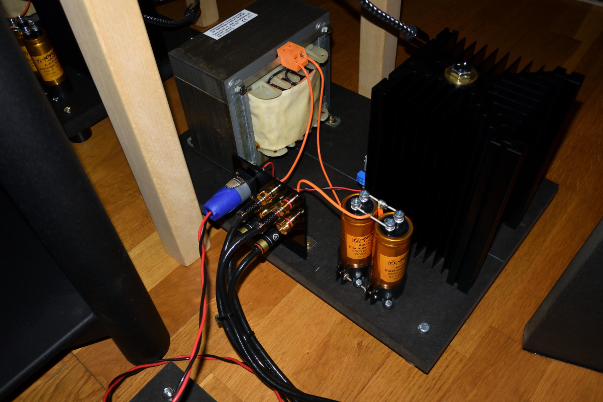

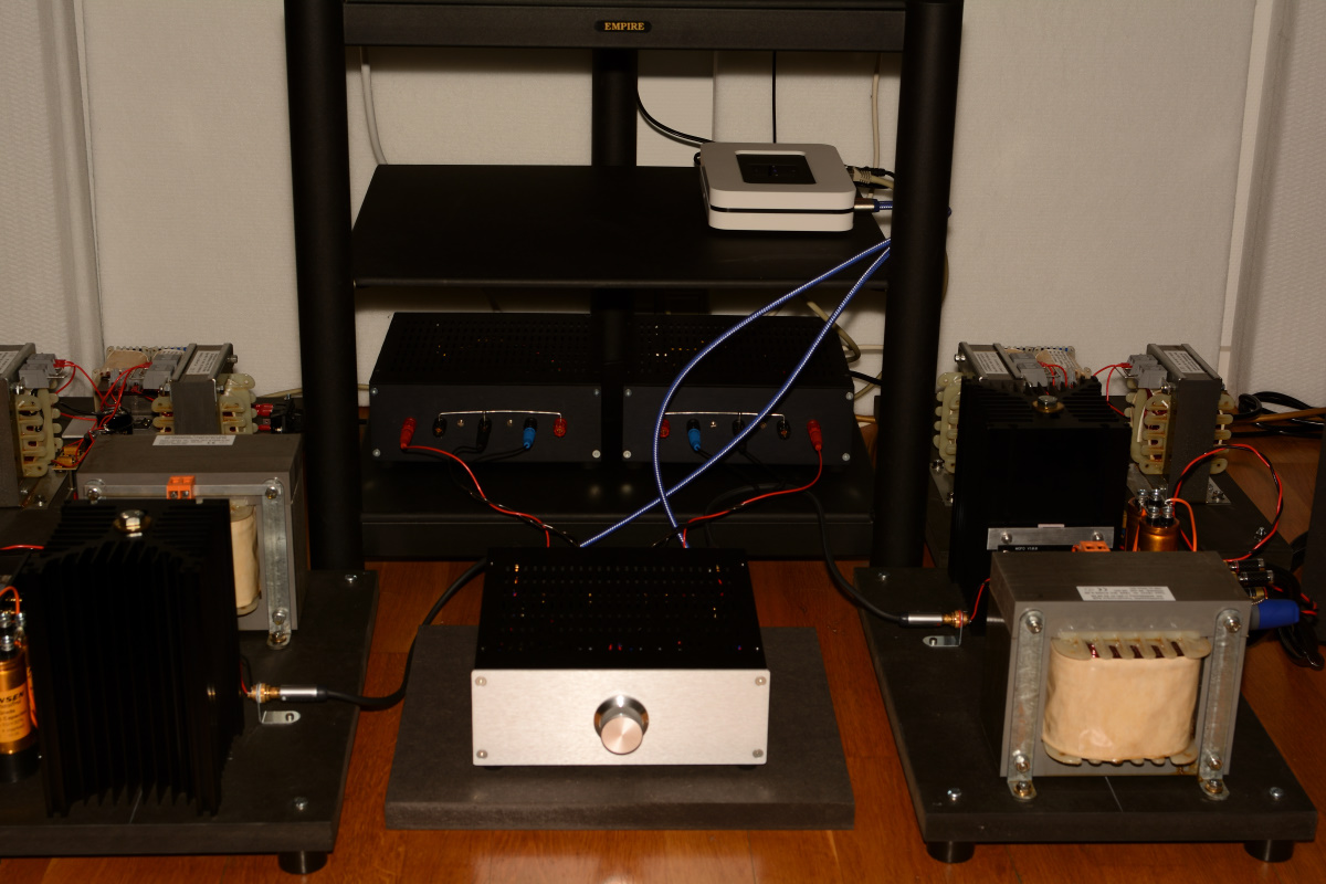

I am very happy with my MoFo's. I use Jensen audio grade caps. 2x6800 uF parallel. 5 Hz in 8 ohm was no problem. Caps are not cheap. About 100 USD each. ESR very low. About 7 mOhm as far as I remember (probably for the parallel pair). The impedance stay < 10 mOhm up to 100.000 KHz. Probably the reason they call it "audio grade". Caps has low inductance.
Thank you! ….I am now using M2X amps. It was my intention with MoFo to try to short the output caps as with 3A bias and 73 mOhm choke DC is about 0.2 V which the 4" voice coil in the woofer can handle. But I forgot to make that experiment. Now these MoFo's with PSU's takes up a lot of space!
Yes, around 20 kg each. The coil is 12.5 mm2 square wire. Should be able to handle 28 Amps of current. I was suggested from the transformer company a bigger option if I wanted to go down to around 35 mOhm DC resistance. It was an IU core type choke and weight was 55 kg. Then making MoFo without an output capacitor was a real option.....I think.
