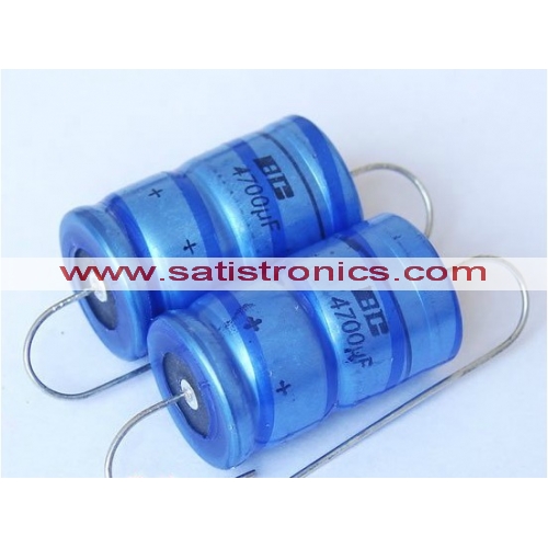

Try to use another type of blocking capacitor to see if that influences the sound. I like the Philips axial type, to me that was the best on the SEWA. Greetings

Now I gotta see if the output coupling caps (Nichicon KG Super Through) are to be replaced with something brighter/airier sounding. Any recommendations for e-caps with better highs? Gaborbela mentioned SEWA - can't find it here. I'll try a smaller cap too, perhaps 10,000UF is too much.

You should try other types of caps on the output.
To me, this type was far the best with SEWA, I tested several audiophile caps. Need a week or so to burn in and please pull off the plastic from the cap.

Take care Garbobela! Will try BC caps next.
