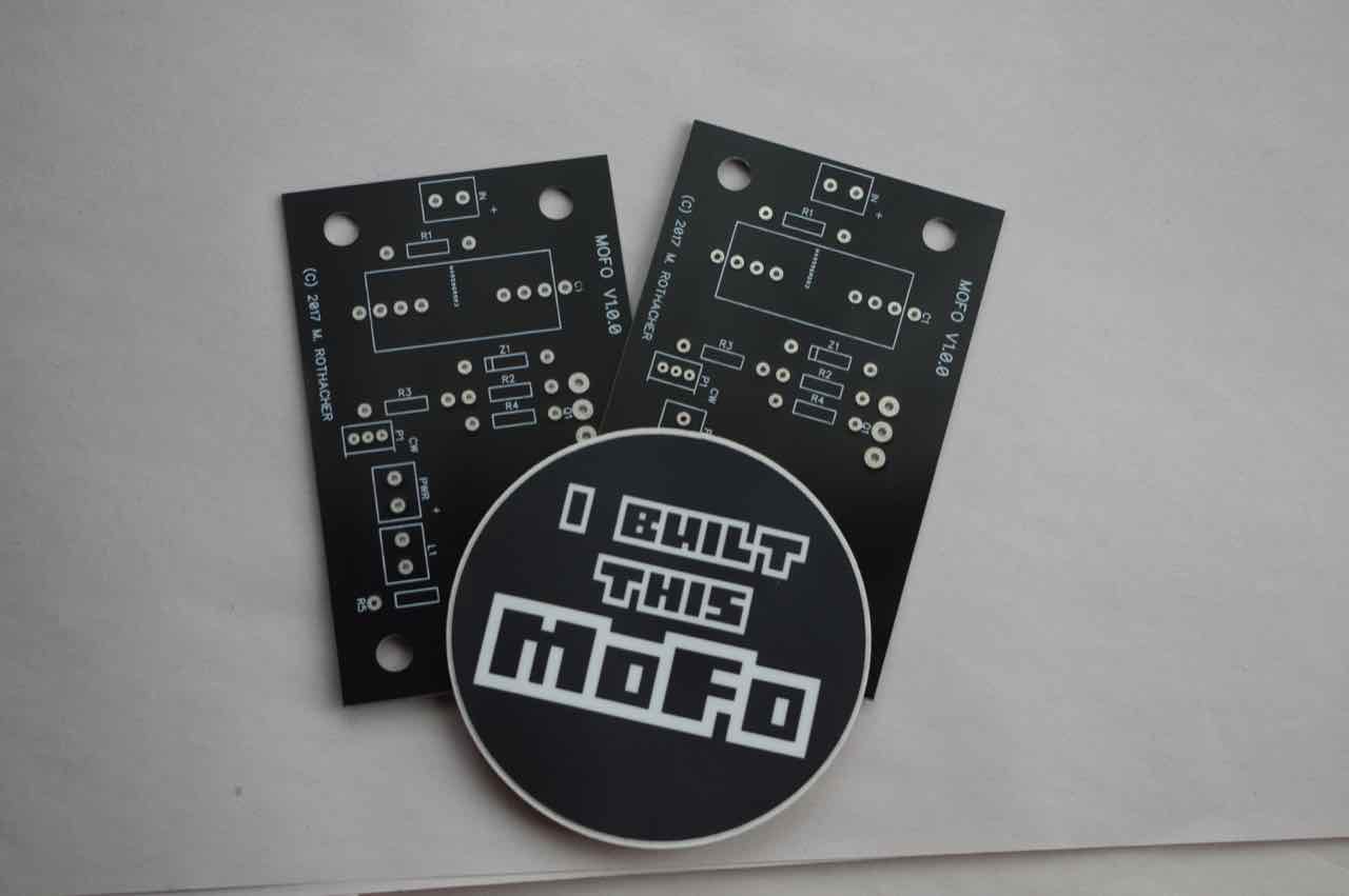

Hi all,
Anyone have a spare pair of PCB’s for the MOFO? Been looking to build a pair but the DIY store is out of stock and has been for some time….
Not looking for freebies, just looking for boards!
Thanks Dave
Thanks Dave
Dave I have a spare set of boards including the MoFo sticker.
Steve.
How much would be to ship to Toronto?

gaborbela,
Sorry I only had the 1 spare set of boards and they are on their way to nzlowie.(Dave)
Steve.
Steve.
gaborbela,
Steve.
