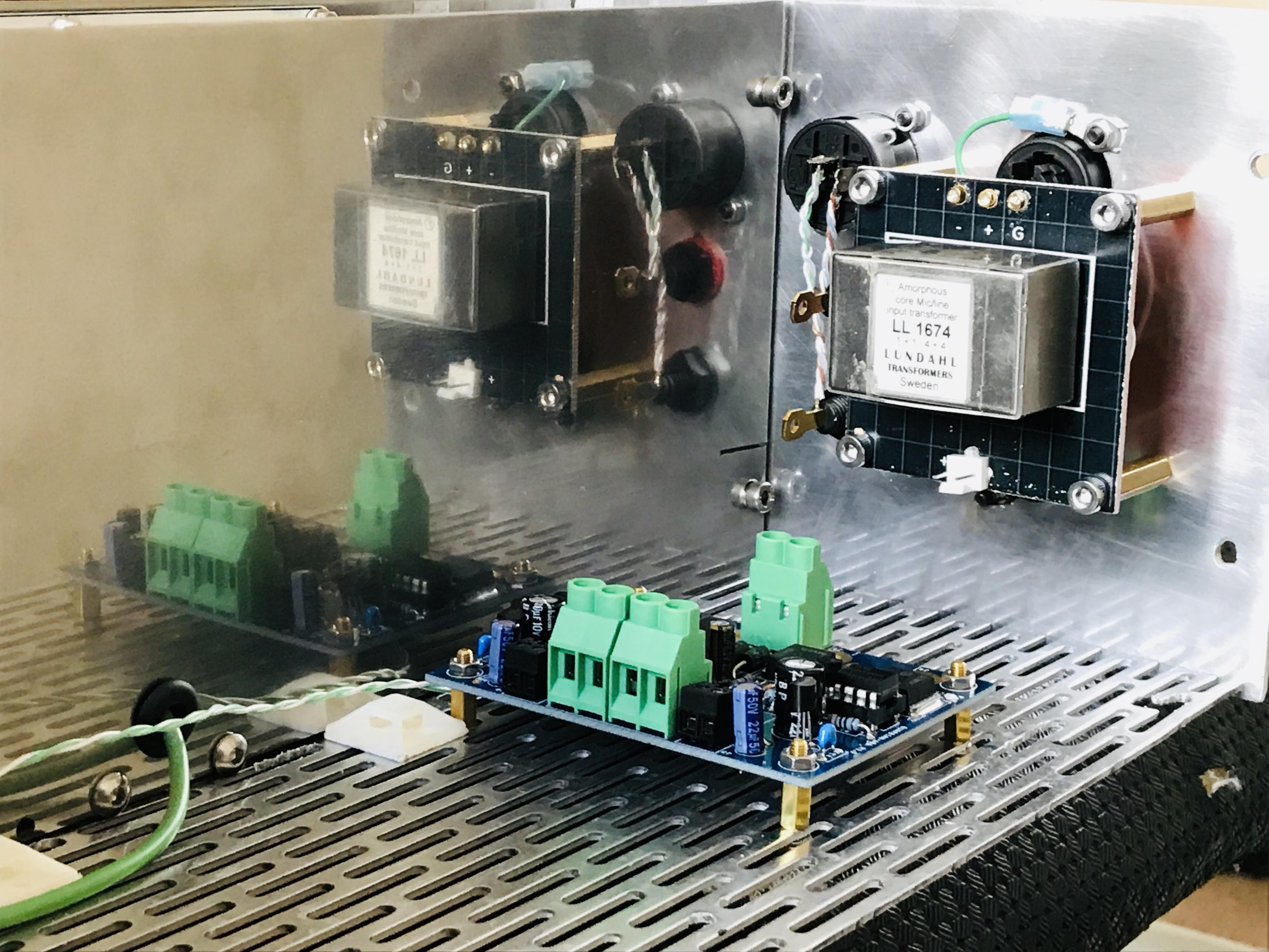

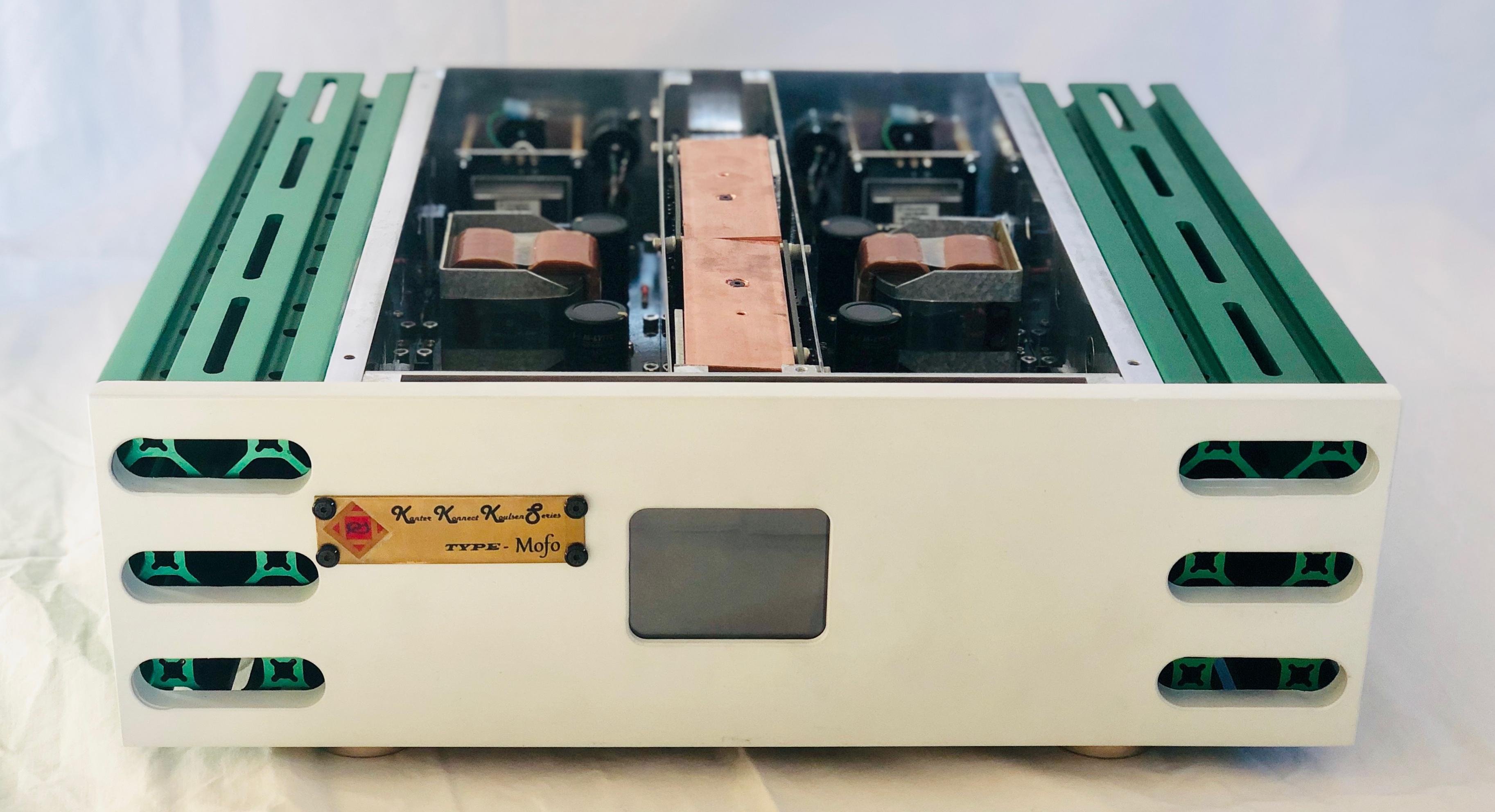

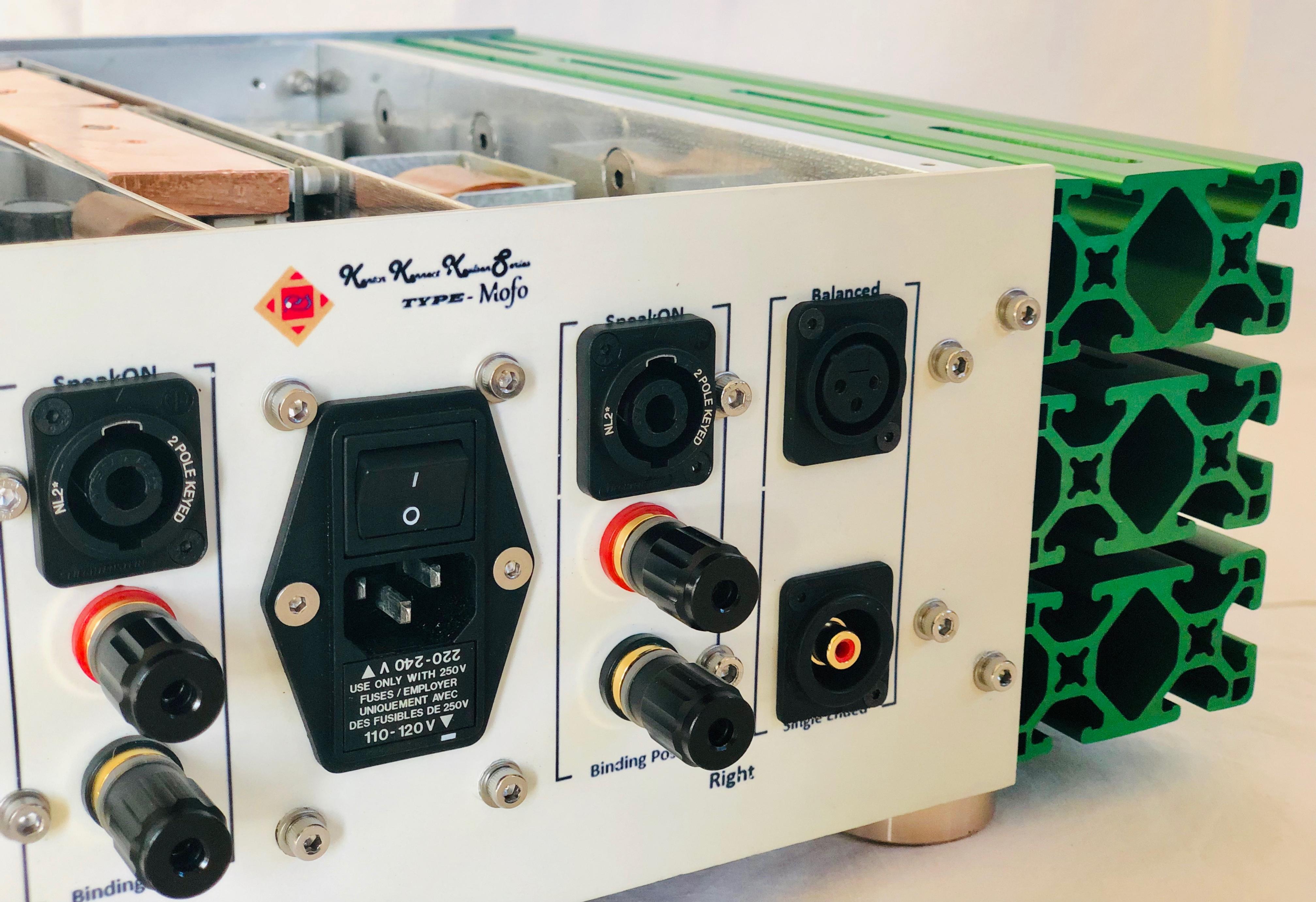

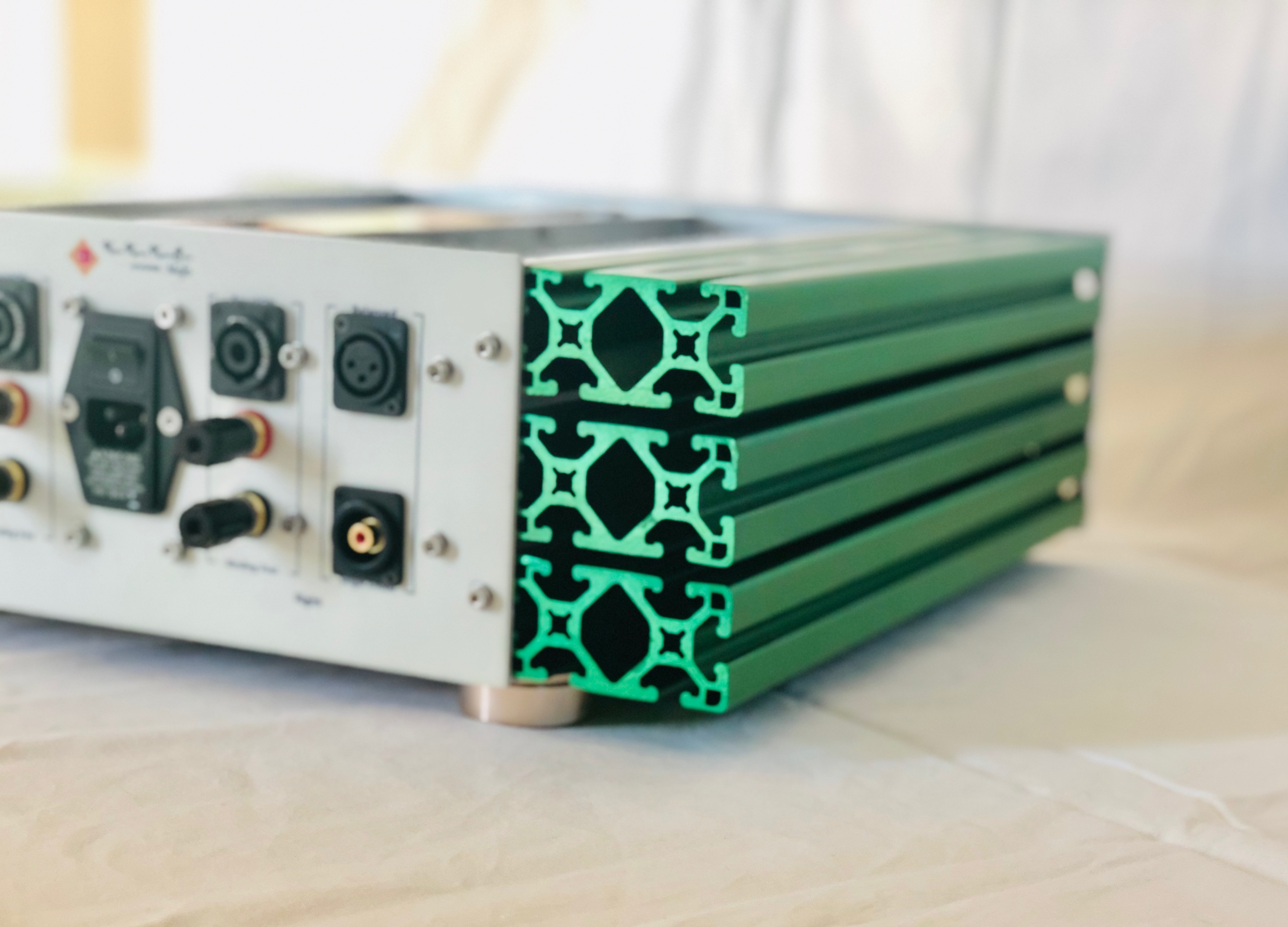

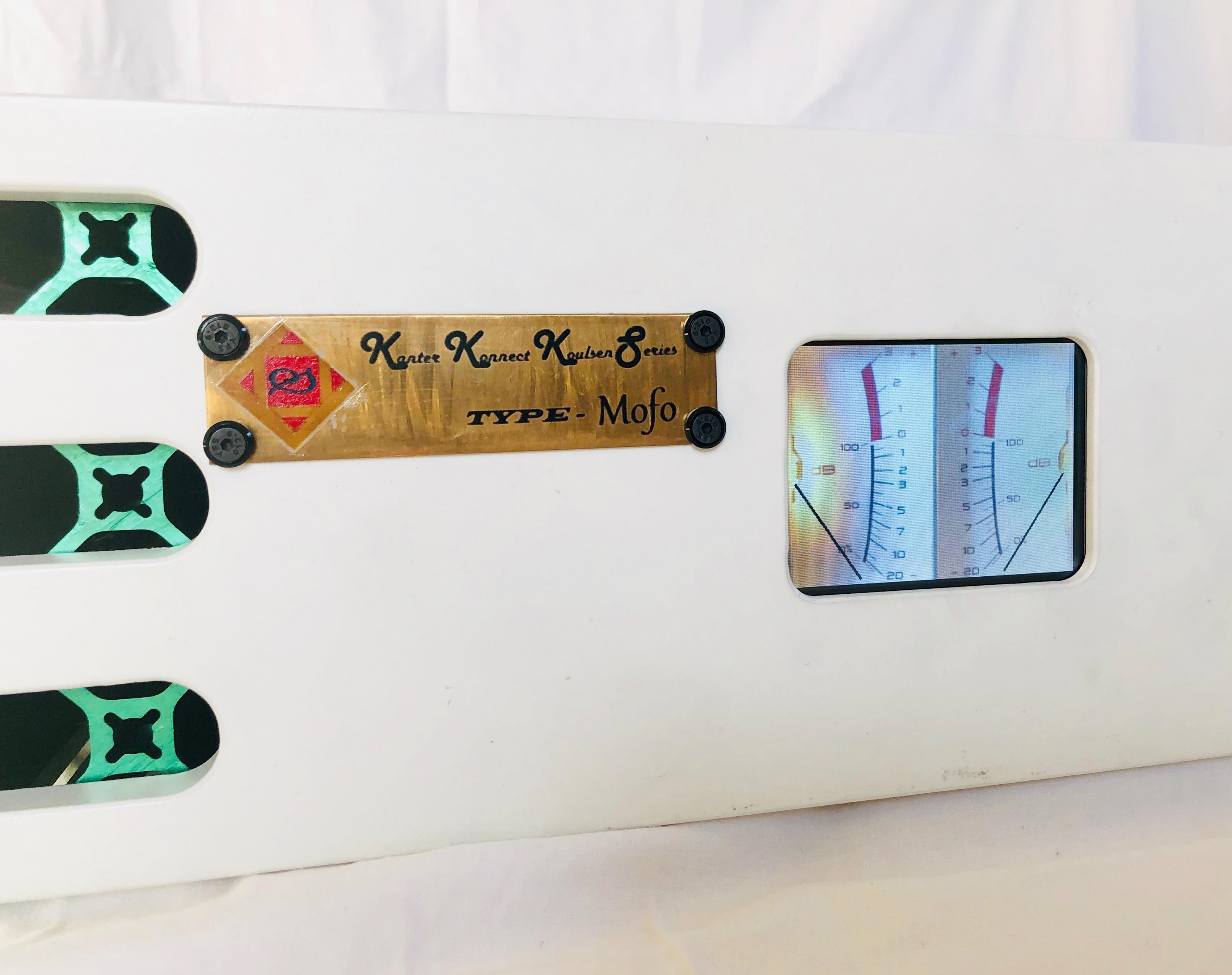

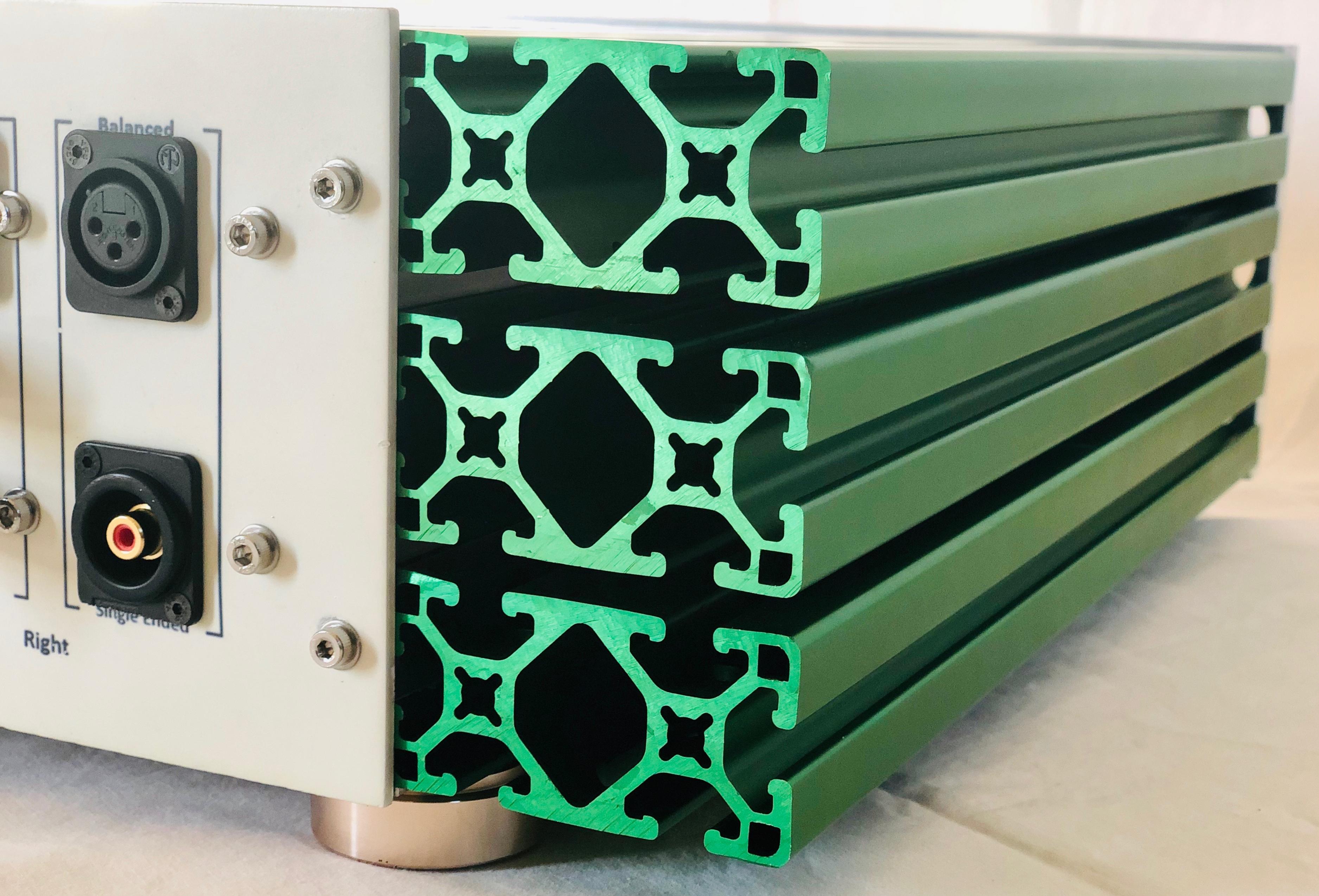

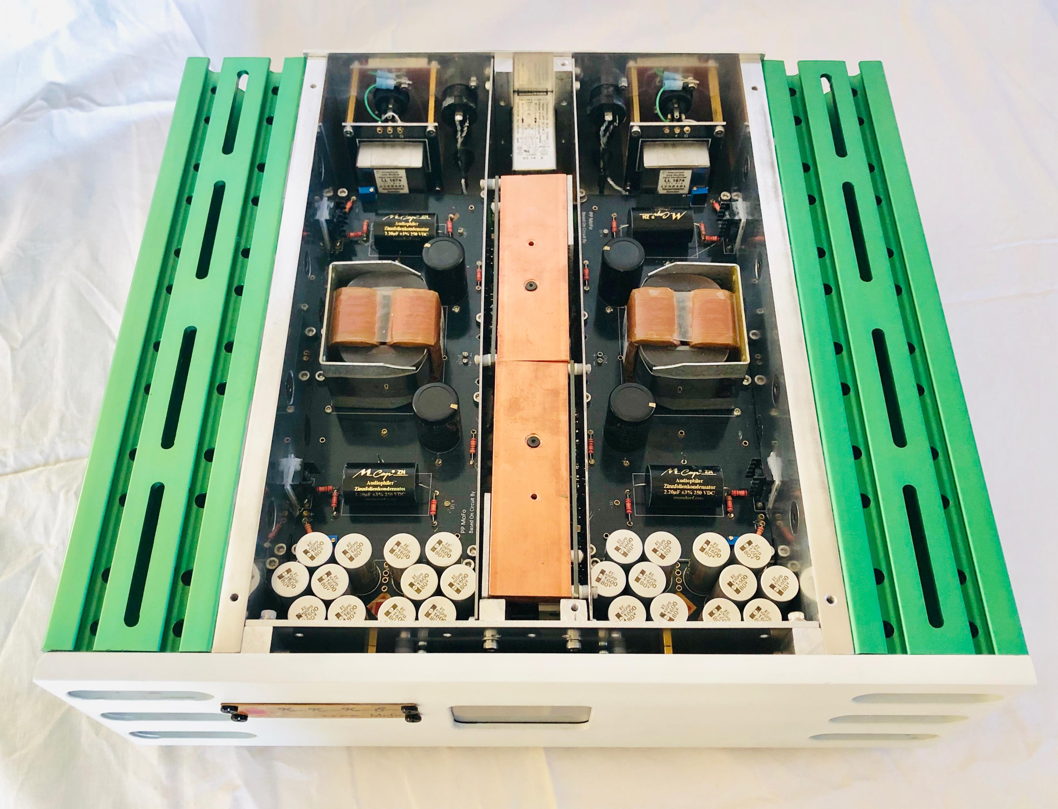

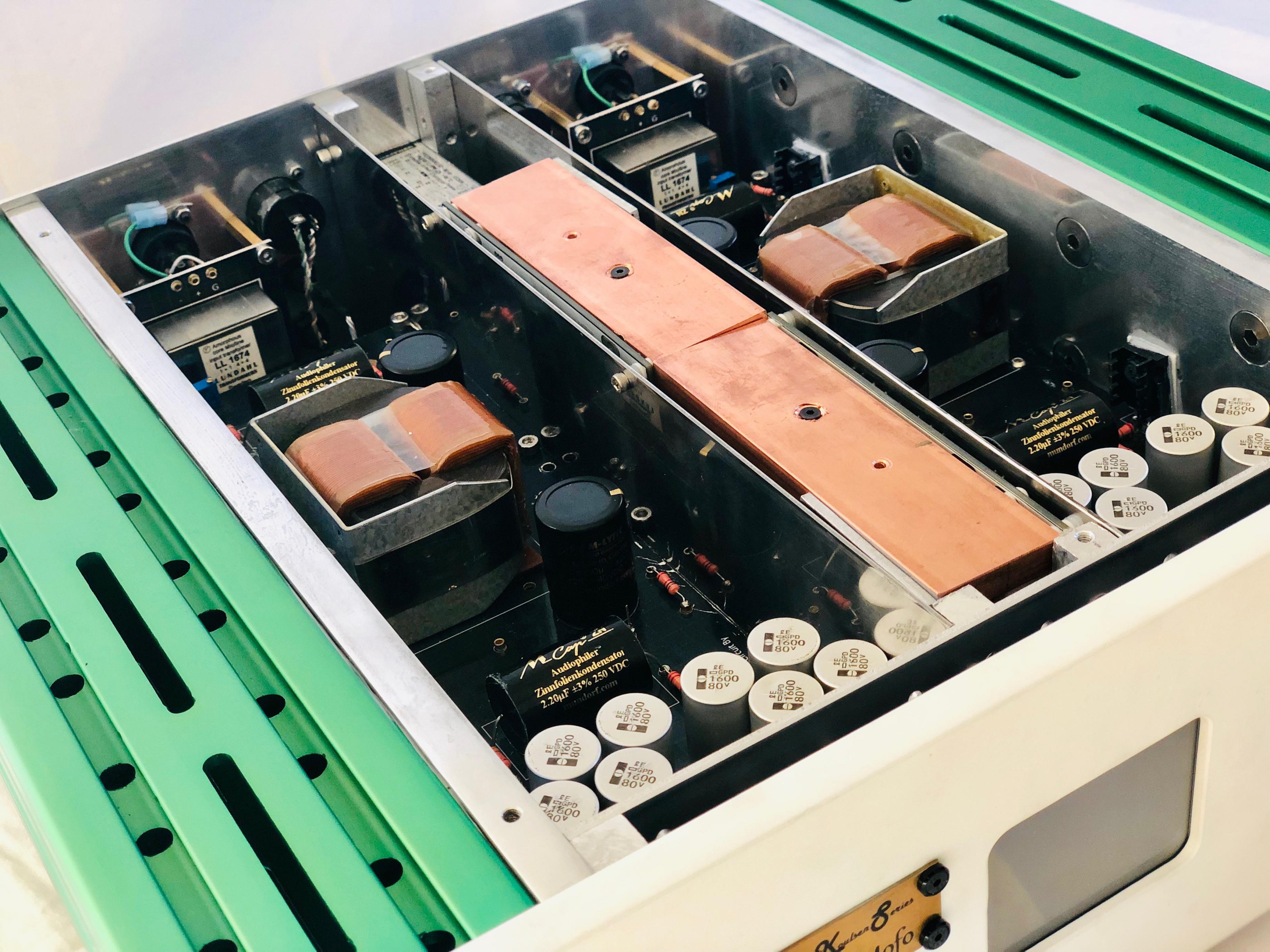

This MoFo is done! Well, almost. I’m using two SMPS600 from Microaudio. I highly recommend them due to Sami’s unending customer support! I’m also using Lundahl LL1674 in the 1:4 mode. This allows me to use the Bruno Pultzey’s balanced preamp to decent volumes. I’m using two Guardian 86 from Neurochrome. It uses mosfets for DC protection. I have only listened to it for about an hour this morning but I can already tell it will sound special! Very clear and detailed. I’m listening to Till I hear You Sing from Love Never Dies and I could not help but increase the volume at 0630 AM on a Saturday at the risk of waking up the whole family!
Ambient temperature is at 21 c and the heat sinks rise to about 40 c biased at 1.7 amps. The SMPS do not have much air flow and get very hot! I have purchased 40mmx10mm fans from Noctua and see if that cools it down. Thank you MR for the circuit and all those who contribute to this forum!

This MoFo is done! Well, almost. I’m using two SMPS600 from Microaudio. I have only listened to it for about an hour this morning but I can already tell it will sound special! Very clear and detailed. I’m listening to Till I hear You Sing from Love Never Dies and I could not help but increase the volume at 0630 AM on a Saturday at the risk of waking up the whole family!
Fantastic MoFo Bvtrinh!!
Enjoy your new amplifier 😀
Thank you ZM! It is an honor to receive a compliment from you!
Thank you Vunce! I’m looking forward to your next build!
when something is so Wakoo looking , compliments must be given!
is that metal or plastic Faccia ?
just looking at these pics , I realized that greasy looking plastic Faccia of 10mm thickness could look awesome on preamps and amp cases ...... good to remember for few cases I have , without front plate .... sometimes is cheaper and can be even "just" more fun to do it differently
The whole case is made of aluminum. The front and rear panels were powder coated then sprayed with a chalk clear coat.

Very nice Bvtrinh. Congrats.
Why do you need a DC protection board on MoFo? It’s AC coupled via big electrolytic.
Thank you X!
Old habits of being overly careful. It also has a turn on delay and cuts off the speakers when the voltage falls below 15v.
Bao
