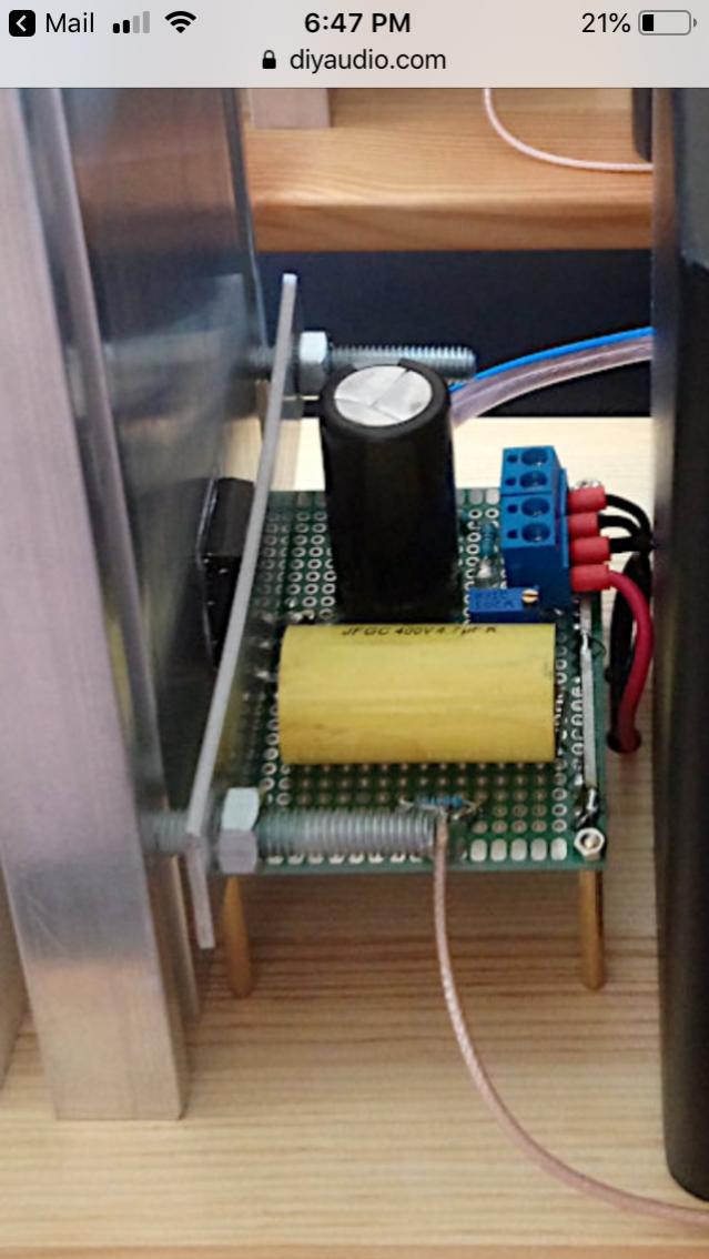

That’s amazing, you went from a MOSFET temp of 100 C down to 59 C by using a different aluminum thickness, good stuff. Below is a before pic showing a curve in the aluminum. Thanks for sharing.
Would be fun to see an updated pic.
BR
Eric
BR
Eric

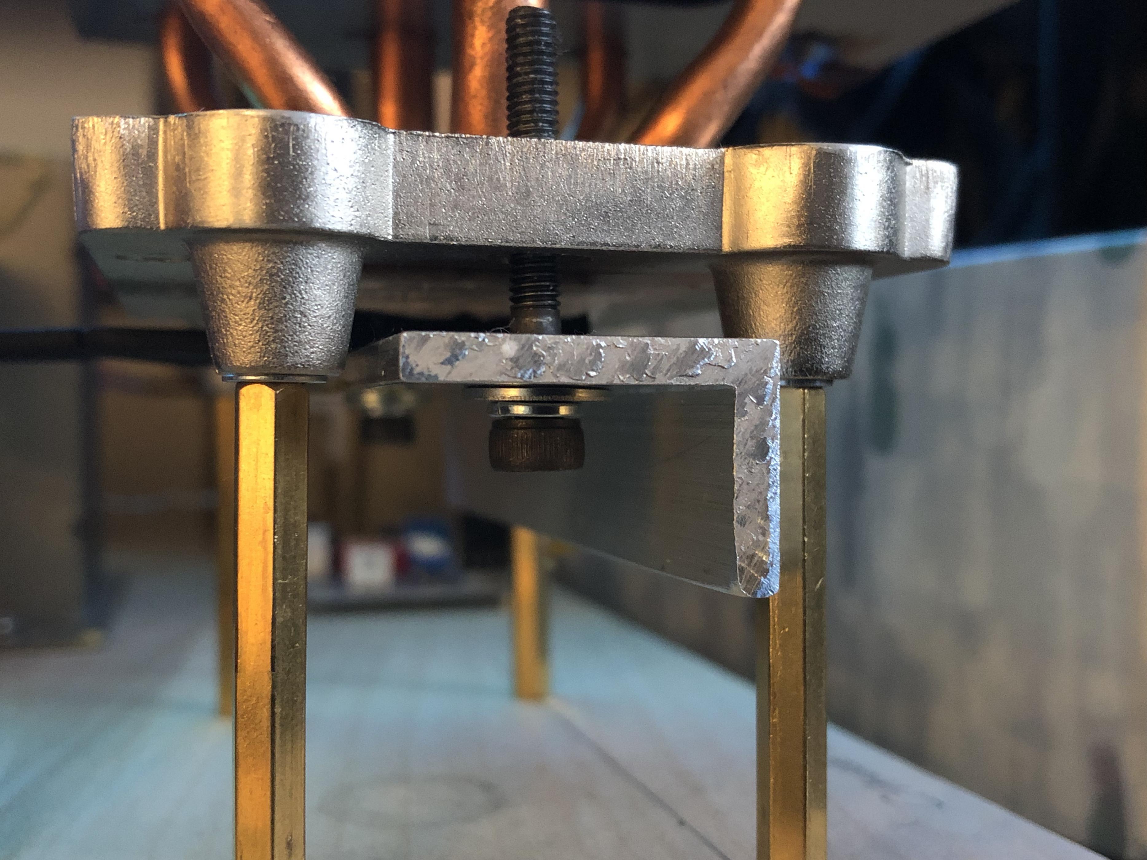

A good clamp is angled aluminum as used in mr. Rothacher's build, but I don't have this stuff at hand.
Yes, that's a better approach, but it won't fit in my configuration of heatsink-pcb, and I want the pcb to stay horizontal.
