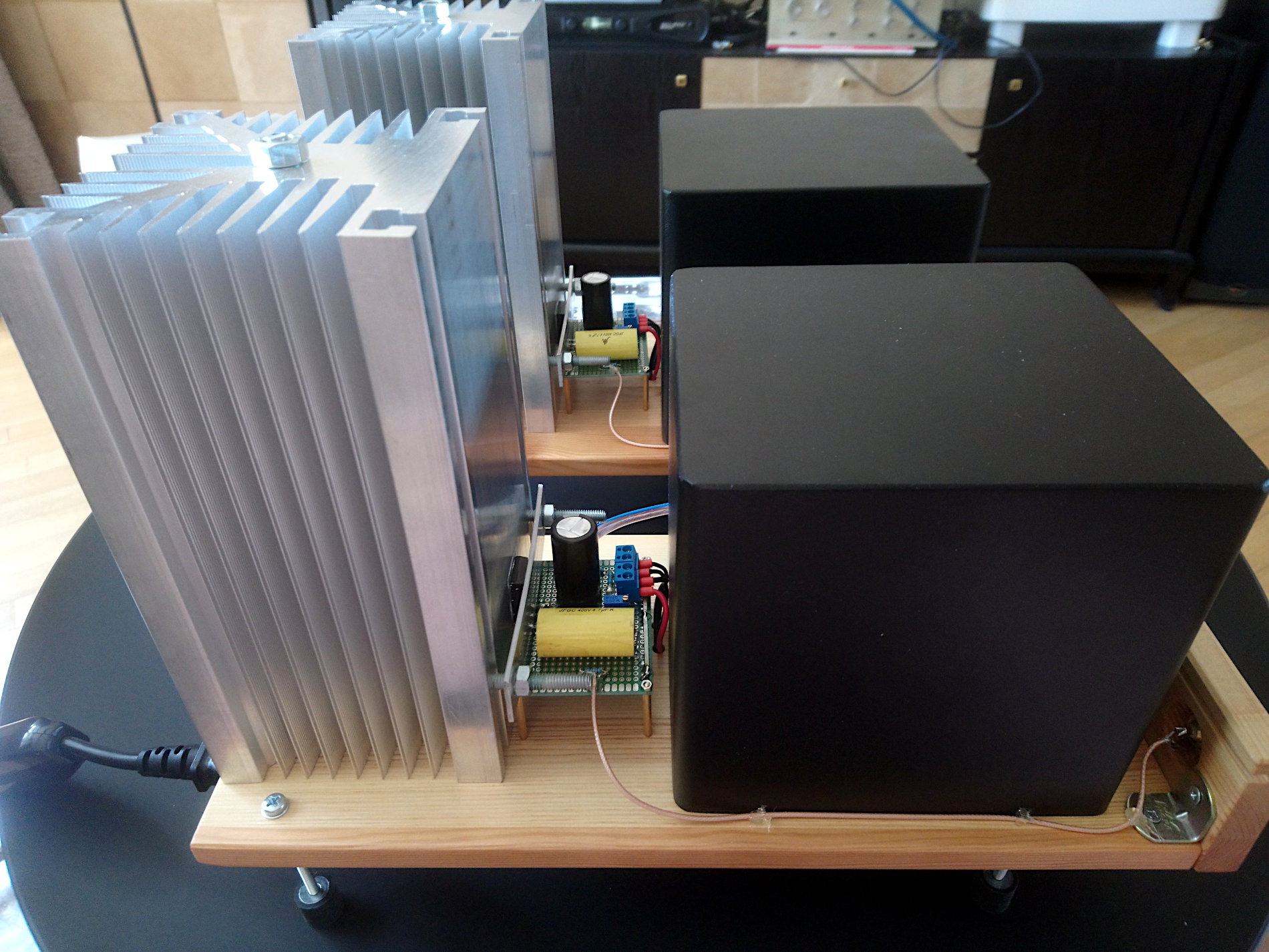

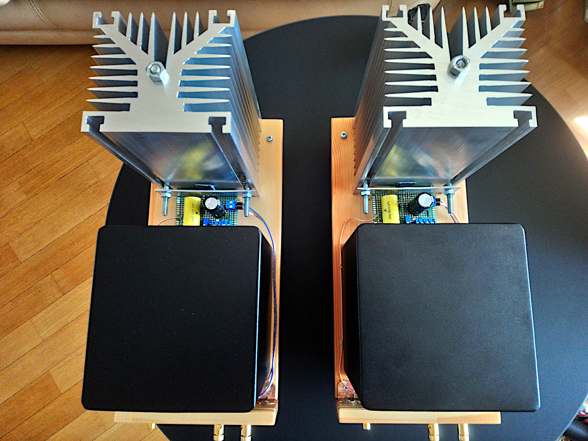

Two brand new MoFos.
Those are 'big' ones.
They were supposed to warm up my apartment during the winter, but I was a bit late with their construction )
I'm considering to diy anodize the heatsinks.

Wow! Those are some pretty large sinks! It looks like you have some fat chokes as well - what bias level are you running? With isolated sinks like that, all you need between your mosfets and the sinks is a bit of thermal goop. This will allow FAR better heat conduction than any thermal pad out there.
Any details on your chokes, or are they covers to hide otherwise ugly looking microwave parts?
Amps are biased for 2.5A. Not daring to go higher as transistors reach 100C on their surface after an hour or so.
Wanted to keep heatsinks electrically isolated from mosfets, but maybe you'r right and I will get rid of thermal pads to knock down the mosfets temp a little, thank you!
They are just steel covers, hide large MOTs, helps with shielding too, just in case.
Strange your mosfet get that hot. I run 3A/26V with about same heatsink. The heatsink get to about 54 C and mosfet a bit higher at the surface (65 C or so). I have placed the PCB so mosfet is at the middle (in height). Maybe this gives a better transfer of the heat...….
