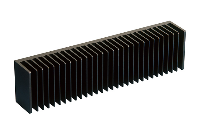

Conrad looks good, they have many sizes, like this one MF30-151.5: 151.5mm height x 300mm long x 48mm width. Weight at that size is 2.1kg
What would be the minimum heatsink size for the MoFo?
The Conrad prices make the heatsinks @ around less than 50% of the rest of the components. That's better!
Conrad has plenty to choose from. Think of a rating of 0.50c/w as a minimum point. This will let you burn off ~50w while keeping thermal rise close to 25c. The challenge is that Conrad rates their sinks at 80c which doesn't exactly translate to the 50c level where we use them in amps.
Looking at their catalog, I'd say the MF-25, MF-30, or MF-35 configurations will work well. Choose either the 100mm or 150mm lengths. General rule for sinks is larger = better. Go bigger than you think, many people report building new amp circuits in old chasses, so keep an eye toward the future as well.

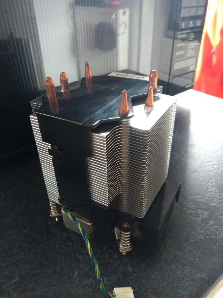

Rule of thumb is fan increases thermal capacity by 10x. A well designed forced convection radiator with optimized thin fins and heat pipes is in a different league. Go with CPU heat rating in that case. Typically larger cpu coolers with fans handle 150w no problem. Look at my MOAMOFO.

I am pushing my CPU coolers (probably rated 120w to 150w) close 160w (4.35A at 37v) with no issue. Mosfet body temp is about 60C as measured with IR thermometer on the aluminum clamp bar (with Kapton tape for 0.9 emissivity). Air temp of the CPU cooler fins is about 40C. Noctua 80mm PWM is running in still inaudible mode. There is a temp sensor in air stream and it kicks speed up if it ever gets too warm. It has 45C threshold for speedup.
Little Eddy,
Please refer to the nice post 1691 where Vunce gives dimensions and part number to look for when searching eBay for a surplus Dell CPU cooler. This one is nice because it has a big copper pad that makes mounting a large TO-264 easier. The dimension was designed for a Dell OEM shrouded duct cooler but an 80mm fan fits perfectly as you can see in Vunces photo below post 1691.
