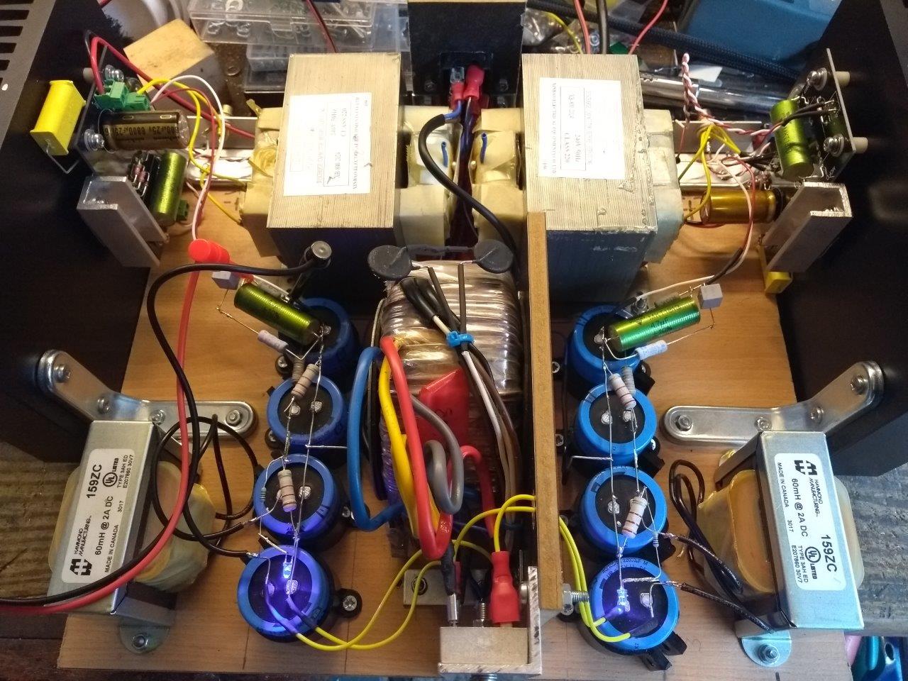

Attached is my current MoFo with MOTs and CLC power supply running at around 20V and 1.7A. Next up is trying different film and bypass caps.

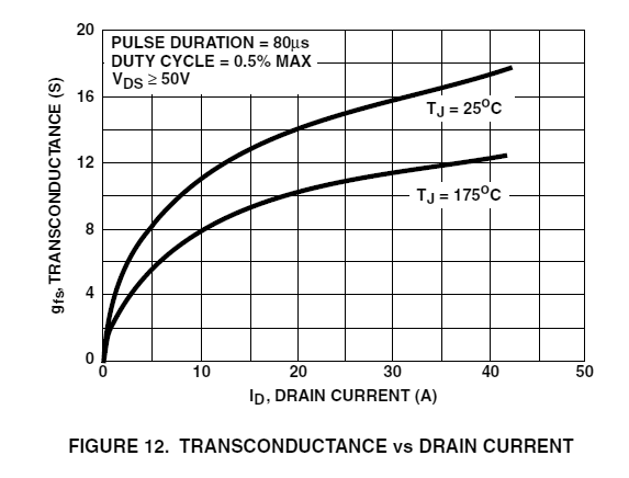

Question from the back of the class...., might there be a case for running with as high an Idss as possible.....
Yes.
Increasing standing current much above load current is one of the several ways to reduce THD.
For best use of costly power (and sink) you might bias at 16V 2 Amps, then swing up to 4 Amps and down to zero Amps.
How do you do this? Transconductance, Gm. A change of charge (voltage) on the control terminal (Gate-Source) causes a change of current in the output circuit (Drain-Source).
Is Gm constant? A little thought shows that Gm must go to zero at zero current. And there is no "wake-up point" where it suddenly snaps to a specific value. And the few MOSFET data which plot Gm show it varying very significantly with current.
Worked common-Source the THD may rise past 10% just before clipping. The MoFo works as Source-follower which masks much of the change of Gm, but may still rise past 0.1% before clipping.
OK, go to excess. Instead of 2 Amps, let us run 200 Amps (and 100X the heat and electric bill). Now instead of 2A +/-2A, approaching a swing of zero to 4 Amps, we have a swing of 198A to 202A (200A +/-2A) and the variation of Gm is probably 100 times less, THD may be 100 times smaller.
The higher current will require a MUCH larger choke. Nominally 100X the weight. Actually an iron core choke also distorts (this may be part of MoFo's THD) and the smaller *swing* may distort less. So maybe it won't be 100X. Still your UPS man will scowl.
There are several causes of distortion beyond change of Gm with current. Voltage effects from plate to grid (Drain to Gate). MOSFETs in particular show (inevitably) large change of capacitance with voltage and this can be seen in some of Mr Pass' simplest designs as a rise of THD in the top of the audio band.
Note that this is for choke(transformer) loaded. Resistor-loaded, seen in another thread, gets much less advantage because the DC feed resistor is still an AC load. But the main folly is that R-loaded amplifiers are SO inefficient that we can rarely afford to go generous, at least at speaker levels.
Push-pull (not choke-loaded) class A offers other THD techniques which are cleverer. To some degree high current "is good" but much depends on the details.
