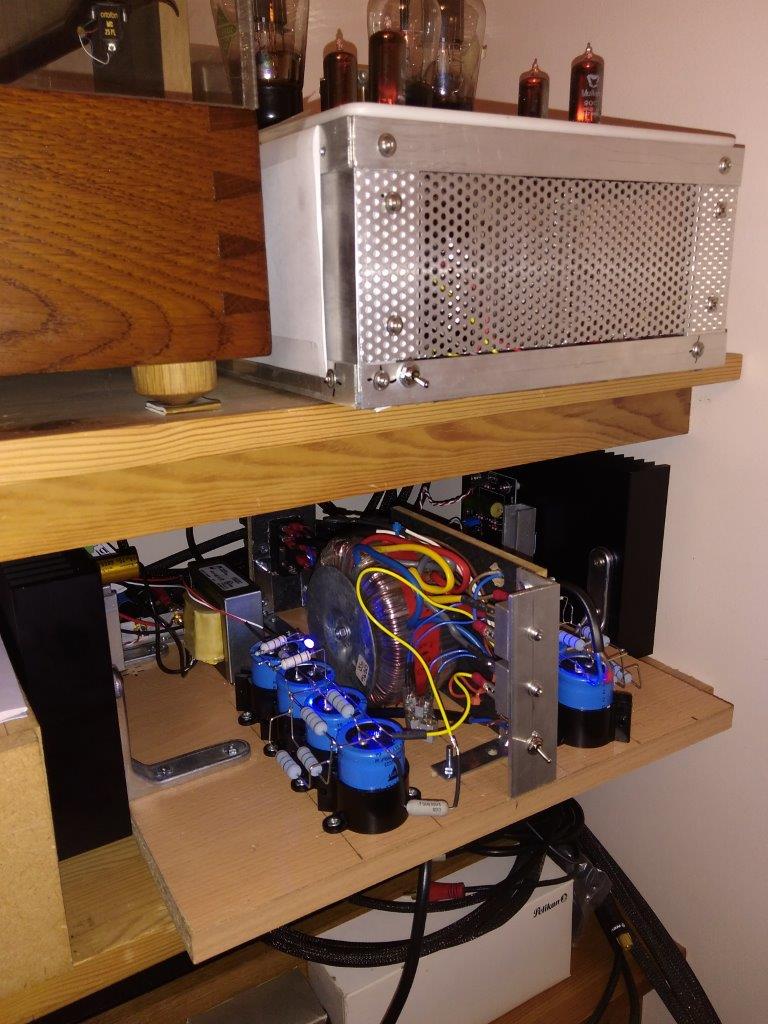

Just got my MoFo up and running and sounds promising.
Decided to switch to an OTT CRC supply due to a noisy laptop psu (and because I'd bought most of the parts for an F4), and wow what a change.
I feel assaulted and it didn't sound as if it was fed with a valve pre-amp. The detail was astounding with so much grabbing my attention. Bass was great and taught. And the sound stage - at one point I felt I was being flanked and surrounded.
The downside was it was just too 'detailed' especially in the higher octaves, with many of the audible little dings, taps etc on some recordings distracting me from the many positives. I'm hoping that some of this will mellow with further use and there being so many large electrolyics - is this normal and might things settle down? Perhaps some silver interconnects needed at least in the short term to tame things a little!
The other good thing is that at 19V and around 12W, I find myself questioning whether I need to strive for any more power.

Ah - welcome to the club! I just love my MoFo being driven by a BA-3. I have many of the same reactions that you do, especially the enveloping sound stage. This amp does seem to coax out more bass than some of my other DIY amps.
I haven't noticed too much detail on the top end as you have. Perhaps this is something specific to speakers or other components in the chain?
I'm running both channels (6A current draw total) from the same 12A Dell power brick and haven't experienced any problems with power.

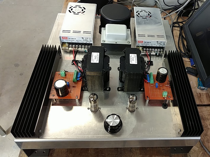

Mofo Hybrid
This is my version of the MoFo using a tube driver section plus cathode follower section per channel. The heat sinks are not that big so I'm running 22V @ 2A. The heat sinks are pretty warm, but I could probably hold my hands on them indefinitely. Not sure how hot is ok, and it's only been running about 1/2 hour.
I haven't hooked up my main speakers to this yet. Right now just running some small bookshelf speakers. Sounds pretty good though.
This is built on a rack mountable shelf, so at some point I'll put the rack brackets back on it and install it in my free standing rack.
Thanks to the OP for a cool design and everyone who has posted here. Lots of great information.
