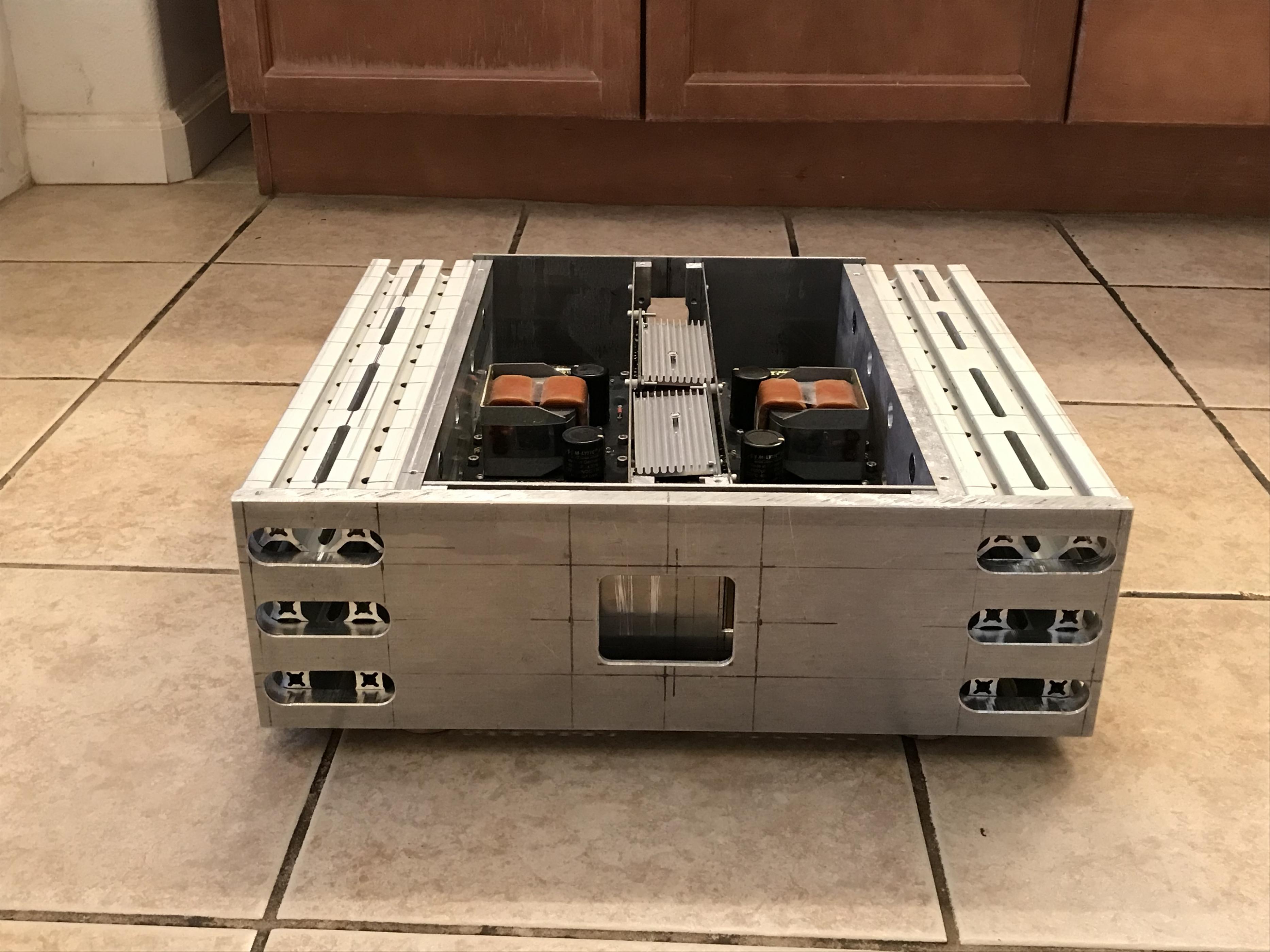

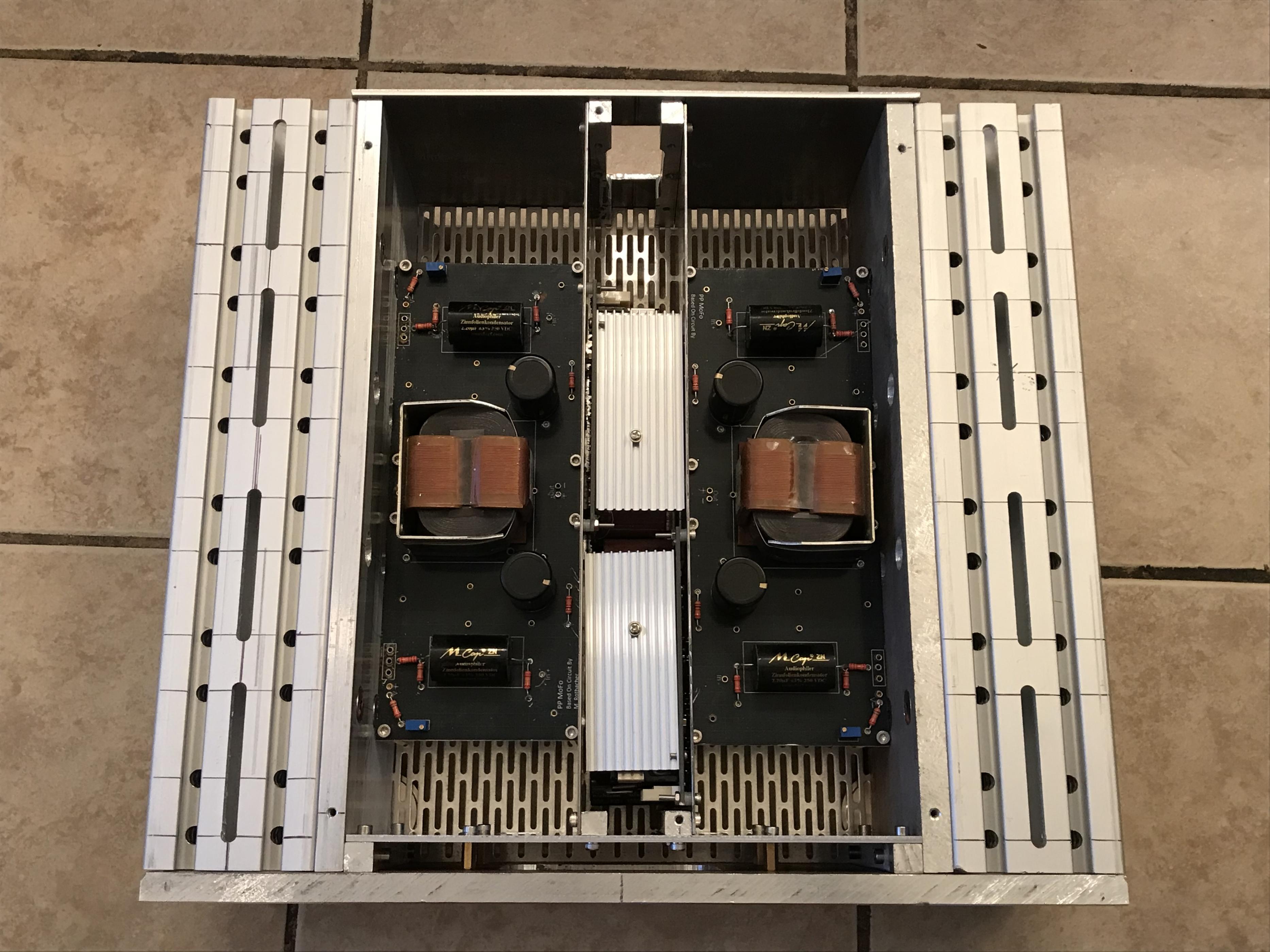

I finally got around to working on the chassis for the MoFos. Hopefully I will have a finished amplifier in a few weeks!
Interesting build I like the use of v slot doubling up for or heatsink/enclosure use.
I've notice a couple of builds now using v slot and C beam sections.
Be interesting to get some feed back on how effective it is and the sort of temperatures you are seeing when your up and running.

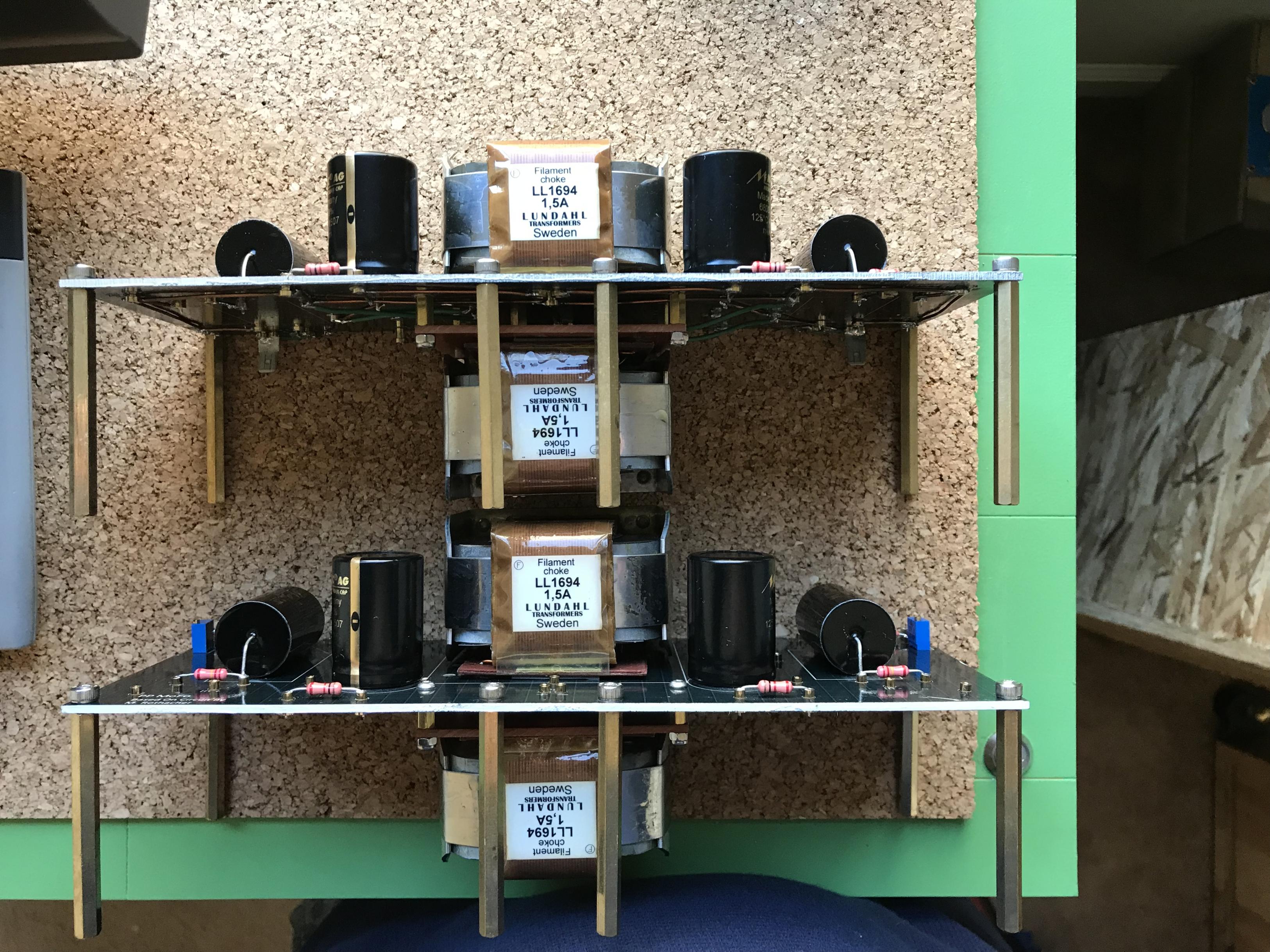

Are there 4 MoFo's?
A kind of push pull configuration?
Are the C-core trafo's the MoFo chokes?
Hello Meper,
Yes it is essentially four MoFos. The PP MoFo is a misnomer because I thought it sounded funny when in actuality, they are just bridged using dual bipolar power supplies and complimentary mosfet pairs. The Lundahls are the chokes and I have one on top of the board and one on the bottom.
Bao
