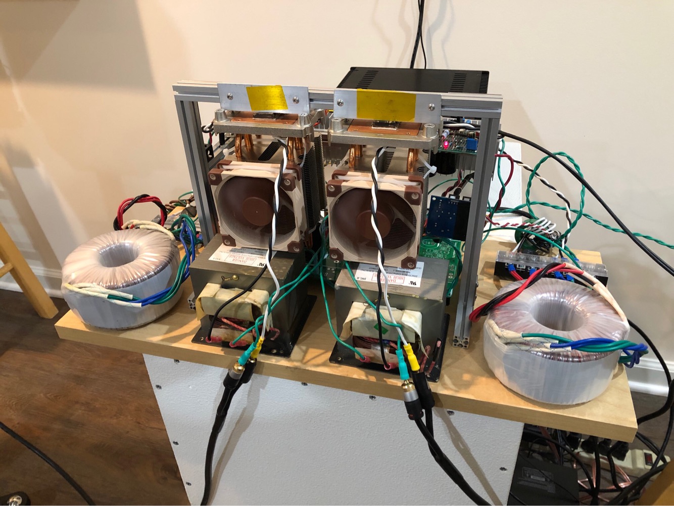

Is it your plan to convert this prototype to a "cleaner" prototype with a higher WAF?
I am somewhere in between that. I don't think my MoFo setup with BA3-pre has a high WAF but high enough for me…….at least for the moment
Nice setup there Meper, this is purely a prototype setup and as such, has been great for testing. Installing the amp PCB and MOSFET into the heatsink CPU cooler is a 30 second operation with a hex screw driver. I can’t imagine how slow this would have been had I used a traditional case for development.
Next step is for a proper amp PCB and single rail cap Mx layout. Then it can be beautified and put in some sort of chassis. The open air extruded rails look quite nice.
I am planning on using a new compact cap Mx (MrEvil type) with a new integrated active bridge using LT4320 and a pair of SMT dual N channel MOSFETs that will allow up to 5amps with almost no heat output (no heatsink needed).
I have "only" 3A bias. With 26 VDC this is about 80W in heat. It is what the heatsink can take (approx. 54 C). The choke can take much more but I am very satisfied so far with the sound and the BA3-pre is a good match. It takes 1/2 - 1 hour of heating up before the sound quality is at maximum. Good to hear that your plan is to make a final version of the MoFo!

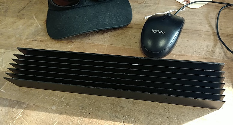

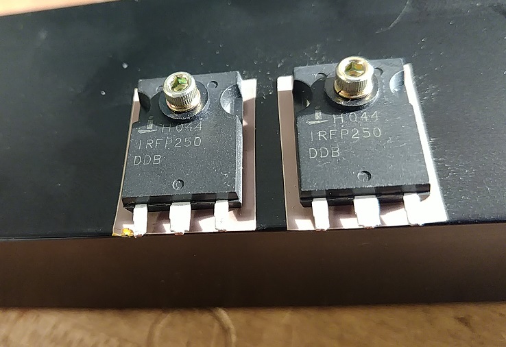

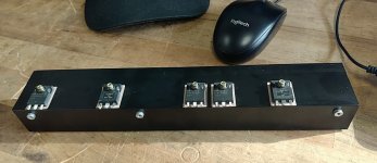

I salvaged 3 of these heat sinks quite a while ago. What are the chances? I can just remove all other devices except one and solder on to what is remaining of the leads. I believe the IRFP250 devices are OK. Hopefully the heat sink is large enough.
Finally up and running in full stereo with MOAMOFO. Currently operating at 36Vdc rail, 4.35A bias current, and driven by Melbourne Preamp. Once I upgrade the power supply trafo on the Melbourne to +/-28v (currently 24.5v), should be good for almost 50w into 6.8ohms. Right now in main listening room and driving very inefficient (82.4dB sensitive) but superb sounding transient perfect ScanSpeak 10F/Dayton RS225 FAST speakers. There is an abundance of power and no sense of strain. Sounds wonderful.
If you are adventurous, you could cut all three heat sinks in half, screw 3 of them vertically into an aluminum plate at least 5mm thick of equal dimensions,
to use like a traditional case as you see in the store.
This would work well if you are using external laptop power supplies.
