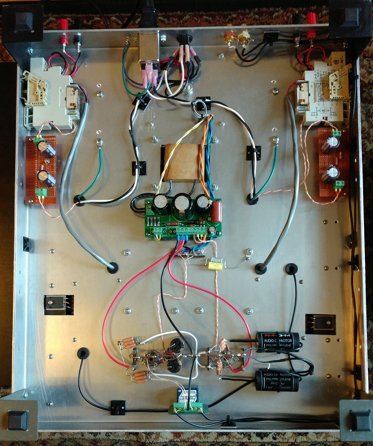

How is the "coupling" between tube stage and input to MoFo made?
The perf board looks good…..often they look at bit "messy"....but not this one…..
Thanks prazza1, the tubes are both 6N6P. I bought a few of these about 5 years ago always planning on a preamp of some kind one day. This seemed the perfect use. I read another poster here used 6N6P so I thought I'd try them. One tube is the driver section for both channels, the other tube is for the cathode follower section. Since the cathode follower cathode is at about 135V, I elevated the heater for that tube 100V. I have not put it on a scope yet, but the output of the tube section should be about 40VP-P with a 2VRMS signal.
Thanks e_fortier. When I get this hooked up to my Altec 604 cabinets I'll post my impressions. I also want to run an FFT analysis and see what the distortion levels look like.
MEPER, the tube stage uses a 1uF output capacitor, so that connects directly to the junction of R1, R2, & R3 on the MoFo. I deleted the 2.2uF C1 cap from the MoFo. I don't think the tube stage output cap needs to be greater than 1 uF in this case. I'll know more when I measure the frequency response.

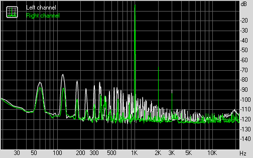

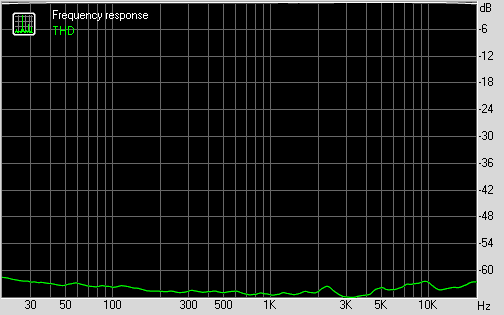

Test results
I took measurements of my build. These measurements are through the tube preamp section.
The MoFo power supply voltage is 22V. Amp biased at 2A.
With 2VRMS input @ 1KHz:
28VP-P output or 9.9VRMS right before clipping
9.9^2 = 98/7 ohms (dummy load) = 14W
The plots are from Rightmark Audio Analyzer.
I had a thump at power-on so I installed a speaker delay relay. Problem solved.
Listening on my Altec 604D cabinets, sounds good, I like it. Plenty of detail. Separation good. Listening is so subjective it's really pointless to try to describe. It's amazing to me that 2 heat sinks that I pulled out of the trash, with IRFP250 already mounted on them, can sound this good. Really the only thing I had to purchase to make this work were the 2 chokes.

I guess that the visible noise originates mainly from the power supply for the tube. Would it be worthwhile to invest on that?
Could be, but it's way down in the spectrum. The noise at the speaker output terminals is 0.7mV. Inaudible to me.
