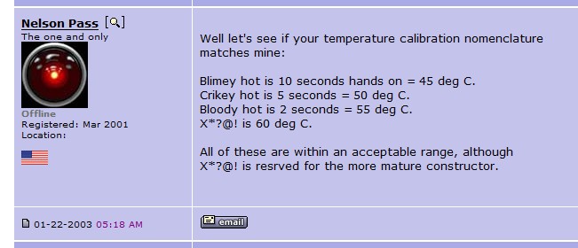

I can hold my fingers on a front aluminum bar for a couple of seconds no problem.
So maybe my camera is overly pessimistic after all.

Using Nelson's quote that ZenMod posted, you should be able to do rough-but-close-enough estimate of temperatures. If you think your temps are high, drill some holes in that board beneath the finned area of your sinks to improve the airflow. Anodize will also increase thermal radiation, keeping things even cooler.

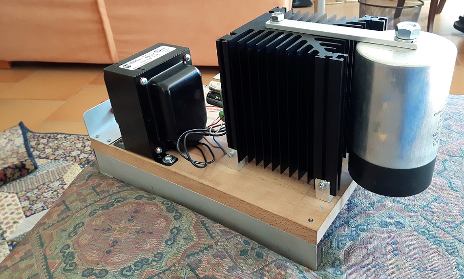

I would say that to make the air flow from the bottom upwards and facilitate the dissipation it can be enough to lift the heatsink like I did with aluminum supports

Lifting the sink is the approach I used as well. Even a little will help - my spacer was about 1/4". Is that your output cap strapped to the sink? Or is it for the PSU?

Interesting - what is the rating of your cap? Are you using a linear PSU or a switched mode? I'm gathering some big film caps for a tube amp PSU, never considered using them in a solid state amp...
I used a switching power supply. But I thought of integrating these large polypropylene caps that certainly helped the performance on the listening level and I also inserted a snubber. However I did not make comparisons with a classic linear PSU that I was about to make .... I have the material but.

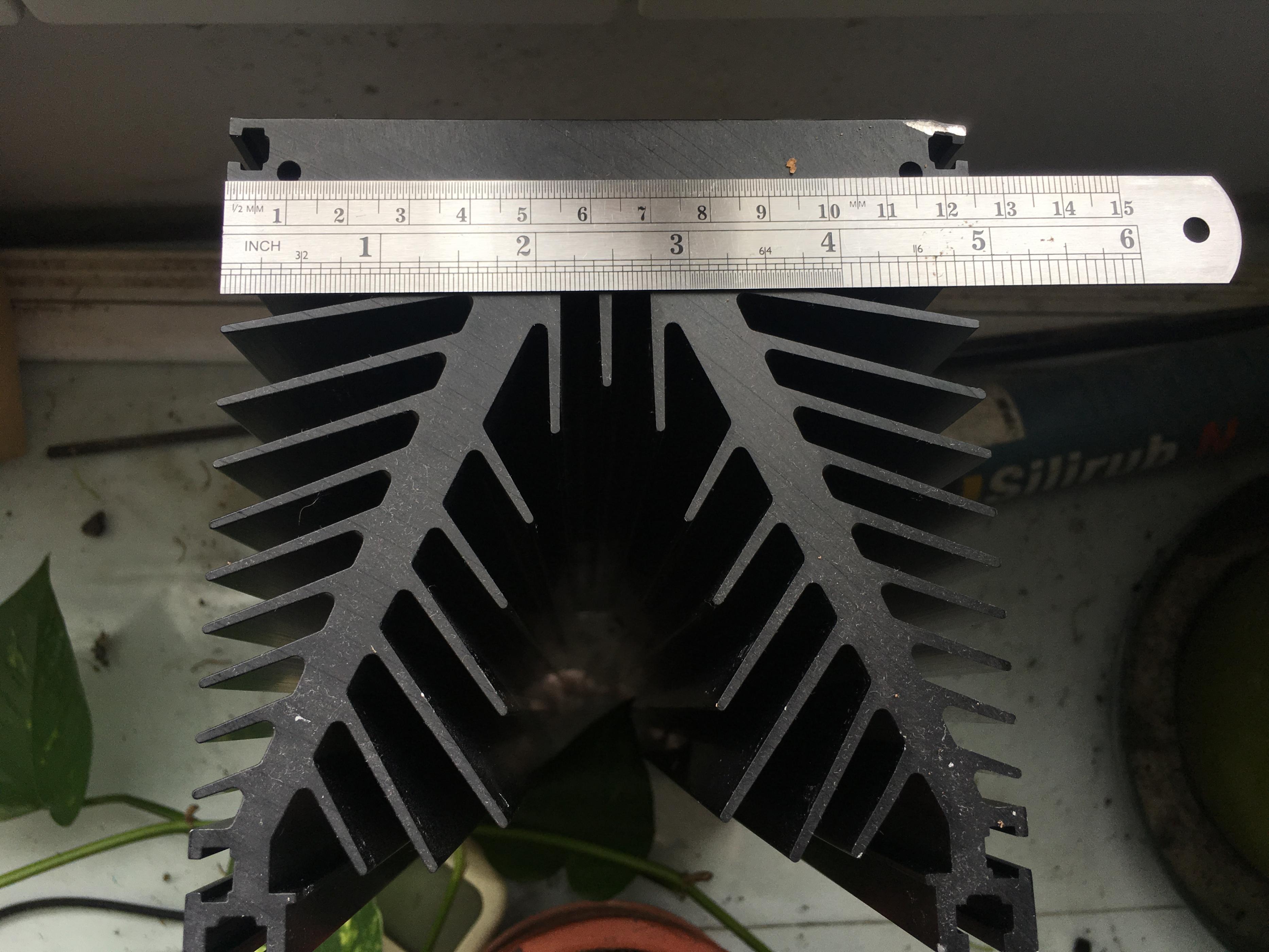

I have a 300mm version of the heat sink shown in the original article. Mrs JRKO is not enamoured of the idea of monoblocks. I’m planning on can cooling from the bottom of the heat sink. Where should I place the irf250’s?
