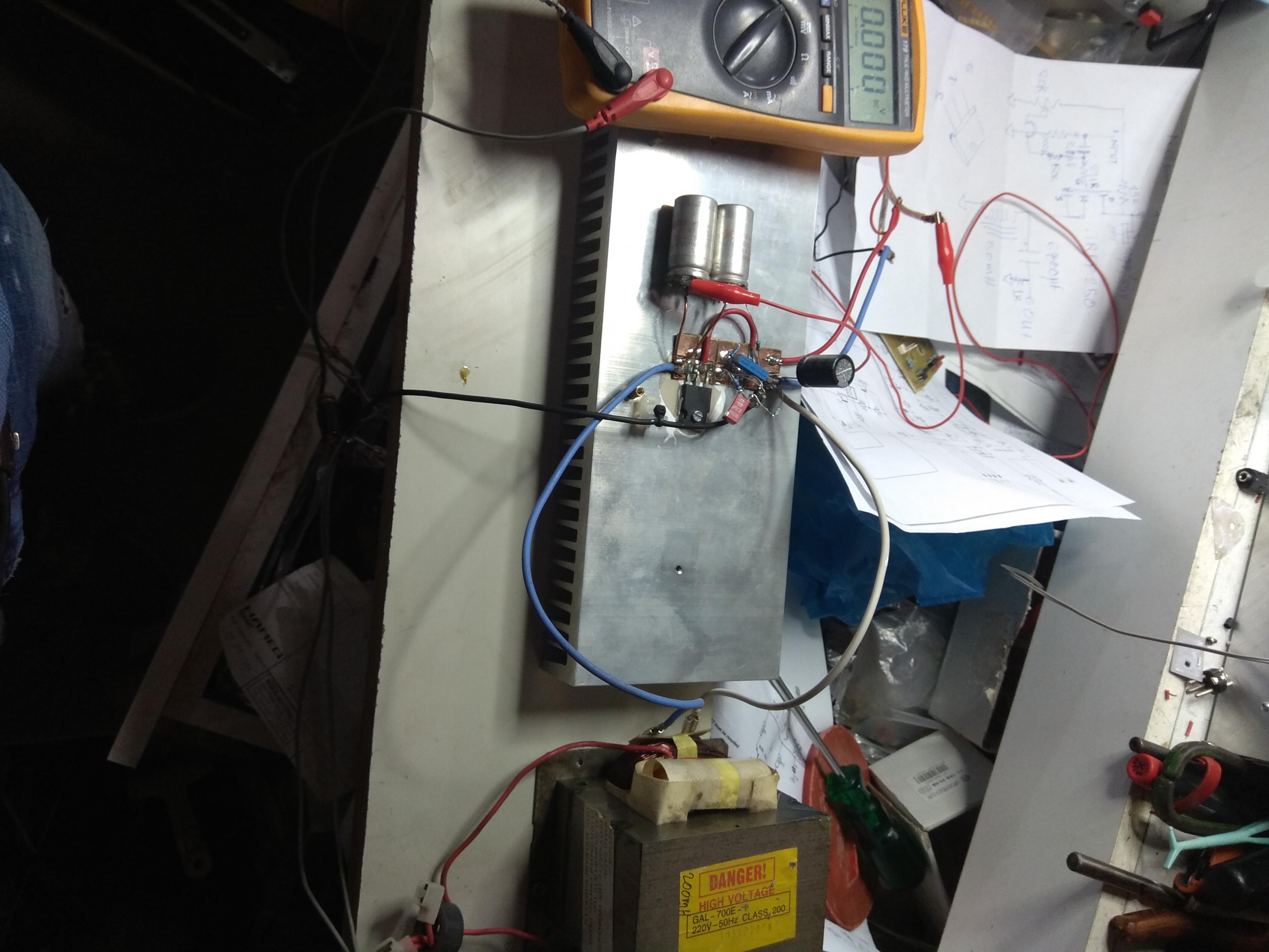

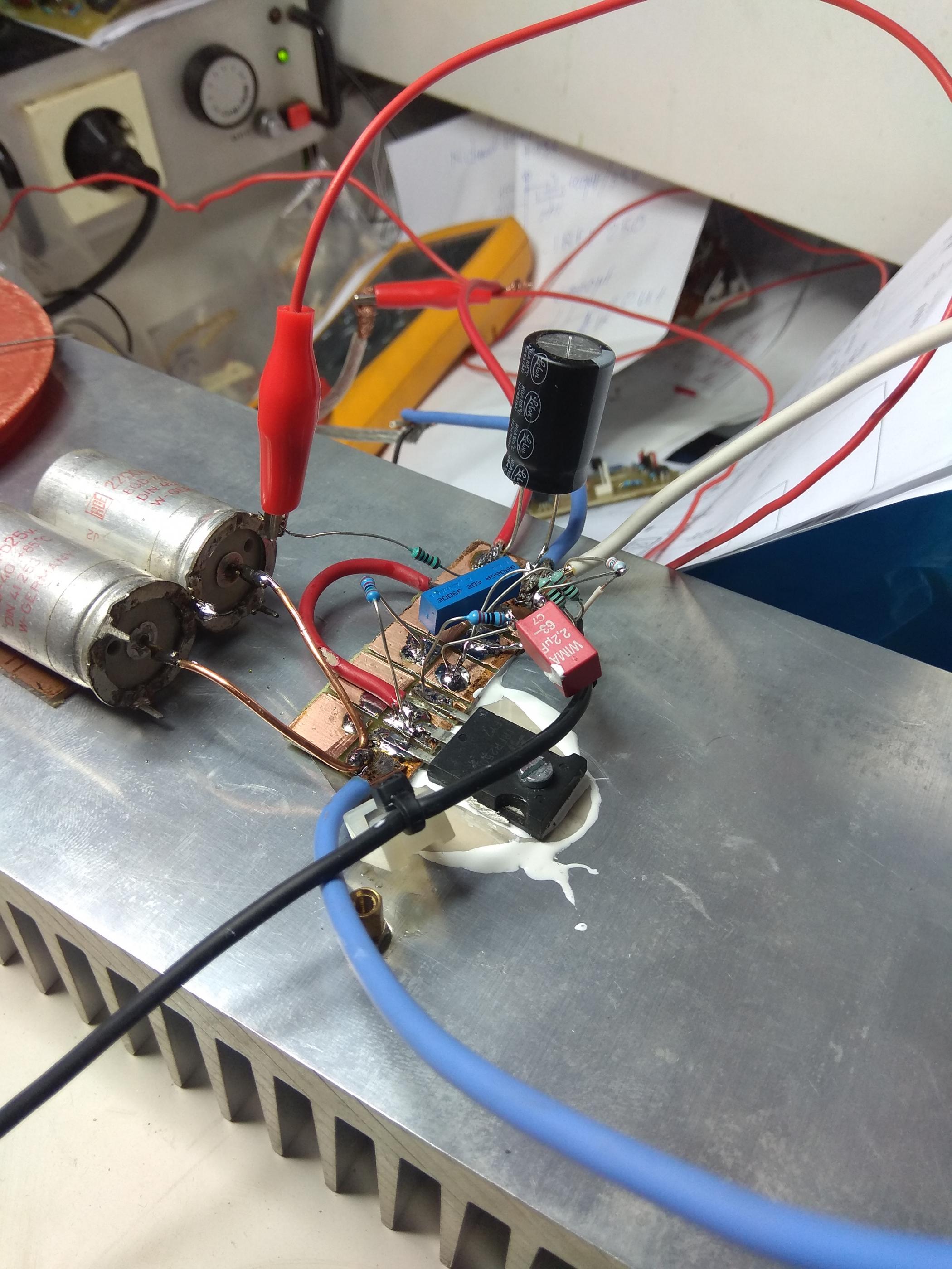

One afternoon build.
20v
Bias 1.5A
I'm afraid that i haven't the way to drive it.
The first try was using an Elektor preamplifier arownd ECL86.
Very low output on speaker.

Nice work Thimios. You need something like an Aksa Lender preamp or something with lots of vintage swing to drive it. I can get about 11w with 20v rail.
In meantime, a headphone amp works ok for moderate levels.
The question is how good these transformers handles DC current as they have no airgap. But as far as I remember they are said to work fine. Don't think I have seen any measurements that confirms that.
It is probably a 1,000 Watt oven.
The MoFo is a 24 Watt amplifier.
Yes, not-gapping is inefficient of iron, but this ploy uses 10-40 times more iron than "optimum" because MW oven iron is a throwaway (or at least readily available).
Also the source-follower is not very critical of Inductance.
But get it while you can. My last two nukes have no 60Hz transformer, all switchers now.

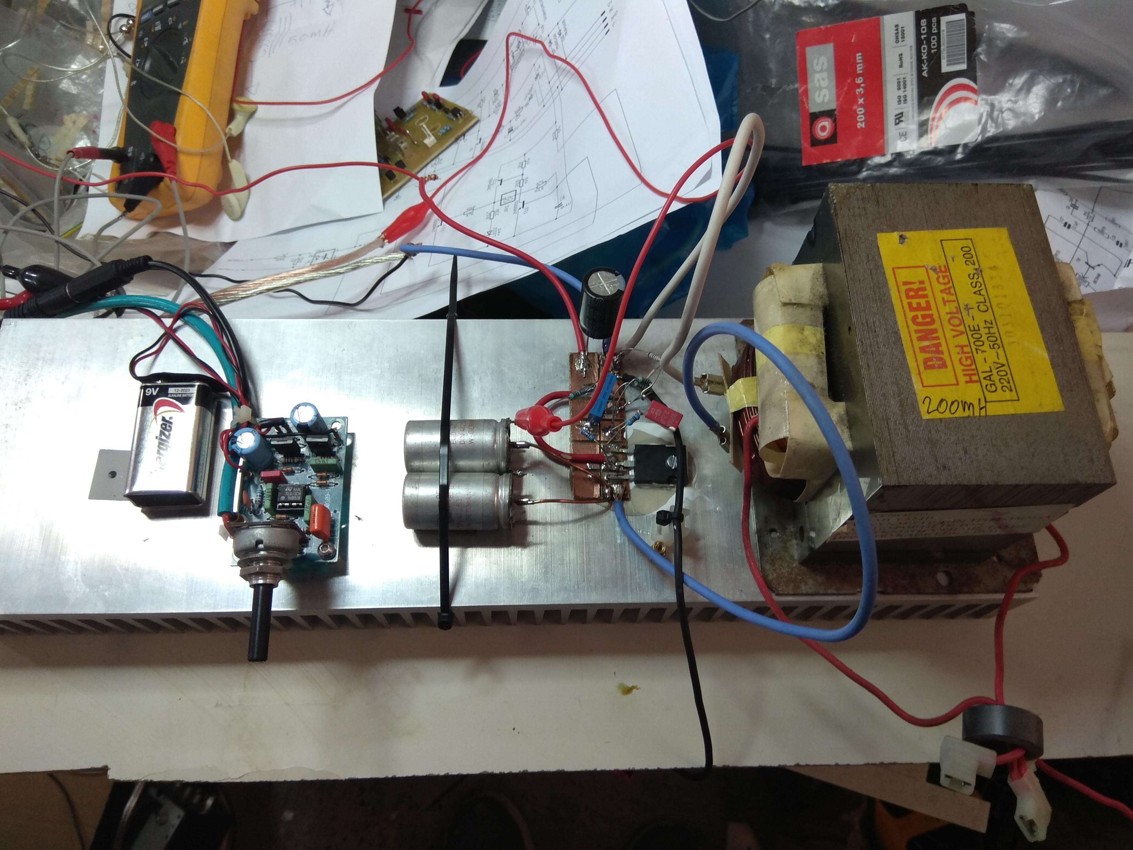

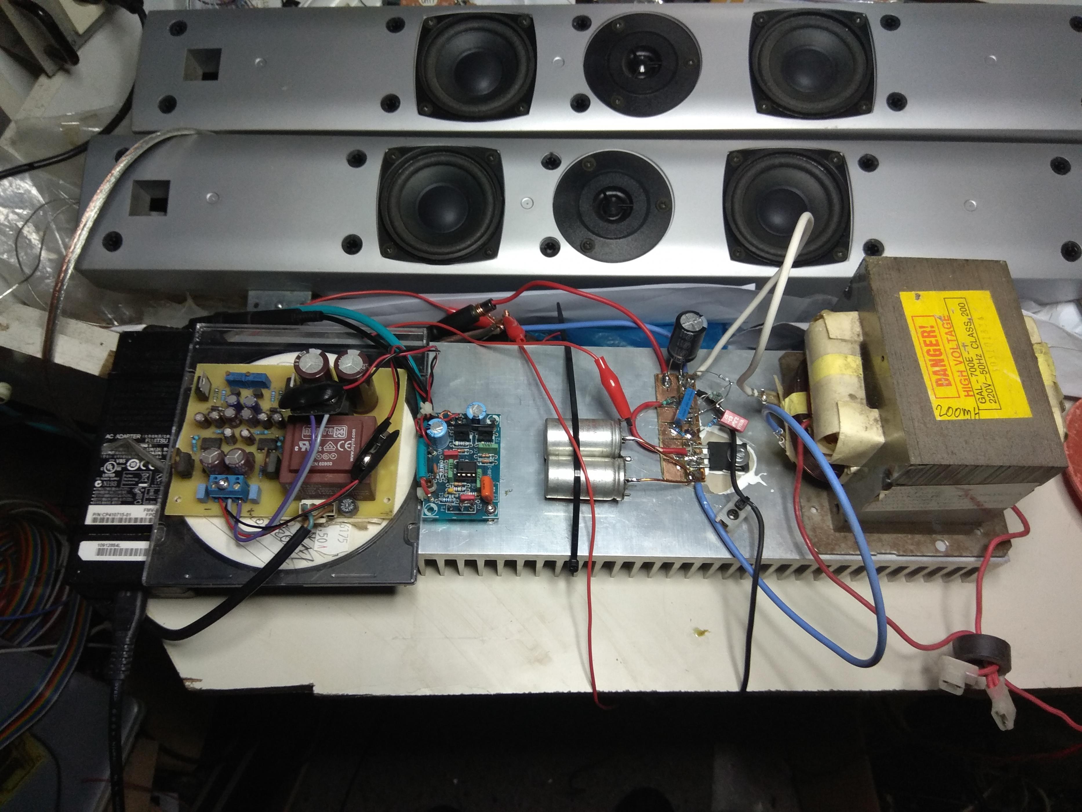

Thanks X, not nice looking but functional.Nice work Thimios. You need something like an Aksa Lender preamp or something with lots of vintage swing to drive it. I can get about 11w with 20v rail.
Now lound enough.
Driven from an old Elektor headphone amplifier.
