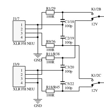

For what is this part (-> attachment) of Bruno's schematic? I mean the Rs and Cs.
In a word - yes. The two outputs effectively form a buffered /amplified balanced output signal from the DAC.
Suggest that Vbias be 0V
Yes they could. I'd have a series buffer resistor on each output leg of 100R or a bit higher.
What's the advantage of this resistor?Yes they could. I'd have a series buffer resistor on each output leg of 100R or a bit higher.
Thanks! 🙂
The series resistor on the output of each op-amp is to prevent them from potentially oscillating due to the capacitance of the interconnect leads going from them to the next stage.

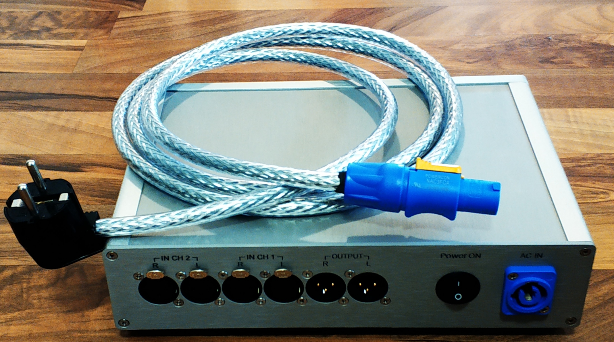

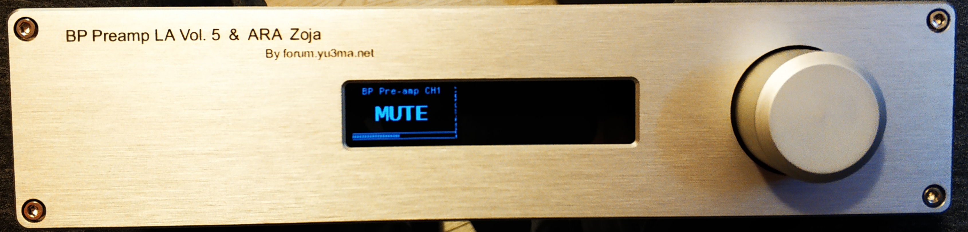

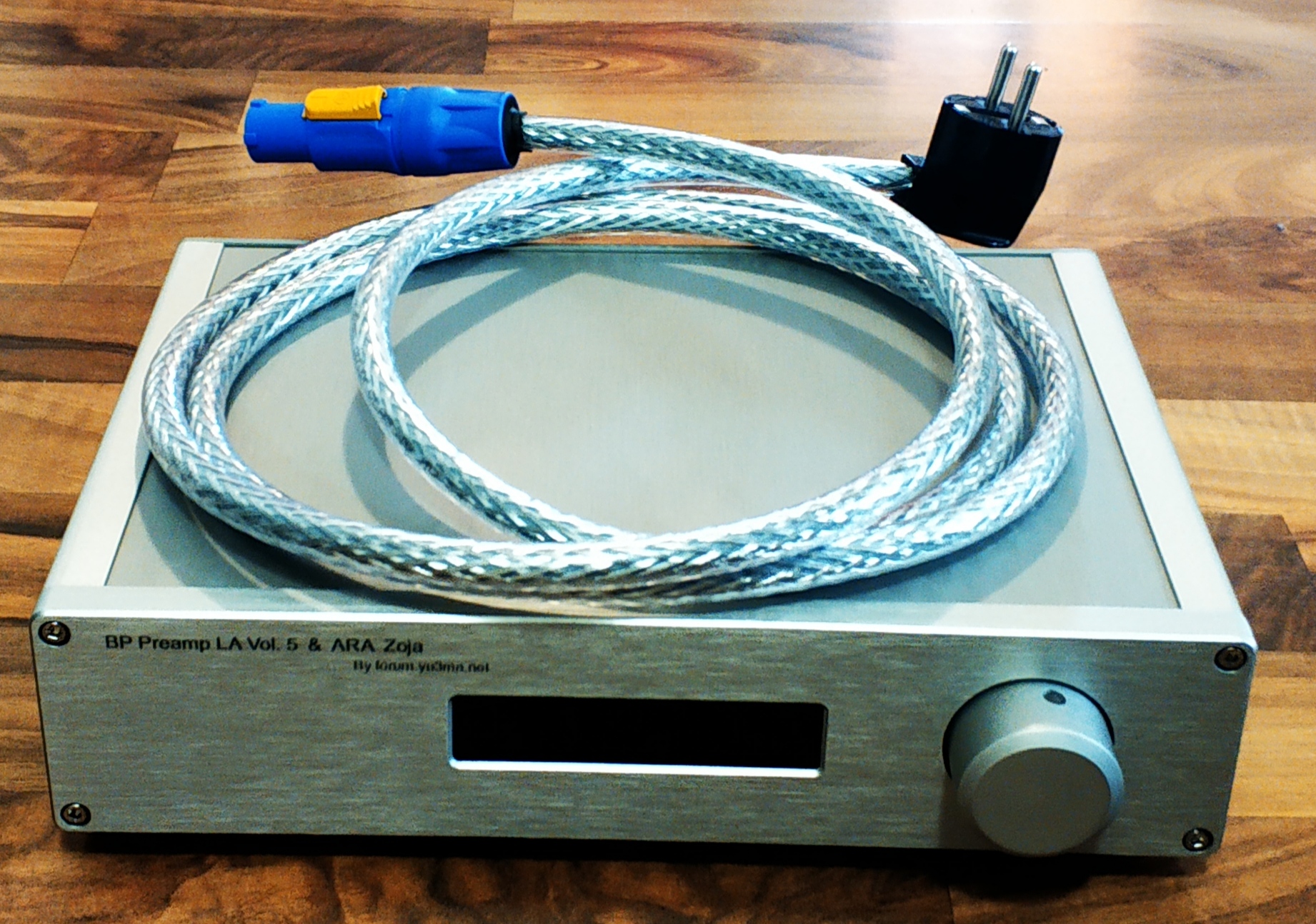

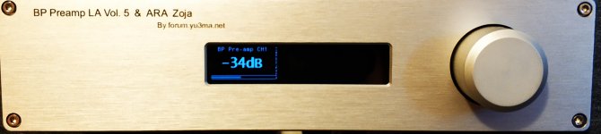

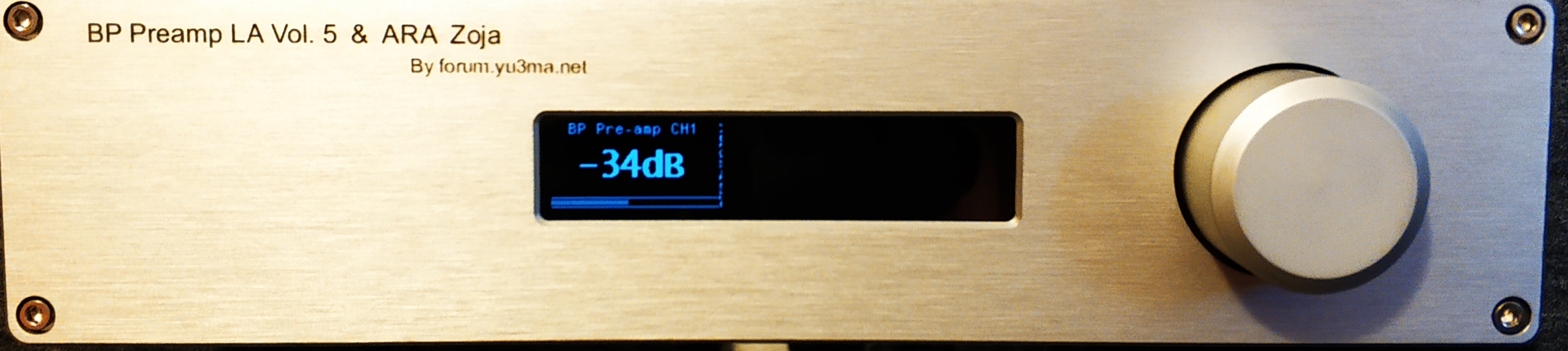

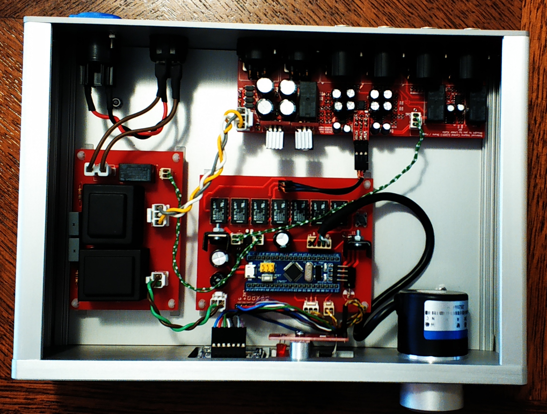

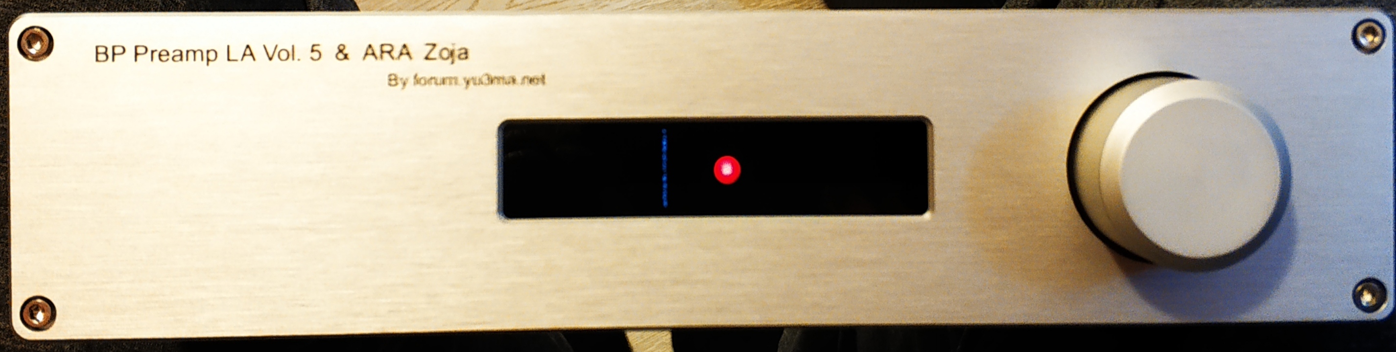

BPPBP(BP Preamp LA vol.5) & Audio Relay Attenuator Zoja
Here is one BPPBP integrated with the Zoja audio relay attenuator that is the fruit of our local forum.ARA Zoja has a remote control, is based on a bluepill plate and is adapted for BPPBP. Attenuation is done with 6 relays (-63db) and the seventh relay is for the MUTE function. It also has an output for a POWER relay as well as a channel selector (CH1/CH2). With the help of an adapter plate that is soldered instead of a potentiometer to the BPPBP connection is made with two balanced microphone cables of 3mm.
You need to listen with your ears - 5532 are the worst music killers in the world, and should be forbidden by law.Here is how it looks.
