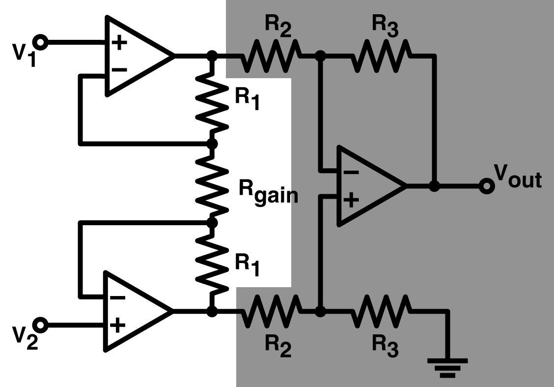

And polarity like in #1015 (different to your schematic)?
Oh oh, I blindly copied an image from google - the image has wrong polarity for the upper opamp. Inputs go to noninverting (+) inputs as in the schematic for my pcb.
I'm not sure that the schematic of #1015 would work at all - I've never seen such an instrumentation amplifier.
As regards gain, the volume control stage in the original preamp schematic can provide gain at will.
I guess you refer to the wrong polarity of the upper opamp also?
Regarding gain: i using a stepped relay attenuator there's no gain in the circuit - if you need some, as previously stated, I'd put it on the input stages.
Thank you again 🙂 I thought the polarity in your pcb-schematic should be right... 😉
Yes, the upper arm is not correct.

If OPA1612 is used in that configuration you might want to allow for optional feedback capacitors in parallel to the resistors labeled R1 in the schematic posted by Tfive.

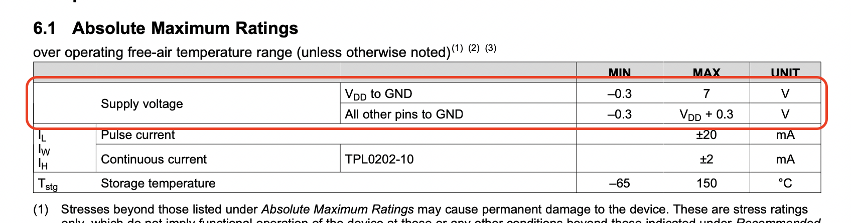

I did not understand this part. Bruno uses a linear 10k, 2-channel potentiometer (Bourns "PTD902", 2x3 poles). Why shouldn't that be 1:1 interchangeable with this, for example? Voltage supply should be no problem.That's in theory possible but it would not give you linear dB steps because the pot is used in the negative feedback path of the opamp. All the digital pots I know of have to be wired differently to how Bruno uses the pot in his circuit.
See its datasheet, section "Absolute Maximum Ratings". It says, Supply voltage: Vdd to GND, -0.3V to 7V; All other pins to GND: -0.3V to Vdd. If you want to connect one of "all other pins" to an opamp powered by +/-12V rails, the digipot will see + or -12V at some point, which will exceed its ratings. Those digipots are made for a different application (replacing trimpots, hence nonvolatile memory), and their distortion performance is probably not great.
