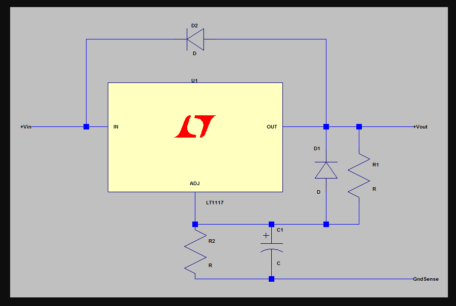

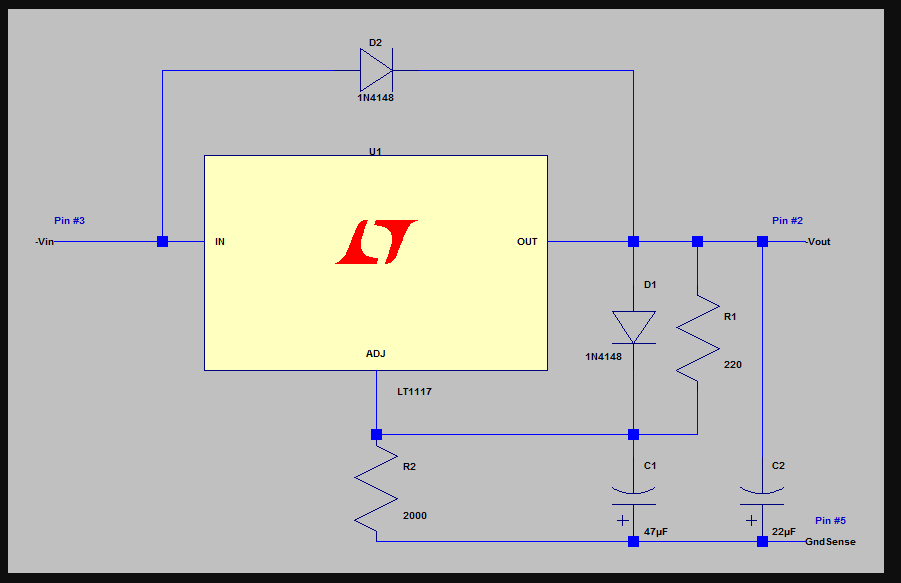

It is not a replacement, but a pin-compatible regulator with LM 317 and a capacitor on the ADJ pin were made.is there are "replacement" for the hypex discrete voltage regulator? thanks
Any 3 pin reg with correct pin out will work, just without the kelvin sense

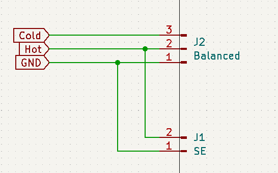

Can I make a parallel output (XLR and SE) and connect the amplifier to the XLR and the subwoofer to the RCA, or do I have to make a balanced to SE conversion on the SW output?

Have another look at the circuit diagram and you will see that the output is not differential, but made balanced by inserting a resistor in the gnd line of equal value as in the hot line.
An SE output would mean to tap the ground line right before this resistor.
Hans
Hans
Thanks Hans, I understand now.
