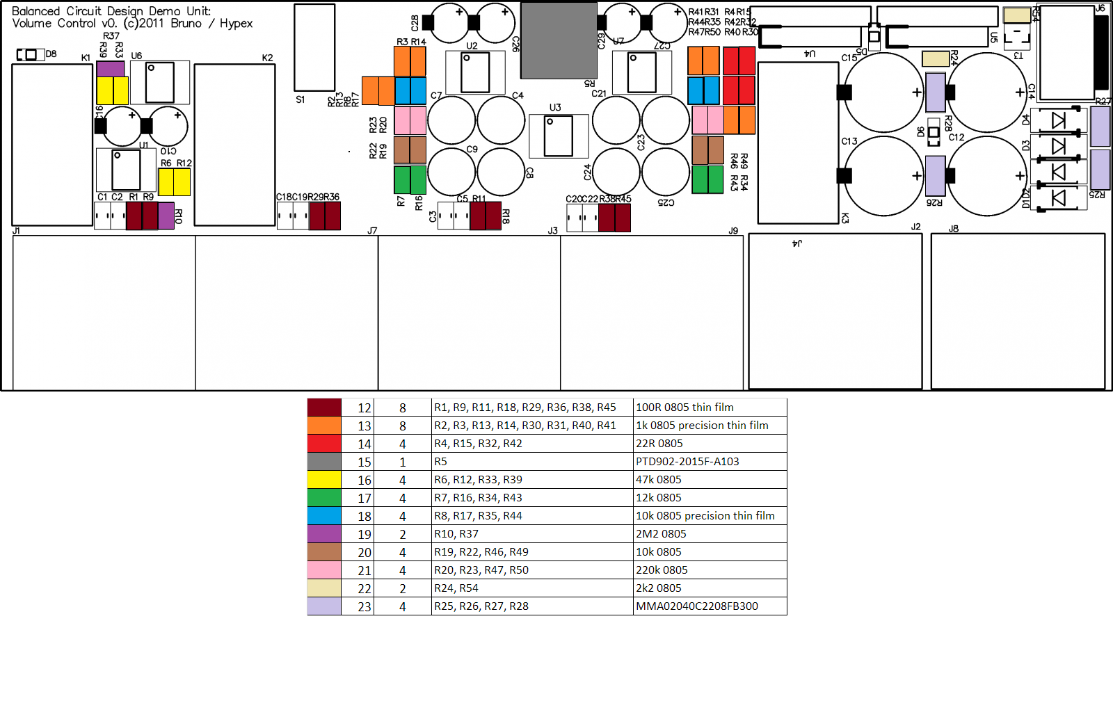

Today I have changed the wiring to the arduino and installed new power supplies and installed the preamp board on a temporary plexiglass “case”.
When I powered it, the clicking noise came back. DC offset on one channel was 1 volt when measured at the opamp and gnd.
Upon someone’s suggestion I have shorted R10/37, the 2M2 resistors that go to GND and the dc voltage dropped to 60 milivolts. Huge difference. There’s still clicking noise but lower and now there’s a buzz of course.
This sounds like a bad pcb or something. I can’t explain how yesterday it was ok after reflowing most of the parts and today it no longer is.

Two likely possibilities
Also inspect solder joints with decent magnifier and good light. Do you have something like a jewellers loupe?
- damaged resistor (they can look fine but film has cracked
- device pin still not soldered onto PCB pad.

The Bruno Putzeys board is pretty tightly packed so can be more difficult to work on or inspect.
When looking at soldered joints under the microscope, it's worth looking a joints from an angle. It may look good when looking down vertically but when seen at an angle you may find the connection doesn't touch the PCB pad. You may also find you missed actually soldering a pin!
Intermittent faults can be difficult to find. I've had frustrating times with boards in the past but usually been able to find the problem in the end.

Yeah it is very tightly packed. I’ve soldered capacitors on te other side 🙂
Relays unfortunately don’t work on the other side. Makes it hard to reflow, inspect and even stick a soldering iron in there.

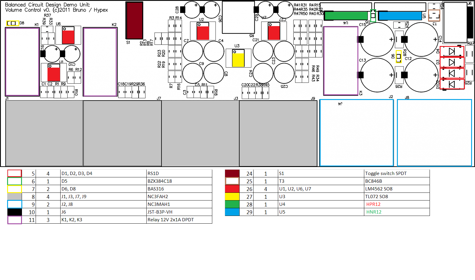

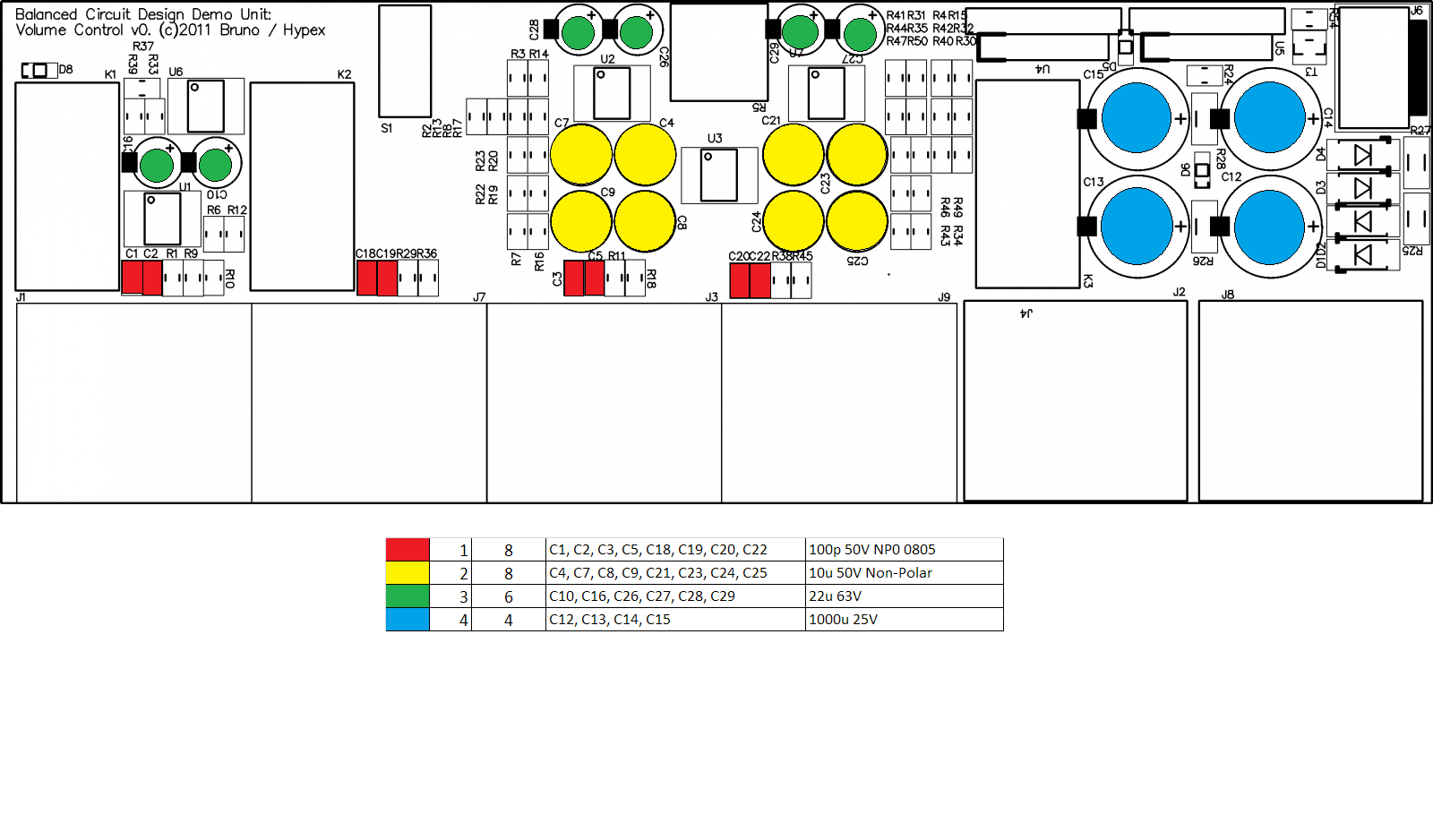

These are my build, inspection and test aids. I can't remember if they are final rev or if I've posted them here before. I like to print these out highlight and check things off, this process is a must if your dealing with thousands of parts. I remember having problems related to grounding when pre-chassis. If something seems off let me know and I'll check my build.
