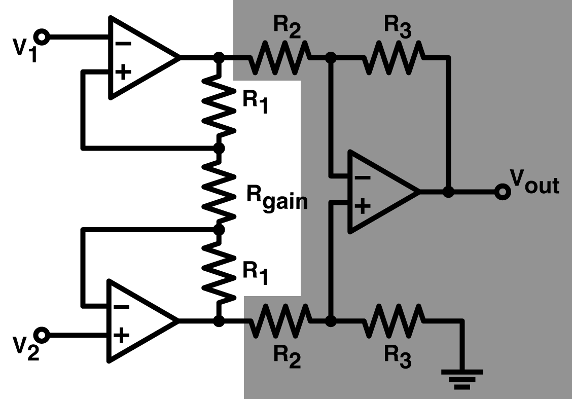

Can you explain something basic to me for better understanding? Hypex and Purifi always talk about adding a buffer with gain (-> 9.6 VRMS) to achieve maximum power. Is this really necessary or useful in practice? If so, what is the most elegant way to integrate adjustable gain into this "preamplifier"?
Yes. these are currently configured as unity gain followers (output connected to inverting input). Adding the three resistors as shown above will make them each have a gain of:
g = ((2 * R1) + Rgain) / Rgain
R1 should be around 1k and Rgain adjusted for the desired gain.
I'm not sure that the schematic of #1015 would work at all - I've never seen such an instrumentation amplifier.
As regards gain, the volume control stage in the original preamp schematic can provide gain at will. My experience with Bruno's preamp and a Hypex UcD180 (since 2013) is that I need attenuation of some 20 to 30 dB for comfortable listening with 85dB/W loudspeakers in my room.
