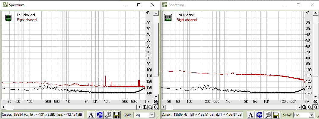

The DA might produce a test tone to measure distortion etc, but in the measurement I have shown it does not do anything specific besides being connected, having an output impedance of 200R. This is kind of a real-world situation: a device connected to a preamp, which is connected to an AD. What you see in the graph I posted is DA->preamp->AD without phone (in black) and DA->preamp->AD with phone (in red). So the noise contribution from the 200R + whatever it produces on top of this there in both cases. Don't worry about absolute values. I can measure the DA/AD loop tomorrow, but IIRC the phone does not have a similar effect in this setting.

Ok, what you are saying is that with my measurement setup I cannot possibly measure the noise of the preamp. You are of course correct.
What I am actually trying to measure is: "Does the preamp reject interference from my phone?". If I put the phone next to the AD/DA there is no effect whether the DA connected to preamp or not. If you see a more sensible way to do this test (without sending the preamp to a proper EMI testing lab), I'd be very interested. If not it would be great if you could put your phone next to your preamp to see whether it rejects the interference or not. This would give me a hint whether it's my implementation or the design that is causing the behavior you see in the graph I posted.

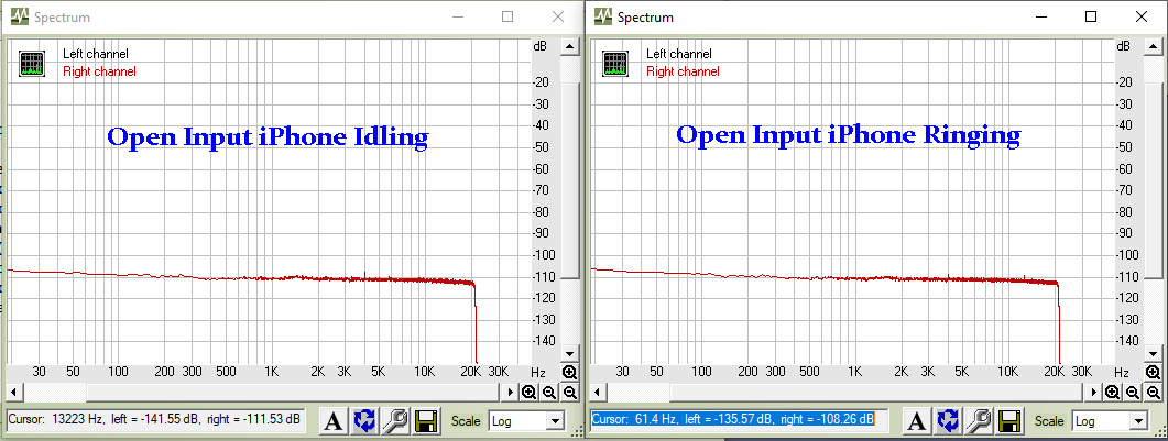

Result is even better as expected.
Two files where recorded with the preamp at 0dB and with open input.
The iPhone was situated as close as possible to the open input.
Image at the left is with iPhone idling and to the right with the iPhone calling and sorry, there is no difference.
Not shown here is the other channel from my A/D as a reference to be sure that the recorded BPBP noise is well above the A/D own noise.
For some reason Audacity could not switch my A/D to a higher sampling frequency this time, but for the purpose of this test I paid no further attention.

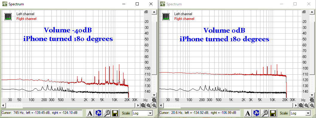

I did another test after having turned the iPhone 180 degrees, possibly leading to a closer position of the transmitter to the input.
And indeed, I could now see signs of EMF in the spectrum.
But when turning the volume down to -40dB, the EMF peaks stayed exactly the same, telling that this unwanted signal was not entered through the BPBP input but was picked up by the output cabling.
You can also see in black the spectrum of the A/D own noise as a prove that the red noise spectrum is indeed from the BPBP.
So this is it, I think the BPBP is not to blame for being extremely sensitive to EMF pick-up from a phone.

Thank you for your measurements, this is very helpful! I am wondering why we see these spikes in the audio range, though. I was thinking the EMI somehow gets into the output stage of the BPBP and causes trouble.

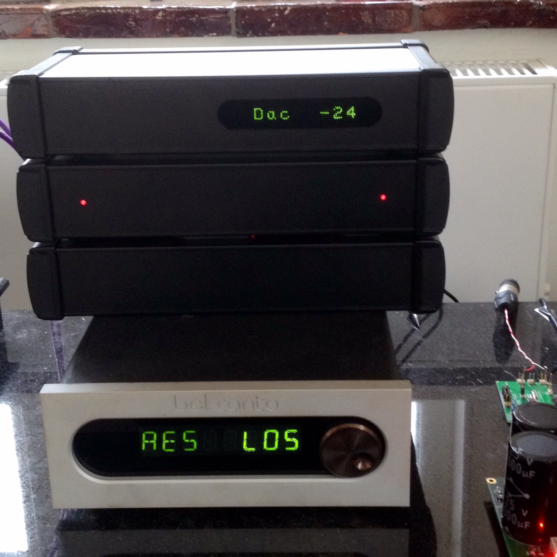

Recorder,
I saw your earlier questions.
1) my supply is in a different box, almost behaving like a battery.
2) the preamp is in a metal box, see picture.
Top preamp, middle power supply and bottom phono preamp.
3) the supply needed for the display and for the volume relais is completely isolated from the preamp supply.
Hans
