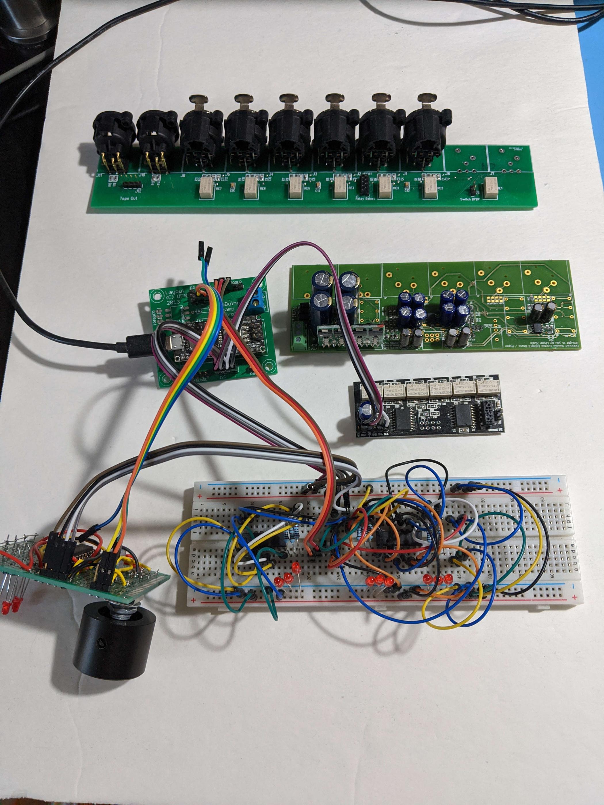

Although not looking for a new "hit" like you mention, I've been dragging my butt getting my BPPBP (can we come up with a new name.. please ), and have finally gotten back to it after 6 months. Maybe we can encourage each others continued work by sharing some progress details here as incentive.
I'll start:
VolCB board controlled by Arduino Nano based borrowed from DimDim's Lascala.
Hand wired encoder/LED volume display (binary because Im a Computer Geek) with local I2C controller
Still very much a novice arduino programer, spent a LOT of time trying to create a "one knob controls everything(volume, input/output selection)" solution, and decided to give that up for now in favour of separate I2C controlled input and output selectors.
Currently working on adding the code for the above.
I also have a Galaxy case that I want to start doing the front/real panels for (debating here whether I want to give it a go with just my drill press or go whole hog up front and order proper FPE panels).

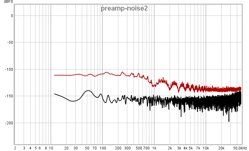

I really like the volume control, it's a very cool project. When I put my phone close to the connectors I can measure that the noise increases (see attachment: the red measurement is with the phone and the black one without; gain is close to 1). The volume control is in a grounded metal housing. I know it's kind of extreme to put the phone next to the connectors, but for the purpose of getting a "perfect" preamp I would really like to get rid of the interference. I already tried to attach some 100p caps from output + and - to the chassis right at the connectors without success. I'd be grateful for any suggestions!

What are the connectors you are referring to, the XLR input connectors ?
And if so, are the connectors open or shorted ?
How is your preamp encapsulated, if this is a metal casing is it connected to mains gnd and what external power supply do you use ?

Thanks for the reply, Hans. Yes, I'm referring to the XLR input and output connectors.
I'm trying to be as precise as possible, if you need more information don't hesitate to ask.
I'm using one channel of the preamp, the remaining inputs and the second output is not connected. Basically the DA is connected to one input and the output is connected to the AD for measurement. I am using an external power supply, it's a commercial +-19V PSU that I had in the drawer; it works without problems. The metal case that contains the preamp is grounded to mains ground via the case of the external PSU. The circuit's 0V is connected to the case at the XLR connectors (and at no other point).
Besides the noise from the interference the preamp measures very well.
So there is a DA connected ti’s input.
What is this DA doing, is it producing noise or whatever, and what is the sensitivity of the AD ?
In the 0dB position, the preamp is producing ca 12nV/rtHz which means ca 2uV for the 50Khz BW you used.
Is your AD capable of that ?
The other thing is that I see the LF noise rise by 40dB or a factor 100.
I find that very hard to understand.
What do you read when the DA is directly connected to the AD without and with telephone ?
