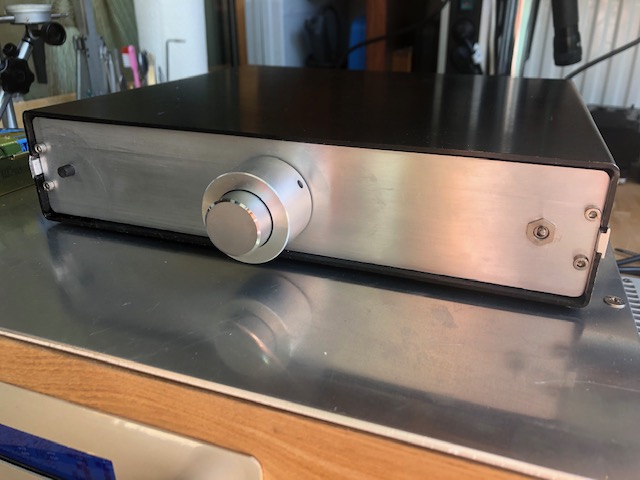

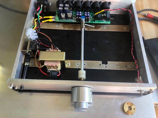

Davide, Great job with the Re-use!
The big question is: How does it sound?
John
Sounds very good, very silent.

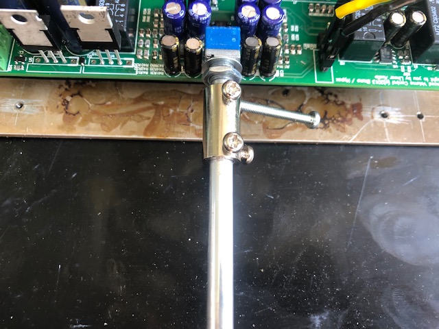

This is my final simple mechanical implementation. The max gain is set to 0db.
D.
