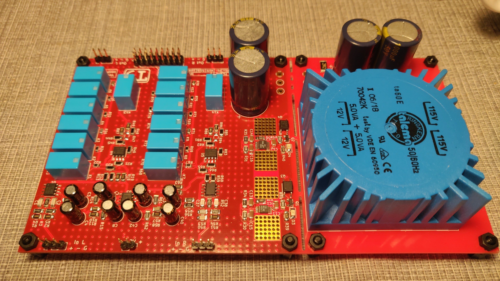

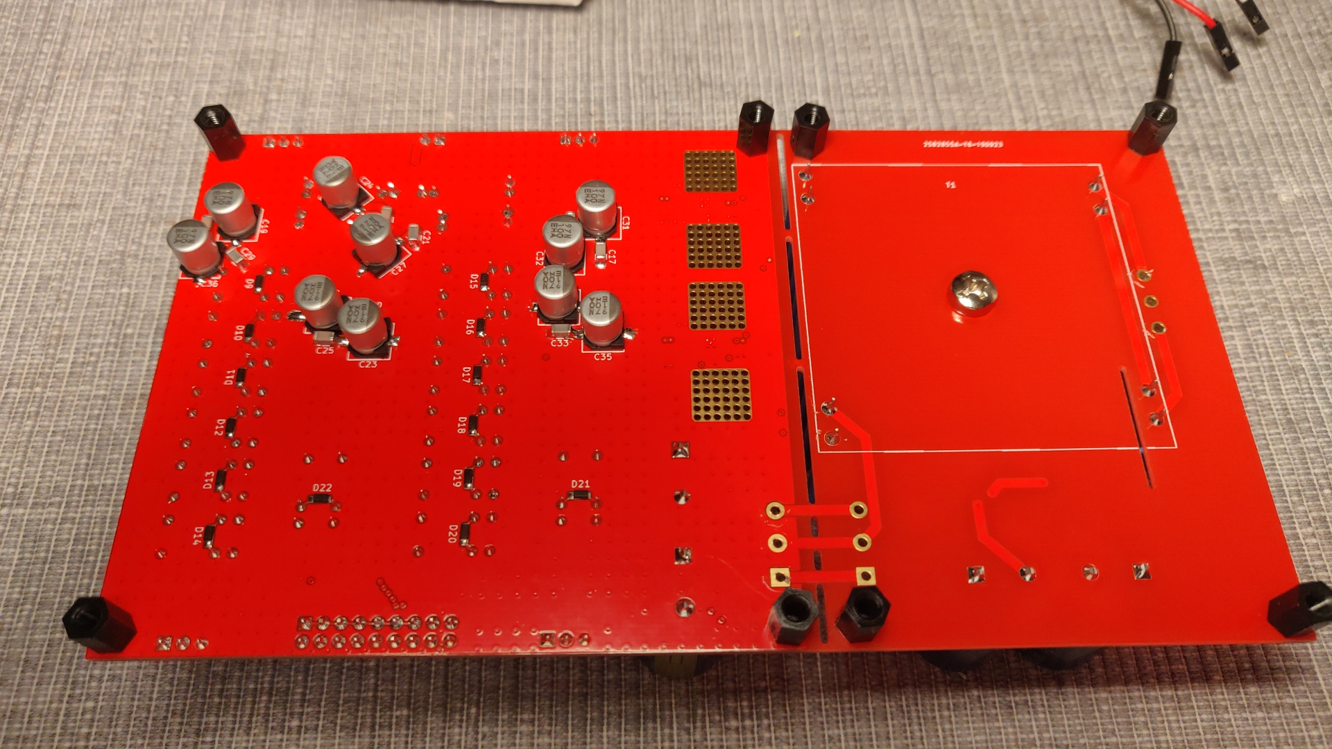

After a lot of sweat and swearing we just finished and tested our interpretation of the circuit using OPA1612/OPA2192, 6 relays per channel with attenuation from 0-63dB in 1dB steps and LT3042/LT3093 regulators. Boards have 4 layers.
More information here: Balanced Stepped Volume Control
Schematics and PCB files are available on gitlab: Files * master * Jurgen Herrmann / VolCtrlDR * GitLab
I quick note on the attenuator resistors. There's a python script on gitlab which I used to simulate all possible resistor combinations in the E-series to get away with the least possible deviation from the desired 1/2/4/8/16/32dB steps. The 16 and 32 dB steps are even combined by using two resistors in parallel to fine tune them. On paper the resulting precision using 0.1% resistors is astonishing! First measurements seem to fully back this...

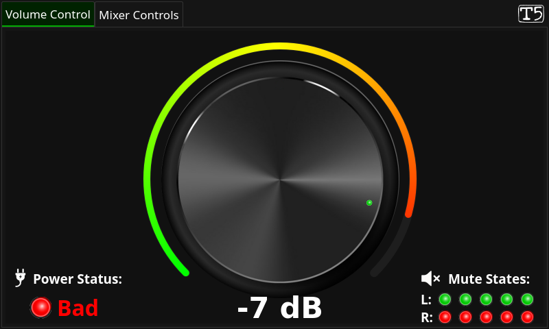

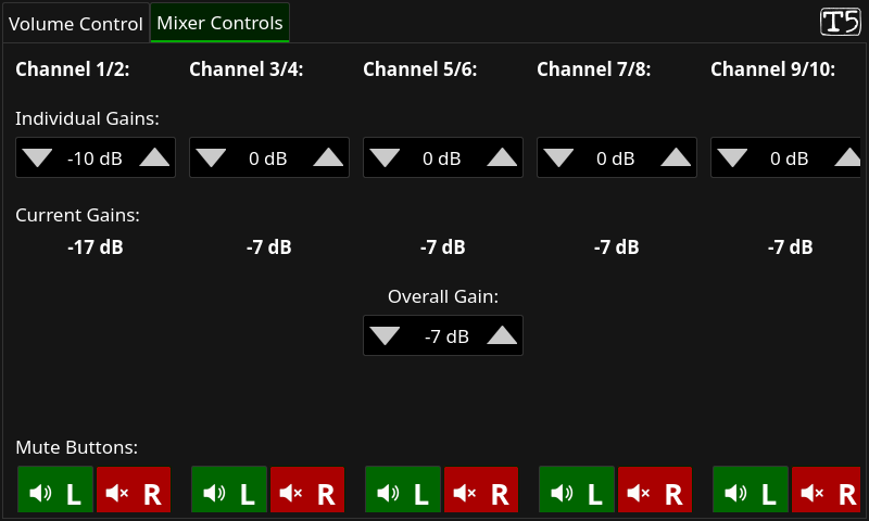

A controller using a 5" oled touchscreen, a ASUS tinker board, a lot of relay drivers, power good monitoring, i2c DAC controls, HTTP remote control etc... will be available soon. Of course all the software and hardware will be open source too.
Have fun with it... So did we today testing and measuring the circuit 🙂
PS: Here's the output from the resistor calculation script:

As I said, great job! Thank you for publishing the design. It would be interesting to see your controller.

Thanks, very much appreciated! The controller will be a real beast, probably not very useable for a lot of people. The design goals are vast. We need to control up to five volume control boards, so 35 relay outputs and 10 power good inputs, up to 10 mono PAs with a mute relay each and pos/neg power good signal and dc detection and up to 5 stereo dac boards with power good signal each and i2c programming capability. I would think that this is way too much effort for a lot of people out there... Also using a tinker board as controller cpu might seem overkill but using standard linux I whipped up the GUI with a fancy control knob in no time, also giving access to per way attenuation etc. The remote controlling capabilities include HTTP and for more detailed control one can use vnc which is rather nice. I attached screenshots of the current GUI state. The tab for the DAC controls is still missing as no dac boards were designed yet.
Once the controller is finished I will probably announce this whole project in it's own thread. Sorry for almost hijacking this one 😀
