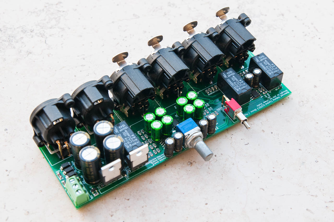

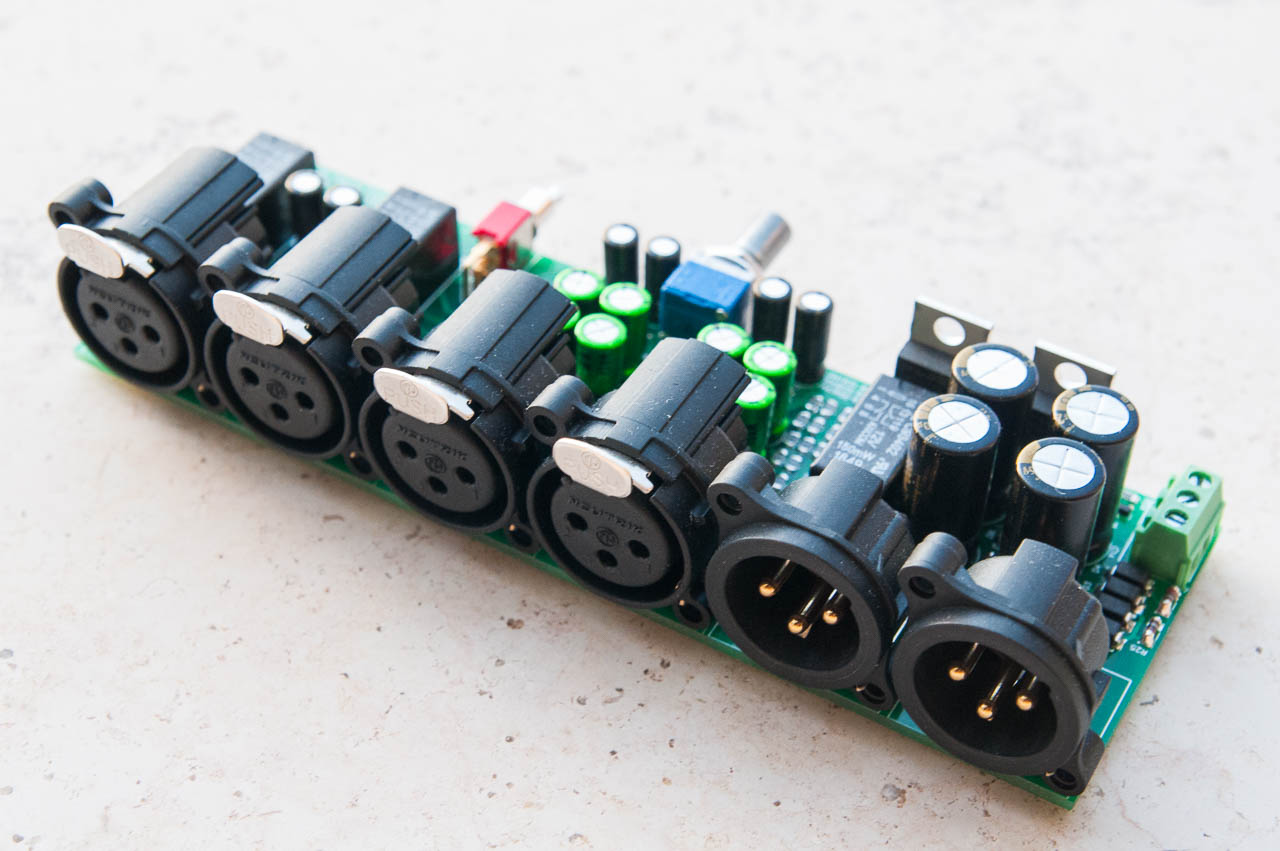

There are 2 versions for the volume control board
1) manually controlled by a rotary encoder, giving 16 steps of 2 dB each
I have no PCB's, but the Gerbers are freely available and can be used to produce as many copies as you like.
Hans
May I ask where to find gerbers for the manually controlled version? I searched online but found nothing.
Send me an email and you will get them.May I ask where to find gerbers for the manually controlled version? I searched online but found nothing.

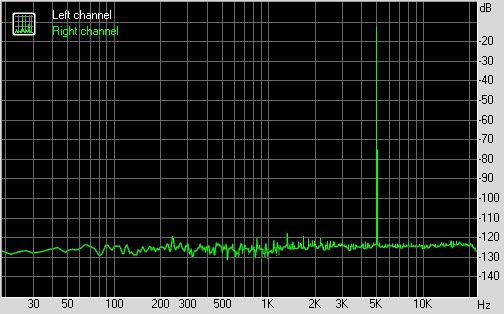

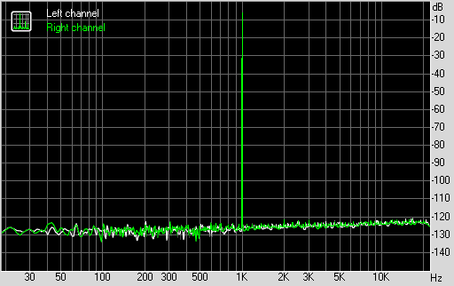

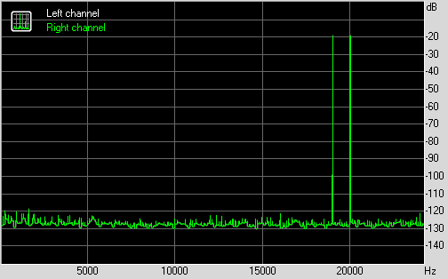

Hans, what sound card (or ADC) did you use with RightMark for these measurements? Less than 0.0001% of noise floor and no visible harmonics look great.
Hi Hans, sent you a PM for the digital VolCB GerbersAnd here are some measurements with the digitally controlled volume board (VolCB) at 1Khz, 5Khz and an IMD test at 19+20Khz.
Hans
Ben
And here are some measurements with the digitally controlled volume board (VolCB) at 1Khz, 5Khz and an IMD test at 19+20Khz. Hans
Thank you very much indeed. Very very impressive indeed.
The Lynx E22 is what I use.Hans, what sound card (or ADC) did you use with RightMark for these measurements? Less than 0.0001% of noise floor and no visible harmonics look great.
