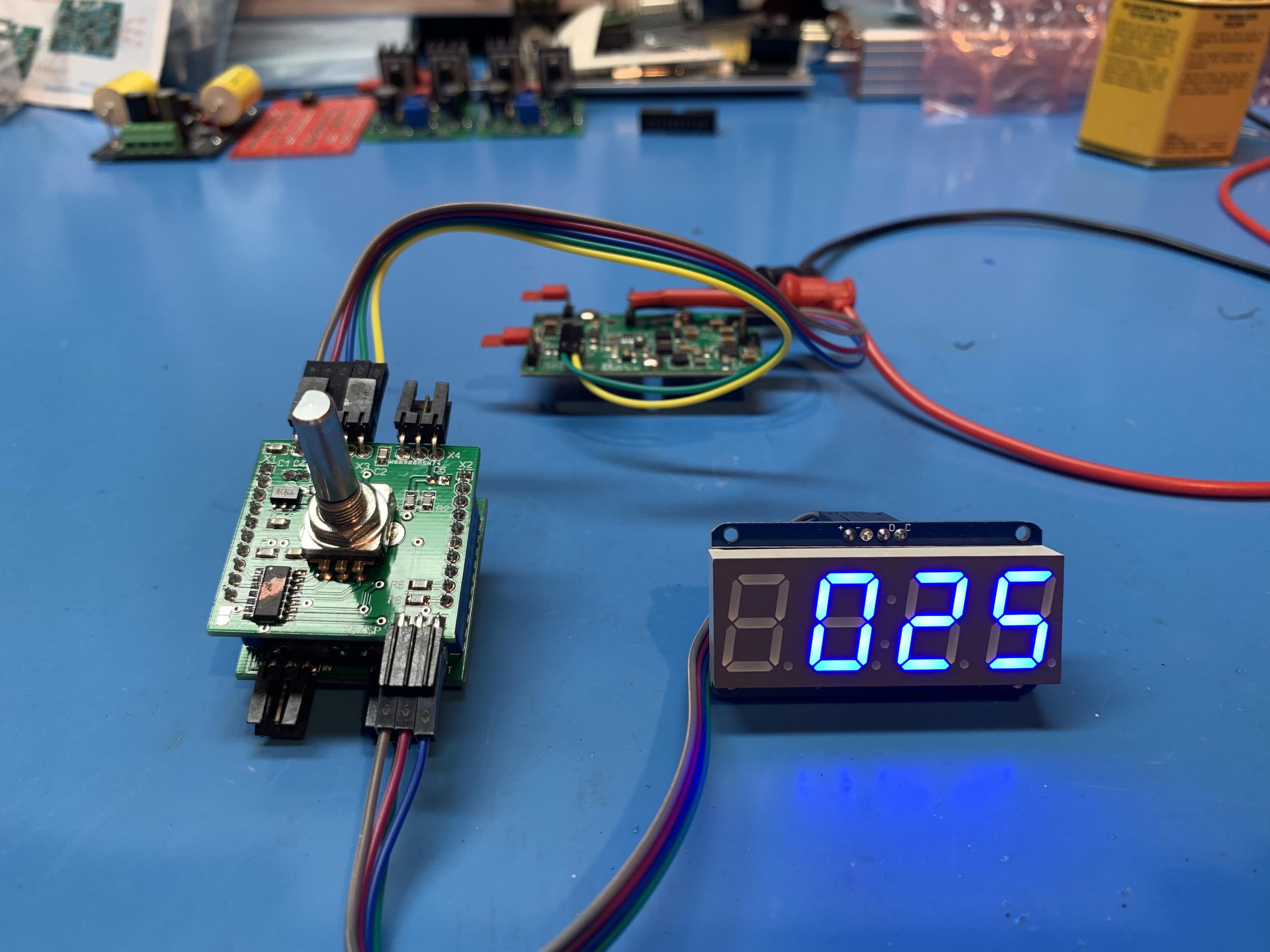

Since the Maya solution with VolCB is no longer available, and Arduino solutions are coming up, I could provide this PCB if there is still demand for.
Hans
Dear Hans, the Arduino solution to replace Maya VolCB would be very welcome. A specific reason to this is that Arduino programming is familiar to many of us. This fact enables customization of the system according to personal needs. It woud be a nice feature if also input selection is included in the solution.

Apart from that I would also appreciate an arduino based version of a VolCB.

Remote control and display would be cool.
Muses Volume
