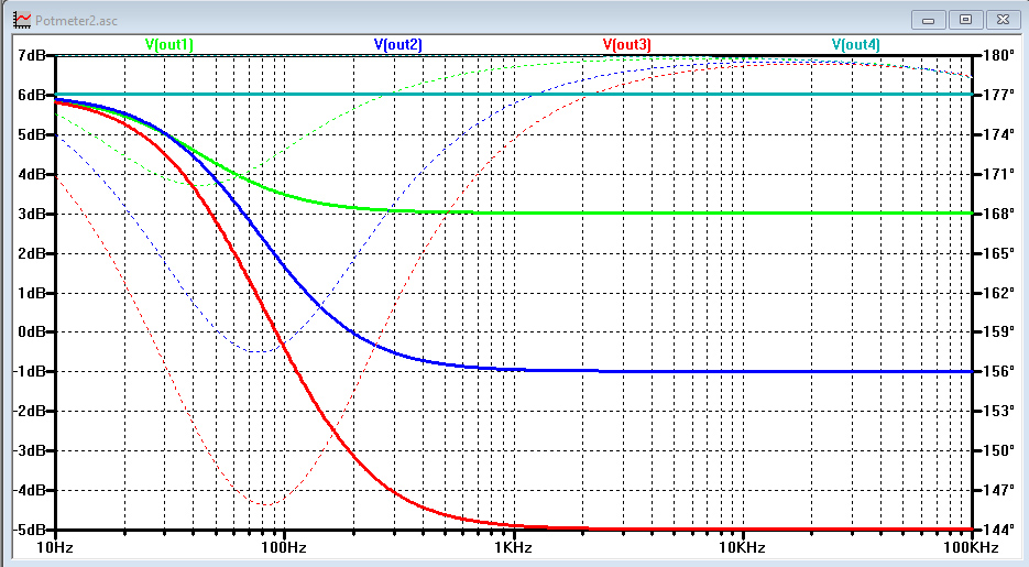

By simply placing a 1H coil from pot input to the 2K resistor that goes to the opamp, I already get the result below.
When you experiment a bit, it should be quite easy to get your loudness control.
By making the coil switchable you can turn loudness on/off.
Hans

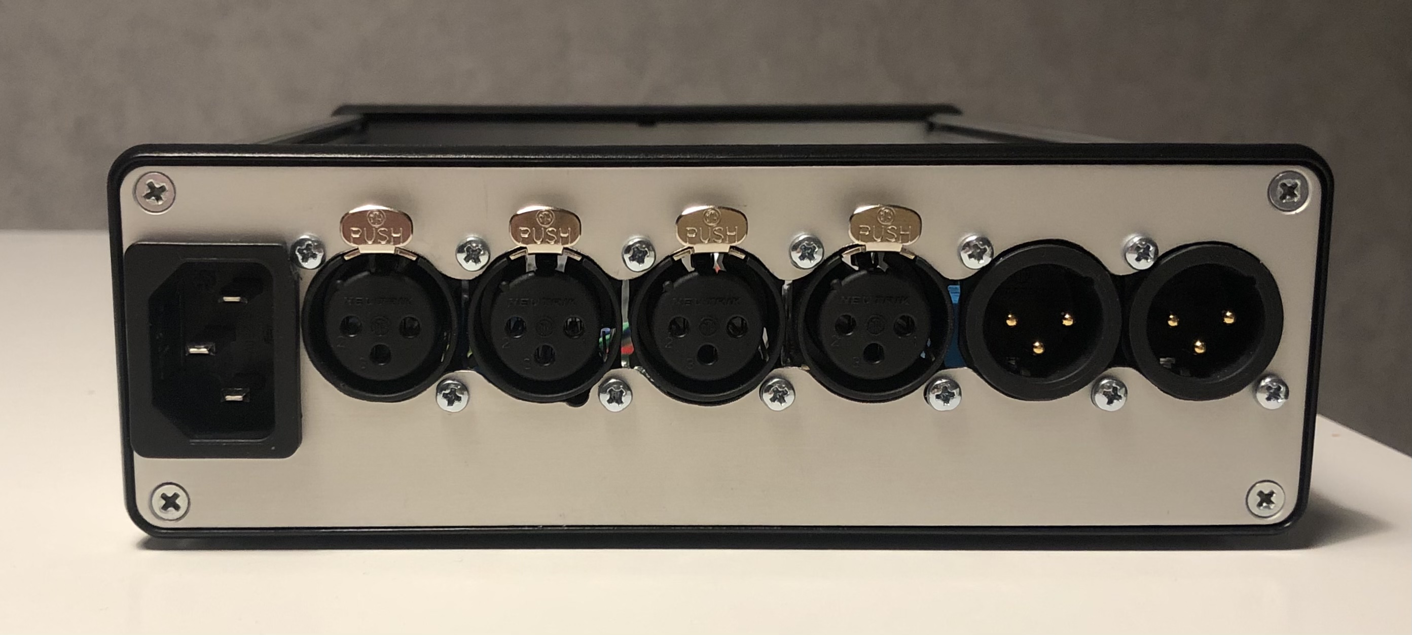

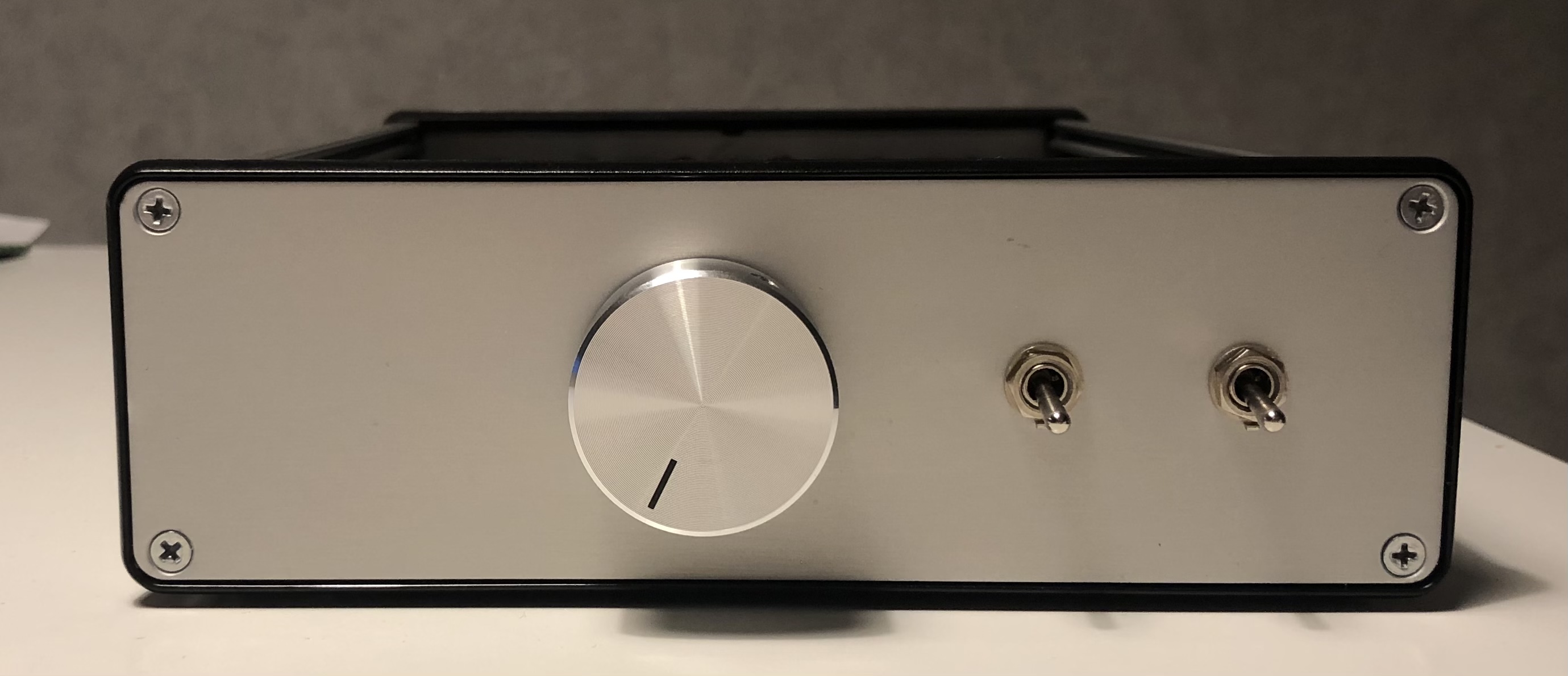

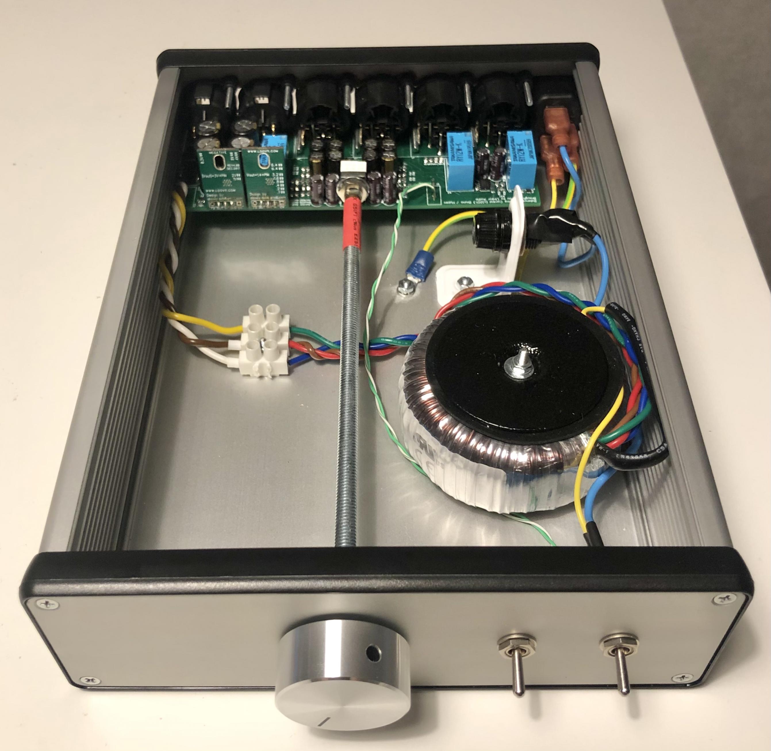

During the Xmas holidays I finished my build of the excellent BPBP. This will be serving in my lab eventually and also to work as a reference but now it is my only balanced pre amp. For the lab use I wanted it to be quite small and hence the small Hammond enclosure.
I had LDOVRs TPS7A4701 / TPS7A3301 regulators laying around so I used them. Otherwise a stock build.
The gain is way too high in my setup with the linear 10k pot so I’ll need to do something about it. Otherwise I’m a happy camper. 🙂
