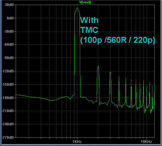

Unless my ears and simulator totally lie , TMC stuart's way works VERY well. It makes my OP's sound like listening to the drivers through headphones. 🙂
The TMC feedback resistor value is the biggest factor in thd reduction , 1:2 and up for the 2 capacitors is superior to 1:1 as well. The 2 attachments (below 1/2) speak for themselves. Another interesting thing I've played with is to bias the OPS undesirably (20mA and below) ... TMC still gives a drastic improvement to the sound. I'm absolutely sold on it ... 🙂

its handy to put these on the same plot - use the .step functionality
.step param tmc LIST 1 1e6
and for the added R,C values:
{tmc*220p}
{tmc*560}
the 1e6 factor makes the C practically a short and the R an open for the purposes of compensation
you could also adjust the Cdom for same gain intercept frequency with another value equation
you could also step a Vsource that controls a SW element
So the "1" just multiplies values 1:1 and when you step to 1e6 everything in brackets gets multiplyed by 1M , making the resistor 560M and the cap 2.2F (a short -"millerwise") 😎
Thanks for the explanation, JCX. handy !!
I use ".step param" a lot to refine component values. Some may scoff at the power of the simulation , but the resulting
real world amp performs very close to what the sim predicts.

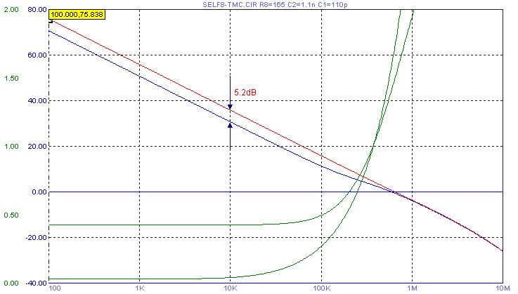

Regarding the capacitor ratio, I've run another sim, with a 1:1 ratio (C1=C2=200pF) and a 1:10 ratio (C1=110pF & C2=1.1nF). Both combinations give the same roll-off at HF, as they have the same equivalent series capacitance, i.e. 100pF. I've also adjusted Ri in order to get the same transition frequency (370kHz). So we may assume that the conditions with regard to stability are similar for both cases.
Now, let's have look at the global loop gain (see pic). At audio frequencies this loop gain is 5.2dB lower for a 1:1 ratio (blue curve) compared to the 1:10 case (red curve).
As pointed out already (see: http://www.diyaudio.com/forums/soli...erview-negative-feedback-303.html#post2355163 ), the difference in loop gain is not without consequences. Distortion and slew rate figures will be affected accordingly. By using a 1:1 ratio, about half of the potential improvement is thrown away. :whacko:
BTW1, the picture below is about the same as in D. Self's article on TMC. He also did mention the loss in loop gain of almost 6dB. Yet he seems to take it for granted, instead of simply change the capacitor ratio. Why?! :scratch1:
BTW2, the green curves depict the ratio of currents through C2 and Ri. The transition frequency is where both currents are equal to each other.

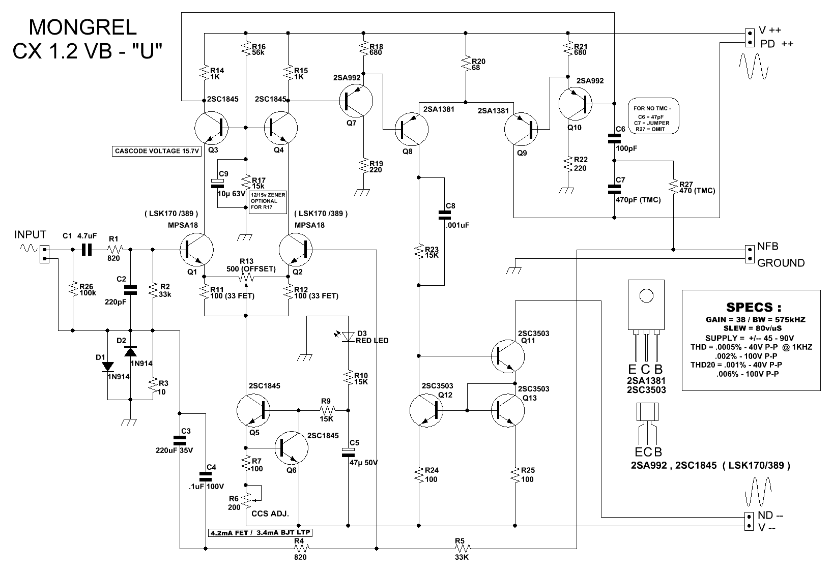

I am already there with the symasym topology. My version with its single pole comp. is a prime candidate for TMC (Below 1). In simulation ,I did take a hit in slew w/TMC (100v/us to 80V/us) , but 80v/us is not bad. What I gained was the predicted -10db+ or more H5/7/9 reduction. This amp , strangely enough , performed best with 1:4 or more capacitor ratio.
Being cautious with my layouts , of course.. I allowed one to "opt out" , jumper out one cap and omit 1 resistor - no TMC... (On schematic)
I am running the blameless/TMC on my "Big Dog" now (PB250n-below 2), and it is glorious , even at 200 watts. TMC has even allowed me to reduce biasing (cooler amp) , while maintaining phenomenal sound. 🙂

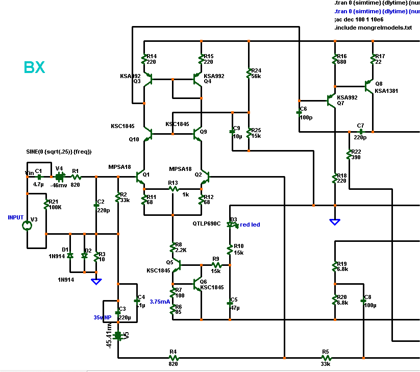

Carlos's simple "Blame ES" w/TMC (my BX) is ABSOLUTELY the winner in cost/simplicity/sound. It has a long term "listenability" that is hard to exceed.
Based on the standard "Blameless" with a 100uF bootstrap instead of fixed CCS , it is amazing that 7 transistors (voltage stage - BX below) can beat many of my more complicated designs. I run 1:2.2 TMC ratio (100p/220p/390R) .. freakin' beautiful !! 🙂 The only improvement to go would be a cascode to allow FET or MPSA18 LTP's (lower noise .. not that there is any now 😀 )
BTW - I am almost over my "sym fetish", ...hawkford cascodes and FET CFP LTP's are more appealing. (I'm going to try it on the cascoded circuit below)

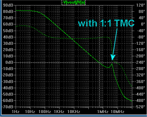

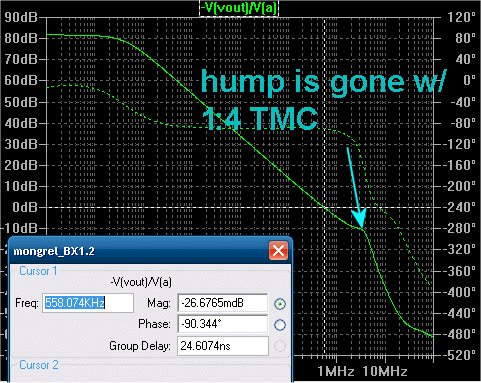

On to the TMC ratio , at 1:1 .. a tinny sound and a bode plot showing a "hump" at 3-4mhz is observed (plot 1). At 1:2 it's just about gone and at 1:3 and up it smooths out nicely (plot 2). Also observed was less than ideal transient tests into capacitive loads with a less than stellar THD/FFT (more H3/5/7). On the real amp it was a change that could be heard , especially going from 1:1 - 1:4.
Changing the TMC resistor from 220 to 680R extends or constricts the "good" phase margin (80 degrees or more) past the UG point. One can regain any lost slew by changing LTP/VAS degeneration values.
