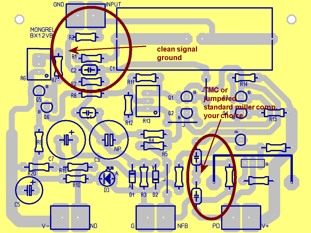

the schematic post3057 still shows Signal connected to the dirty end of the 10r resistor.

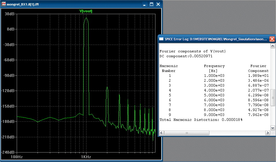

Thanks andrew , the (semi)final board does NOT reflect this(pix1). Believe me , I am listening to some pure music now.
I did get this amp down to 18ppm- 1k / 75ppm- 20k (simulation-below #2). On the real amp my square wave would "ring" too much at 47pF/220pF. I knew it would come down to "trading stability for PPM's" . Realistically , even if I used cascoded mpsa18's the noise of the input pair would most likely exceed the THD I see with this simulation.
I must try ETMC on the "test pig" next.
OS
