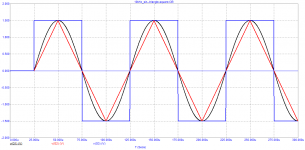

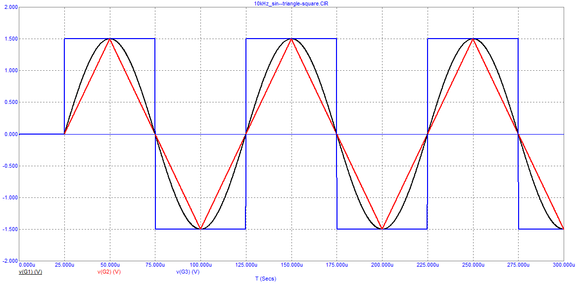

anatech, how can you study the operation of negative feedback without using test signals? I was hoping to get some clarification from Bob.
For example, here are three signals that I use in various tests.
A square wave is also good for learning how FB work, to measure SR.
The triangular signal is the most harmless of all three, it immediately shows the linearity of the gain, and other types of distortion.
If the first period of a rectangular signal does not differ from the spectrum of subsequent periods, then what is the fault of the first period of the sinusoidal signal that it must be decomposed into spectral components and attributed to it cosmic slew rates

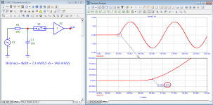

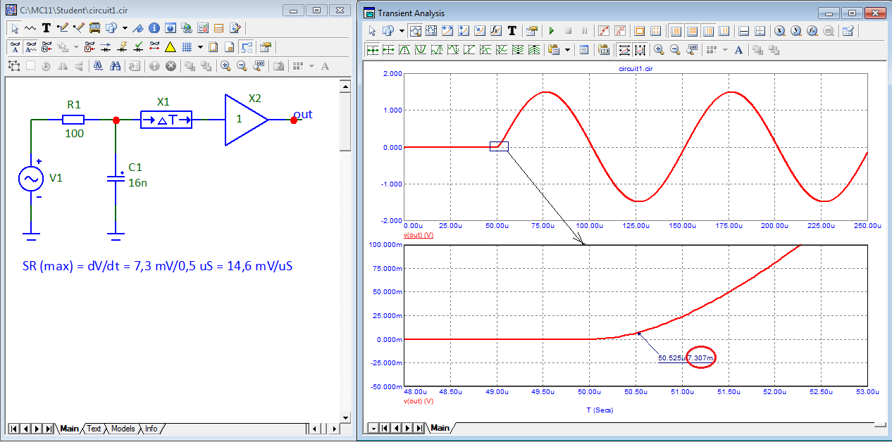

Those cosmic slew rates are clearly visible with the naked eye. Can you not see the location, where the horizontal line makes an instantaneous 90 turn? (I would take a screenshot and highlight the exact position so it can't be missed, but I'm on mobile and even typing is a pain). You could assume that the beginning of the measurement is a smooth continuation of previous identical cycles of a sine wave, but that is not what the simulator or anyone else assumes.If the first period of a rectangular signal does not differ from the spectrum of subsequent periods, then what is the fault of the first period of the sinusoidal signal that it must be decomposed into spectral components and attributed to it cosmic slew rates
maybe you can explain where the cosmic velocities arise in the sinusoid, or where the bouquet of spectral components comes from as in Figure 7, because you claim that today everything can be proved using a simulator
best regards
Petr
Seriously?Those cosmic slew rates are clearly visible with the naked eye. Can you not see the location, where the horizontal line makes an instantaneous 90 turn? (I would take a screenshot and highlight the exact position so it can't be missed, but I'm on mobile and even typing is a pain). You could assume that the beginning of the measurement is a smooth continuation of previous identical cycles of a sine wave, but that is not what the simulator or anyone else assumes.
As you can see, I took a screenshot (I showed this place to Didden before). As you can see, the slew rate at the beginning is even lower than at the zero line crossing points between the sinusoids.
Rate of change, then.
The extremely high delta of the slew rate between 49-50us and 50-51us does not occur anywhere else. You could make a more accurate test signal with 10 cycles, or a 100 cycles, or even 1 million cycles at 10kHz, and despite searching every microsecond, you would not find the same high delta elsewhere along the wave, except in the same position at the artificial beginning.
Yes. Seriously.
Yes. Seriously.
