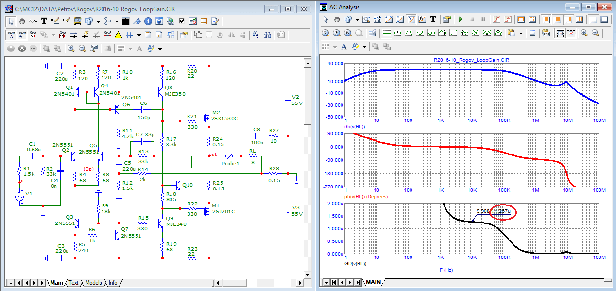

Bonsai, you stated that amplifiers have a Group Delay of only 10...20 ns. If I understand correctly, this does not apply to your designs, which at best have a Group Delay of 150 ns.

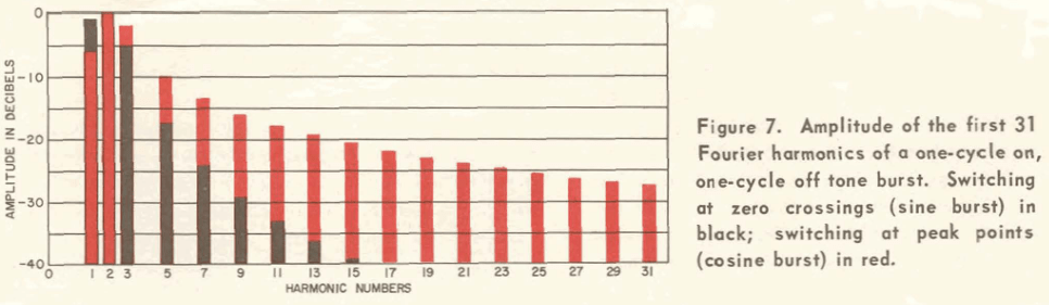

All the plots show a tone burst, not a continuous signal. They are not the same. This should help https://www.ietlabs.com/pdf/GR_Appnote/IN-105 Frequency Spectrum of a Tone Burst.pdf (from 1965) The rate of change a the start of the tone burst will be quite high, similar to the leading edge of a square wave.
Any acoustically sourced signal (read music) will be bandwidth limited by the microphone and the attached electronics. Most mikes used for recording have a sharp rolloff at 15 Khz or below. Maybe the tone burst needs to be low pass filtered similar to audio processing? Even a single pole 20 KHz low pass filter would be far more relevant as a source.

‘Bonsai, you stated that amplifiers have a Group Delay of only 10...20 ns. If I understand correctly, this does not apply to your designs, which at best have a Group Delay of 150 ns.’
Thats not what I said. The loop ‘flight time’ is 10-20ns (any amp you care to name). The GD is s separate mechanism and is between 150 and 500ns (simulation) on my designs.

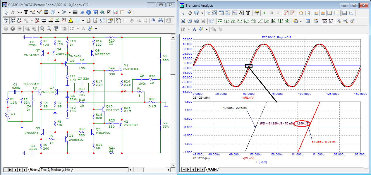

Bonsai, I have repeatedly shown that the group delay taken from the horizontal section of the Bode plot coincides in magnitude with the signal delay time, for example, here.
https://www.diyaudio.com/community/...nterview-negative-feedback.94676/post-7251343
Only very rare amplifiers have a delay time (tPD) of less than 100 ns.
that is why I use 10 kHz test signals most often

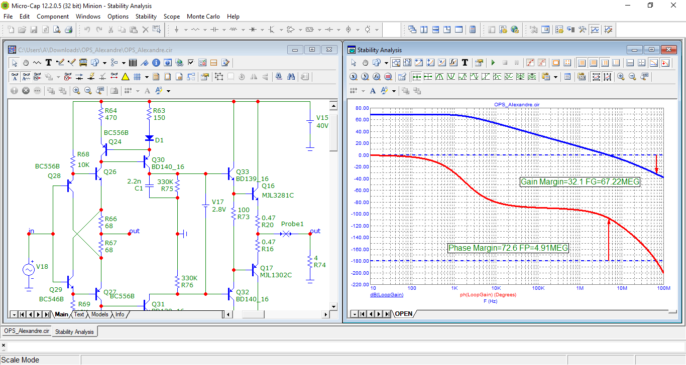

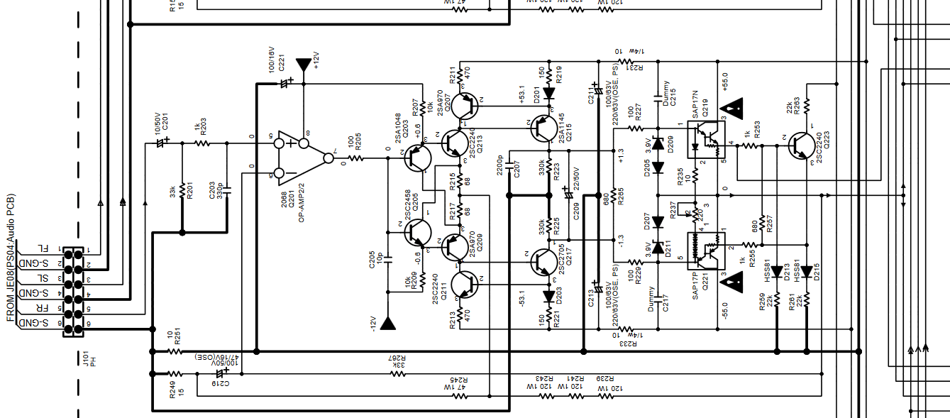

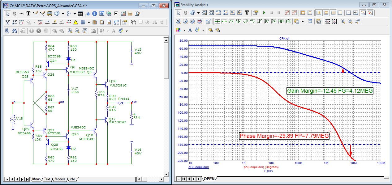

Here's an interesting one. I took just the CFA part of the Marantz SR7300 composite amp and tried to make a power buffer into 4 ohms, with interesting results.
Open loop gain is only 27dB, and yet it manages quite low distortion at unity gain, with 100mA bias. You fellows can download Microcap 12 and open the .CIR file. For those unfamiliar with the excellent MC12 just go to analysis, harmonic distortion, run.
Thanks,
Alex

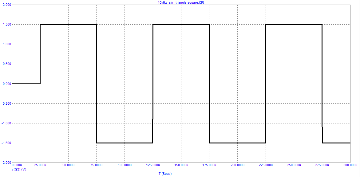

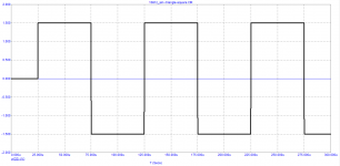

What is the difference between the spectrum of the first period of a rectangular signal and the spectrum of subsequent periods?
the answer is silence.
It seems that theorists do not look here.
Well, then the next question is: who can calculate all the harmonics and their phases of one period of a sinusoid according to this figure
