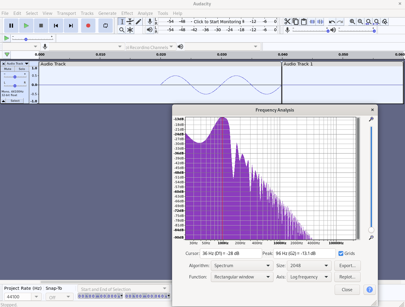

Petr, try recreating that stimulus signal in audio software such as Audacity, and have a look at the FFT results. You are basically sneaking a broad-spectrum impulse or step function at the beginning and end, and claiming that it is a sine wave. It is not. Your "10kHz" wave most definitely contains harmonics that are 100s of kHz.
so show me these hundred kHz harmonics up to 1%Petr, try recreating that stimulus signal in audio software such as Audacity, and have a look at the FFT results. You are basically sneaking a broad-spectrum impulse or step function at the beginning and end, and claiming that it is a sine wave. It is not. Your "10kHz" wave most definitely contains harmonics that are 100s of kHz.

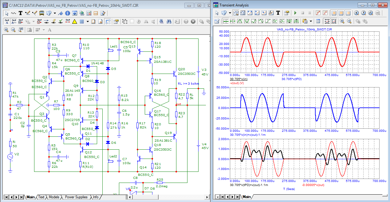

I apply the same test signal to the inputs of different amplifiers. But at the outputs of some amplifiers there is nothing but non-linear distortions, while at the outputs of others additional distortions of up to 1% or more appear.

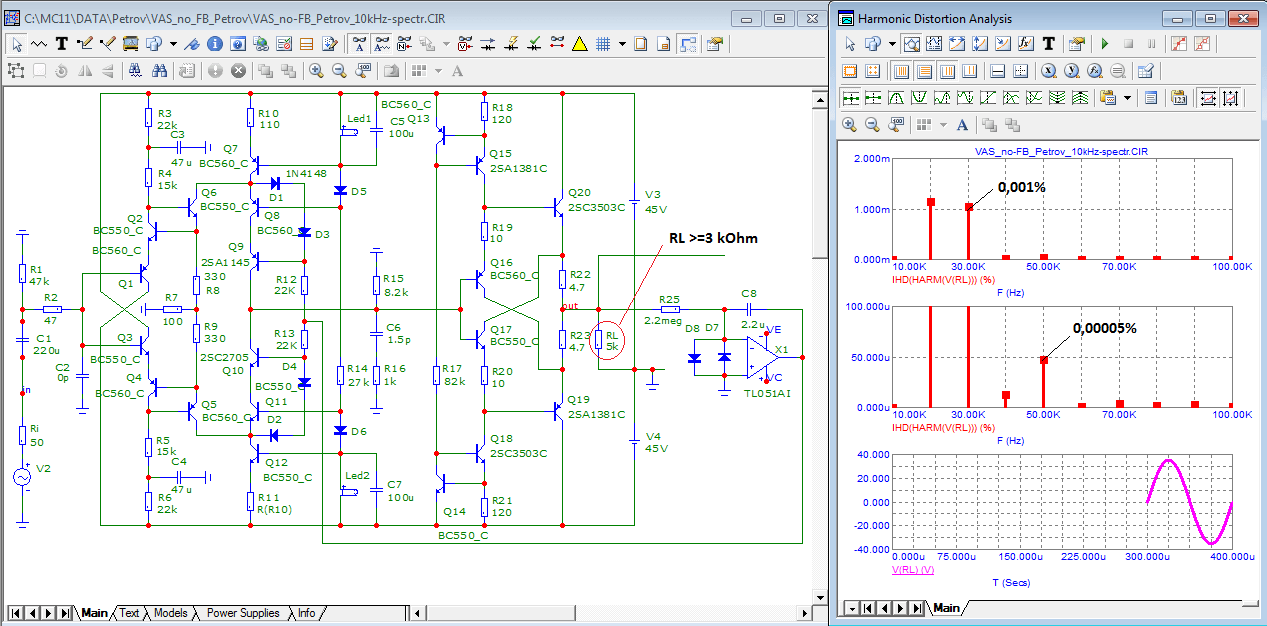

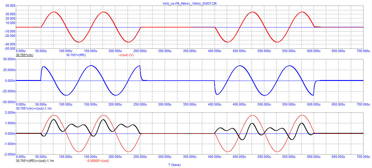

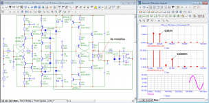

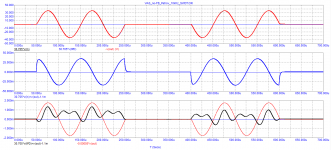

Here is the voltage amplifier test. Figure 01 shows the spectrum of a 10 kHz signal in steady state. The other two figures show a 10 kHz burst test (SWDT).
Select distortion products in any figure that are not related to its spectrum at the output of the amplifier in steady state

The distortion products at the amplifier output are often measured up to 80 kHz. Although there can also be a lot of harmonics above this band.
Above, I gave examples of measuring distortion products from Douglas Self's book in a band up to 500 kHz.

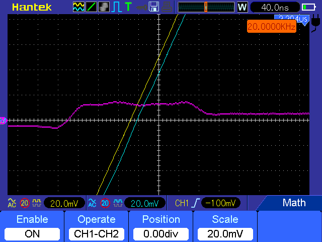

Here is my A class amplifier measured with 20 kHz 5 Vrms to 8Ω load, for that alleged ‘speed distortion’. Yellow trace is input and blue trace is output. At first screen, both probes are connected to input to confirm proper measurement setup. Purple trace is input to output subtraction result.
Second screen is where CH2 probe is moved to the amplifier output. We can see that amplifier has some 15 ns propagation delay. Only existing signal deviation is long exactly as is amplifier rise time of some 250 ns. Not by accident. 🙂

Please provide a diagram of your amplifier. I'll try to run some tests, then we'll continue the discussion.
