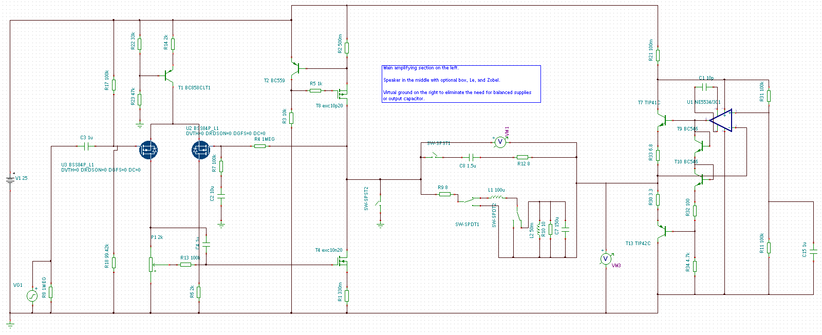

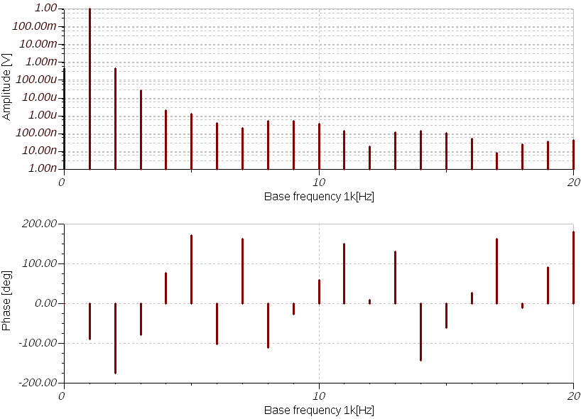

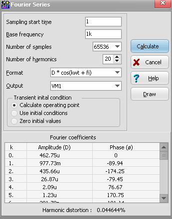

So, here is a basic amplifier I whipped up, using an open-drain N-ch MOSFET and CCS and long tail pair input. Not optimized to actually build, just for basic analysis. The right hand side is just a virtual ground that supplies 12.5V.
I compared 2 versions: one with servo-NFB (~100x gain), and the other with a 10-1 resistor divider NFB (~10x gain). For both types the input level was adjusted to produce 1Vout, and I graphed the distortion both with the speaker's reactive components connected (boxed) and disconnected (nobox) (the Zobel was not included in any of the tests).
It seems to me that, although overall distortion was higher with the high gain version, plugging in the speaker inductance made almost no difference. With the NFB version, plugging in the inductance made the upper harmonics a lot worse.

I think you should simulate again with a traditional split supply, because the virtual ground on the right is a feedback amplifier with all the imperfections that are being discussed here.abstract said:The right hand side is just a virtual ground that supplies 12.5V.
edit: I see a voltmeter on the virtual ground, did you check its performance?
Maybe you're right, I don't know.
The performance isn't great and I probably should have spent more time fiddling with it before offering it as proof of anything, so YMMV. All I know is that switching a more accurate speaker model in and out of the circuit can make some big differences, even if they're not easily distilled into a rule of thumb as to exactly why they occur. With the above circuit, I found that having unequal 6.8+3.3 ohm values for R30 and R33 actually improved the distortion results for the box model, but made the pure 8 ohm results a little worse. Part of it makes sense. VM3 showed about +/-10uV with a jagged wave, given 1V on the left. But if I improved that with 3.3+3.3 ohm, VM3 showed a nicer +/-5uV sine wave, but with worse results for the box model. So it seems like the specific load on the right hand side was cancelling some harmonics, and I'm still investigating that.
A sanity check with a 'proper' virtual ground, like an ideal battery showed virtually no difference between box and no-box model with the 10x gain version, so maybe I was barking up the wrong tree, I'm not sure. That said, even a perfect ground is unreasonable to assume, and at least a few mohm should be added. My original concept was for a current amplifier, so if I use NFB it'll probably be measuring voltage across a current sense resistor. In that case, spurious voltages from a 'bad' virtual ground would be pretty much ignored.
Now that I think about it some more, it may be more specific to amplifiers where the damping factor is low. Then, the gain begins to follow the impedance curve.

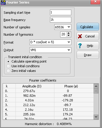

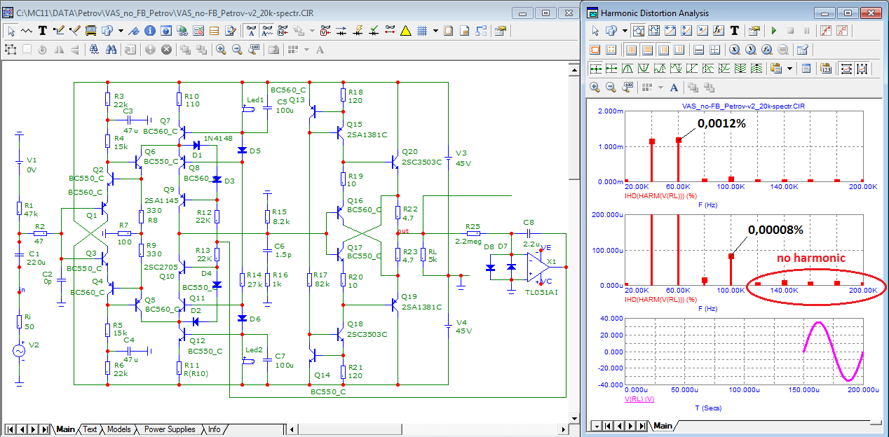

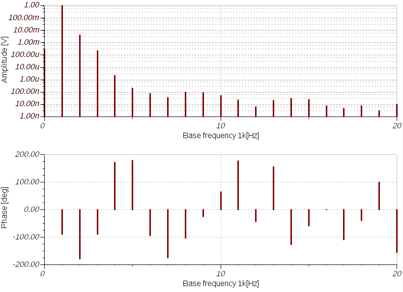

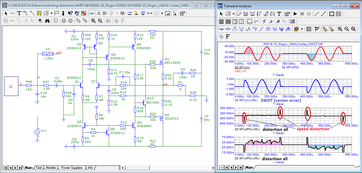

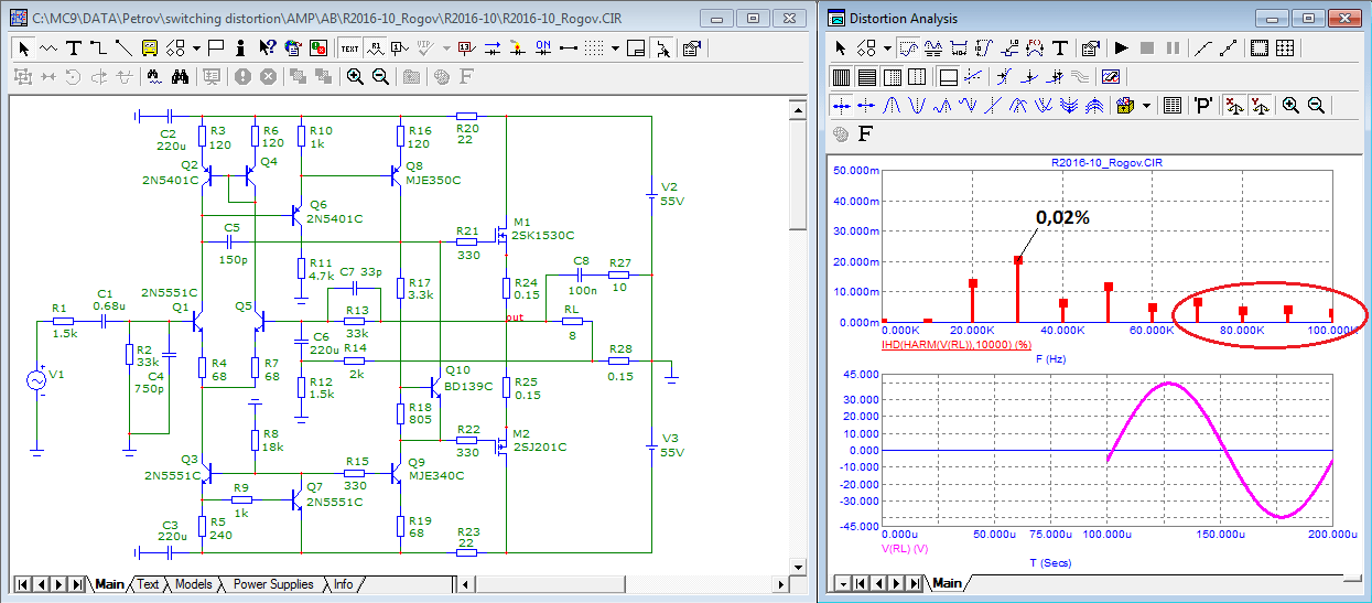

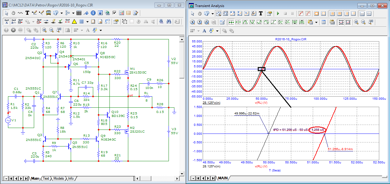

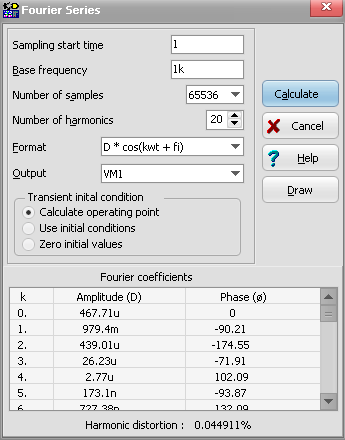

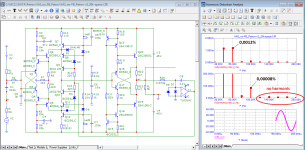

The other day, a radio amateur who repeated the design of the Russian Dunning-Kruger contacted me and complained about the poor sound quality.
I typed the model and did a couple of tests:
Signal propagation delay time 1.25 µs;
THD at a frequency of 10 kHz is about 0.02% (this is 5 times lower than the minimum required for good sound quality), fig. 02;

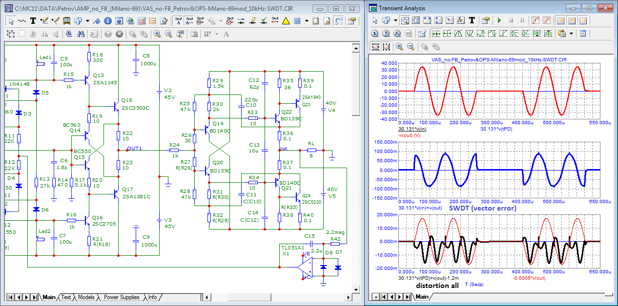

The vector error exceeds the allowable -60 dB and is 3 V instead of the allowable Hafler 40 mV!, fig. 03;

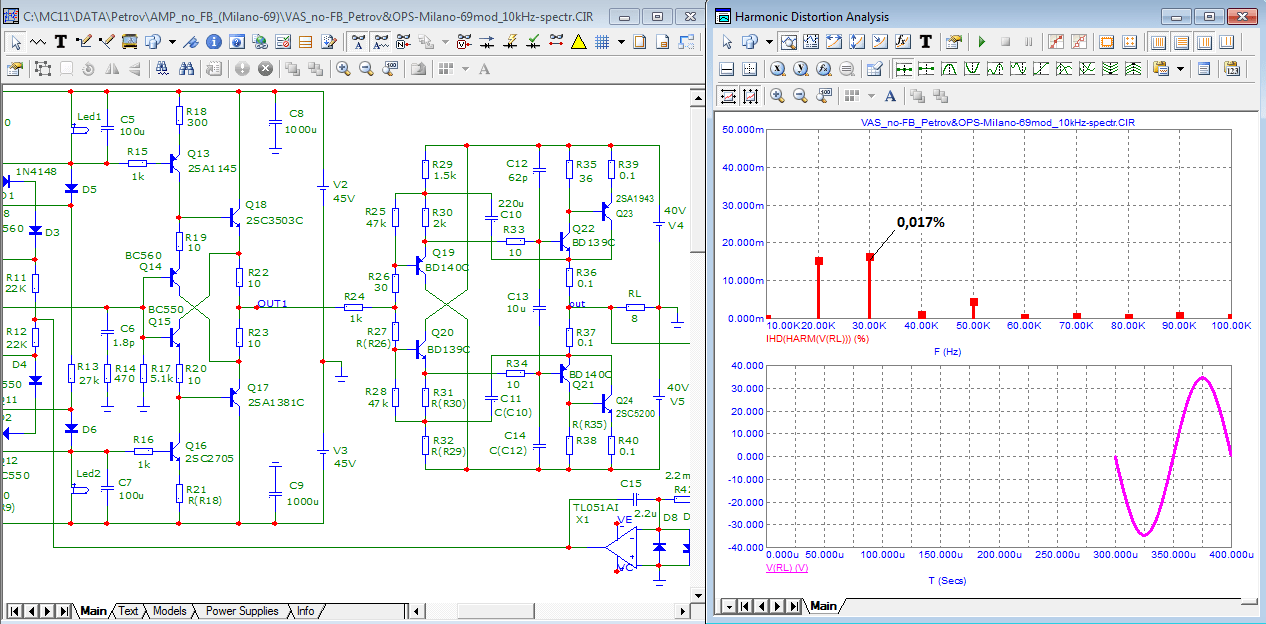

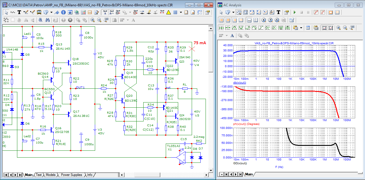

Additionally, I ran my speed distortion test, fig. 04. As you can see, the peak value of high-speed distortion reaches 500 mV or more than 1%!
Therefore, it is not surprising that the sound of such an amplifier is “dead”
As you can see, on a stationary signal, the compensation method, like THD, does not reveal additional distortions.
Correct test signals must be used to detect distortion!

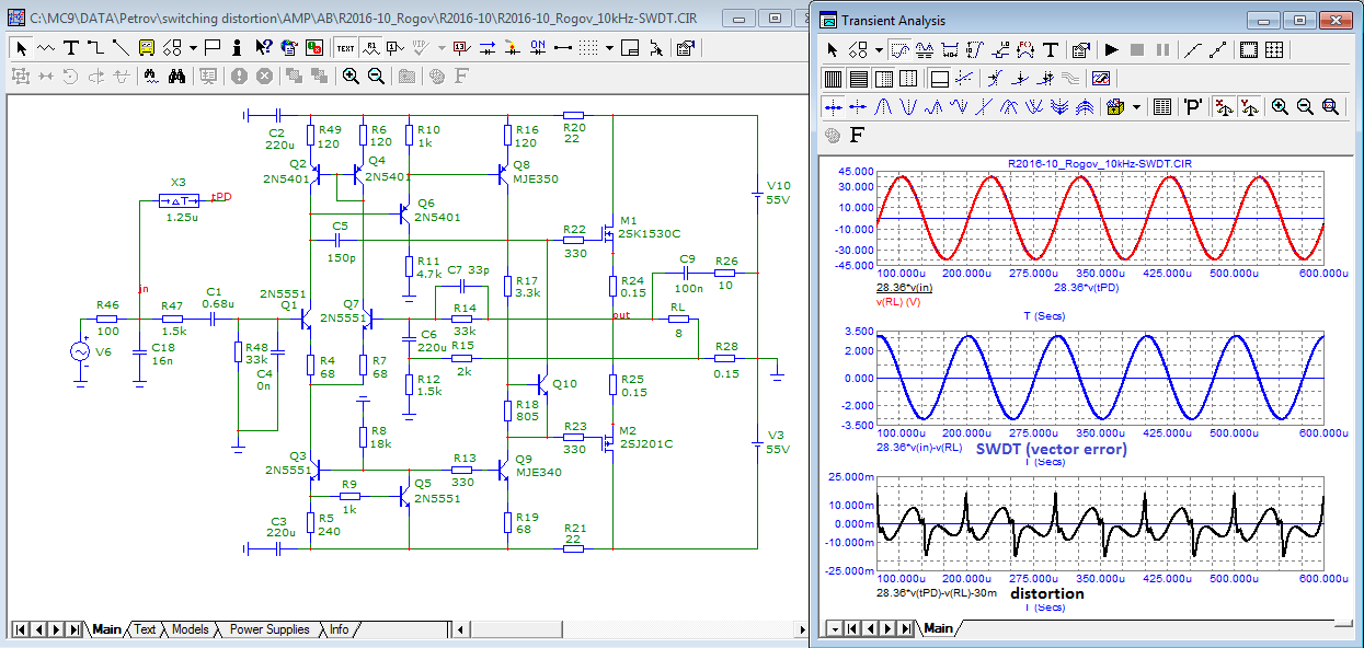

The signals you are using are cut off abruptly, which generates a wide spectrum far above 10kHz. A pure sine wave is continuous with no beginning or end. You could apply a smoothing window that gradually 'fades' the test signal in/out like they do with FFT for the exact same reason. Hanning, Hamming, Blackman windows etc....
best regards
Petr
Unless, you mean to say that the sharp changes are generated internally, such as with class-b?
another delusion!The signals you are using are cut off abruptly, which generates a wide spectrum far above 10kHz. A pure sine wave is continuous with no beginning or end. You could apply a smoothing window that gradually 'fades' the test signal in/out like they do with FFT for the exact same reason. Hanning, Hamming, Blackman windows etc.

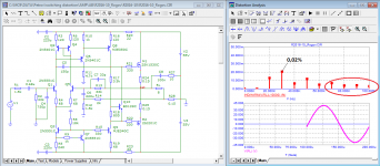

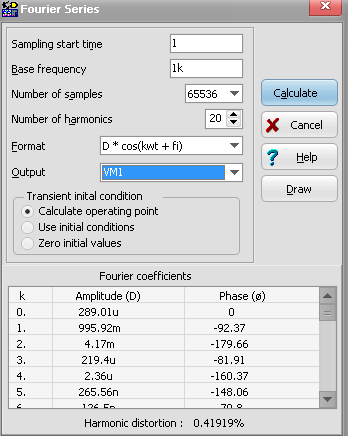

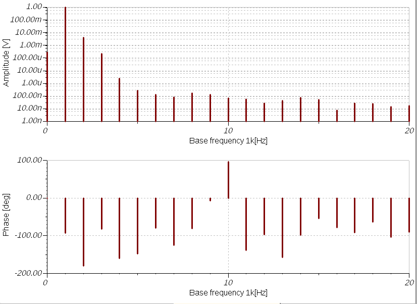

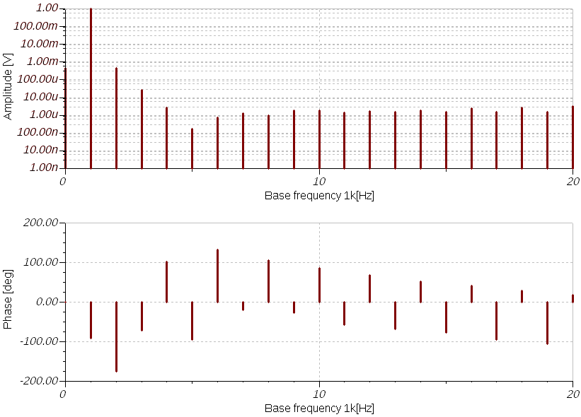

Here is a test of an amplifier without negative feedback that is tested with the same “sharply starts and ends abruptly” signal but for some reason there is no additional distortion.
If you measure THD with Audioprecision, then both amplifiers (R2016-10_Rogov and without NFB) will show approximately the same result: THD ~=0.02% But in an amplifier with NFB, the level of high-speed distortion reaches 1%, and in an amplifier without NFB, they are completely absent. Therefore, it is not surprising that craftsmen such as Nelson Pass, Charles Hansen (1956 - 2017), Lamm, Malinowksi and many others prefer to design amplifiers without general negative feedback.
