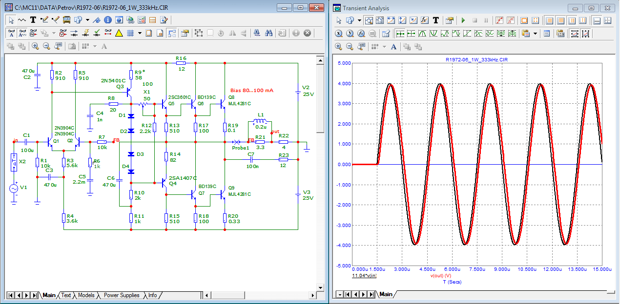

The day before, I gave the test result of the Rotel amplifier at a frequency of 333 kHz.
The result showed that the amplifier has small linear distortions: the gain is constant in amplitude, and there is a slight shift in phase.

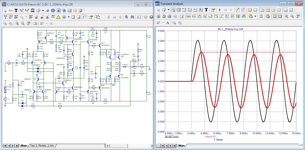

Let's see how the BC-1 behaves
As you can see, unlike the Rotel amplifier, there are significant linear distortions.

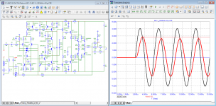

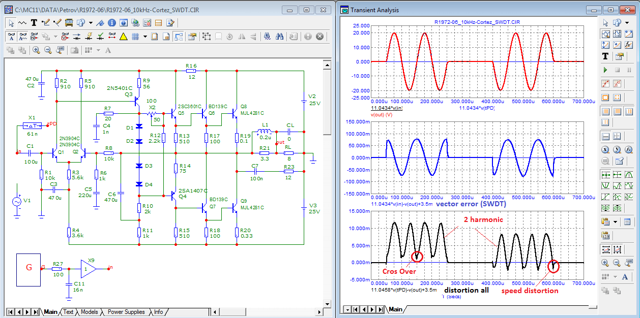

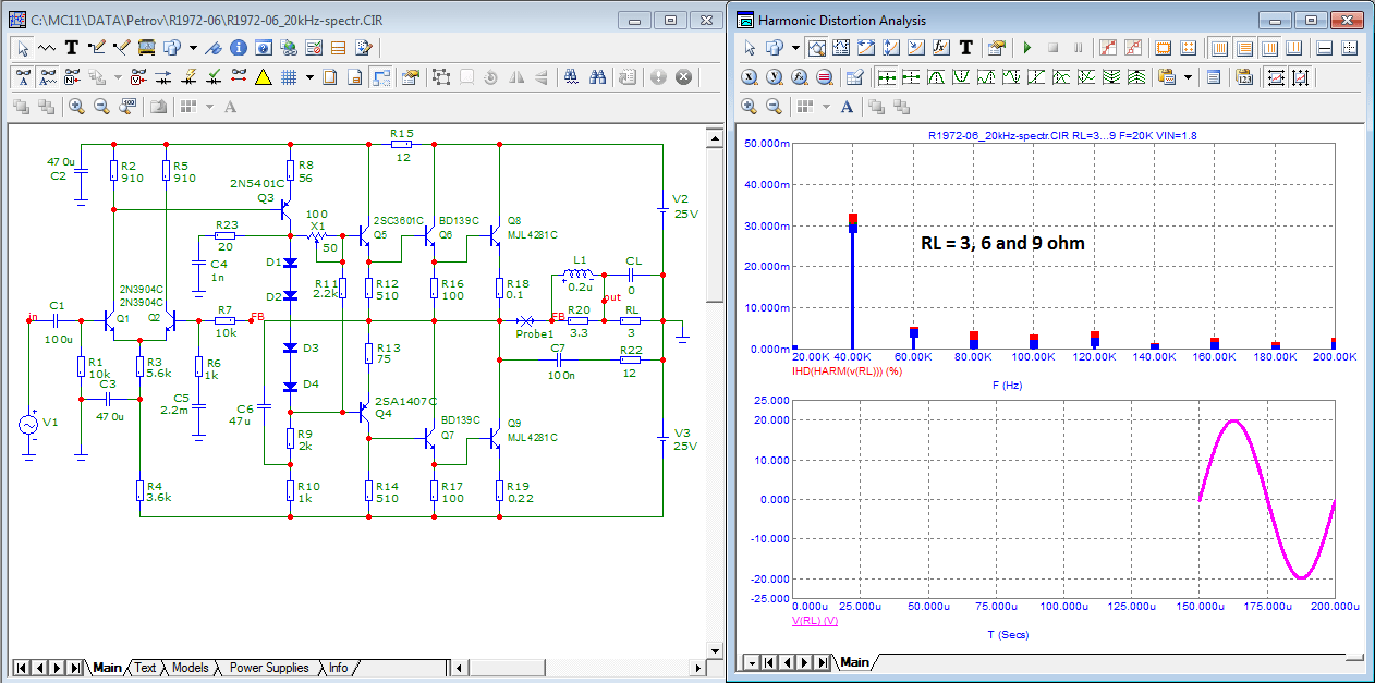

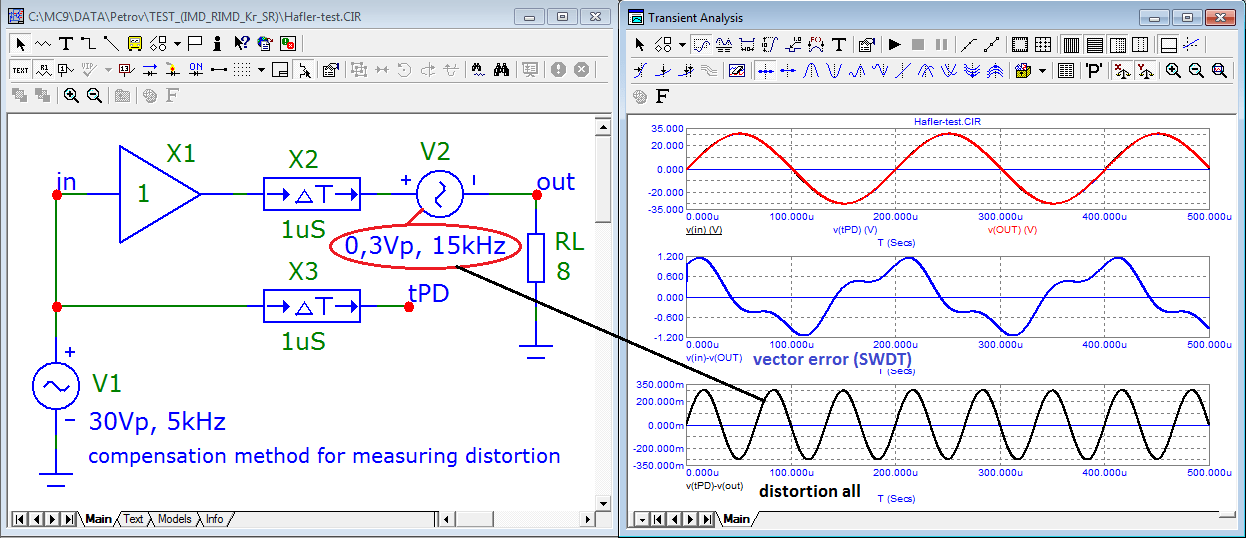

While Bob thinks how to explain it to you in a simpler way, I will show how the method works in my view.
distortion compensation method in action
Suppose we have an output stage that delays the output signal by 1 µs and introduces distortion in the form of the 3rd harmonic at a level of 1%.
We simulate the output stage using an ideal amplifier X1, the signal delay is provided by X2, and the third harmonic with a level of 1% is provided by the generator V2. Let's display all the signals on graph 1: the input signal, the output signal and the input signal delayed by the time tPD.
Since the delay time is only 1 µs, all three signals practically merge into one line (graph 1).
We measure the vector error (SWDT test) using the Hafler test (plot 2, blue).
Even the simplest Hafler test shows that the signal has a large level of distortion that is not visible on the first graph.
The third graph shows all kinds of distortion (in this case, the 3rd harmonic).
best regards
Petr

What amplifier has a hard 1us delay in the loop?
Answer: none.
This is not a valid test.
Answer: none.
I think people are getting ahead of themselves.
Here's a fairly simple test that can be done on a simulator (if you've got a ready amplifier schematic to plug it into) : replace the dummy 8 ohm load with a (slightly less) simplified electrical model of a speaker and box, which includes a series inductor and parallel RLC. Then see what happens to the simulated distortion.
Unless you've already taken significant steps to minimise the effects, I can almost guarantee that the amplifier's own internal distortion will go up significantly. Why? Because the negative feedback is no longer negative at all frequencies. It has to be as close to 180° as possible for the error amplitudes to be minimised by spreading it across the spectrum as higher harmonics (some of which aren't audible). But if it's something other than 180°, then the NFB simply won't work as advertised.
"Just fix the speaker!" You say? Sure... There may some day be a massive revolution in audio and everyone suddenly stops using dynamic speakers based on coils and magnets and switches to optical heating of black-bodies or some other unobtainium, but in the meantime that kind of idealism doesn't actually help anyone who wants an amplifier to make their speakers sound good.
An LR+ (R|L|C) speaker model is still an oversimplification that doesn't take into account other sources of energy storage and reflection, such as partial oscillations of the cone, air resonances in the box, or partial oscillations of the box material. All of those factors will generate voltages and currents in the speaker. It may be terribly inefficient as a microphone, if conducting a test that's set-up to fail, like talking at it, but the much larger signals pushing the cone into motion will also create much larger echoes, and much larger voltages and currents. Those echoes are basically random phase, and would tend to reduce the amplifier's stability at a set of frequencies that ring together with the mechanical components of the speaker. Thus, "damping factor" is kind-of a deceptive term.
Any amplifier that tries to linearize its own output with negative feedback, or even just using a unity gain buffer / source follower, kind-of puts unfair pressure on boxed speakers, making them sound unnecessarily bad, and forcing speaker builders to switch to dipoles and electrostatics and other techniques to avoid those problems.
