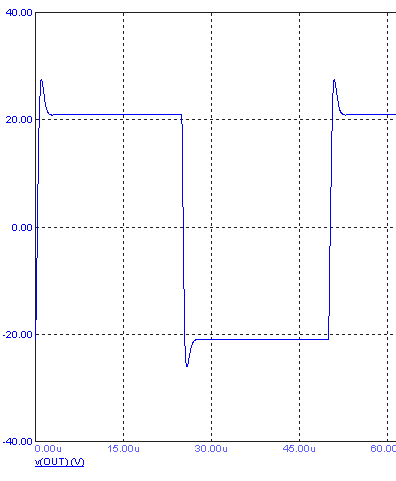

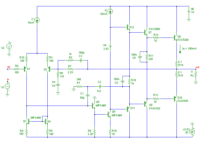

Hi Harry,
Indeed, your choice of capacitor values is somewhat counter-intuitive. So I've run some sims using a fairly standard amp topology. The only thing that's a little less 'standard' is the compensation take-off point, which is moved to the output of the pre-driver. In this way the VAS output isn't (unnecessary) loaded by the compensation stuff.
Here are some results (C3=0):
Code:
C1 (pf)   C2 (pF)   R1 (Ohm)  THD20 (ppm)   PM (deg)  ULGF (MHz)  Remarks
1200      68        1T        104            82         1         Miller
1200      68        390        28            65         1         TPC
68       1200       390        24            65         1         TPC
Clearly, distortion figures have improved WRT to ordinary Miller compensation, though at the expense of the phase margin (PM). Also your 'counter-intuitive' capacitor values doesn't seem the best choice, at least in this case. Probably, other factors are involved that blur your theoretical results. :sad:
Also not mentioned in the paper is that of course the loop gain phase margin can be further manipulated with lead compensation in the global feedback network (i.e. by adding an RC series network in parallel with feedback resistor).
In an attempt to improve the step response, I've added some lead compensation by means of C3=390pF and R2=1k. Now the overshoot has gone. The phase margin is slightly improved (66 degrees), but the unity loop gain frequency (ULGF) increased fom 1 to 2.9MHz!
This is really what we call "putting the cart before the horse"*. If -for stability reasons- we put the ULGF back to 1MHz by tripling all capacitor values, all what we have gained by TPC (in terms of THD) is almost lost by this lead compensation. Clearly compensating two pole compensation is not the way to go.
There are other ways to remove (read: mask) to overshoot, for example a low pass filter in front of the input. However, this (fraudulent!) trick belongs to the same category as putting a brick wall filter (fc=21kHz) behind the output and then claiming that THD20k is zero! :rofl:
BTW, if you don't mind, I've also simmed the TMC variant (by connecting the left side of R1 to the output):
Code:
1200      68        390       2200           99        0.06       TMC bad!
68       1200       390        18            82         1         TMC
As expected, the 1st combination of caps is disastrous, though the 2nd combination is clearly the winner, in every respect: THD, PM as well as step response.
E.
* /OT In Dutch we say "het paard achter de wagen spannen", which means: putting the horse behind the cart. Ain't that funny?
I tried that once in a real amplifier and it didn't work all that well (VHF oscillations, not sure if it was a local feedback loop stability issue or a "parasitic" oscillation problem; didn't really have time to explore it in detail)
In the audio band, the current required to drive C2 increases significantly if it is the larger one; in either case the current required to drive C1 in the audio band is much smaller than the current required to drive a single-pole compensation miller capacitor. If you sim with the compensation take-off point in the VAS collector, I think you should see a THD improvement when C1 is large, but maybe not as you have a triple output stage. BTW, what simulator do you use? The one I have seems to give highly dubious distortion numbers.
If you experiment further with the lead compensation values, you should find that it's possible to change the phase margin without altering the ULGF.
Hi Harry,
The devil is in the detail. Sometimes it works, other times it oscillates. Nevertheless, I choose this take-off point to demonstrate the specific properties of TPC (and TMC) itself, without blurring the results by (potential) loading effect on the VAS output.
As a matter of fact, I've also simmed this amp with the compensation cap directly tied to the VAS output and the result were near identical.
In the audio band, the current required to drive C2 increases significantly if it is the larger one; in either case the current required to drive C1 in the audio band is much smaller than the current required to drive a single-pole compensation miller capacitor. If you sim with the compensation take-off point in the VAS collector, I think you should see a THD improvement when C1 is large.
I agree with your reasoning, but regrettably I didn't see an improvement.
If C1=1n2 & C2=68p: THD20=29ppm
If C1=68p & C2=1n2: THD20=20ppm
Why?! Maybe another distortion mechanism spoils it. Perhaps because the input stage has to put out more current, hence more distortion???
I'm using MicroCap V9, and which simulator do you use?

Hi Harry,
Okay. Using a 2k2 FB resistor, this is equivalent to 180R and 31pF.
Indeed, the phase margin improves from 64 to 90 degrees with an increase in ULGF of (only) 15%. However, I was more concerned about the overshoot of the step response. Admittedly, the PM is much better now, though the overshoot is still there (see pic).
In the past I also complained about this 'feature' of TPC. By then, Micheal objected that this could easily be repaired by means of only one C and one R. I suppose it was just lead compensation, what else? So for a critically damped step response we need a much larger lead compensation cap (390pF), with all its evil consequences. This was what I meant with: "putting the cart before the horse".
E.
