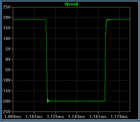

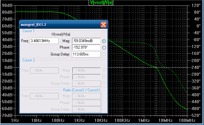

There is a rational way to determine phase margin. attachment 1/2 shows the typical blameless (my real "man cave" amp) with 22p compensation driving a resistive load in simulation. This is the simulated "breaking point" at 30 degrees margin. The first hint of overshoot is at 33p/60dg. margin. Into a simulated capacitive load , damped ringing can be seen at 39p/70dg. margin.
I then tried 33p and 39p on the real amp , a "tinnyness" could be heard confirming the validity of LT's prediction. 47p/80-dg. phase margin is what I initially designed the amp for and this will produce a very highly damped ringing with a large square wave driving a capacitor. 39p will work , but the sound suffers. I am scared to actually try 22p,
even through LT shows no sustained oscillation.
I could get a little more speed with the smaller cap , but opt for better sound and safety. Andy C. once told me to shoot for between 70-80 degrees margin and this has been faithful to me ... no smoke. 🙂
Other designs will behave differently with these same margins as will different devices. I have found the fairchild models to be pretty close to the truth as far as compensation is concerned. I've come close , but have never built a burning amp to date. 😀

I think that when you are using simulation techniques to determin phase margin that 90 degrees phase margin is a good starting point. 90 degrees gives you a safety margin for when you go to build the hardware.
In my limited experience quite often you have to trim the compensation values to get a good pulse response.

I aim for around 60 degrees, which I check in the lab by measuring the amount of overshoot with a 100Hz square wave at 80% of output clipping voltage with an 8R load. If I get <10% overshoot, I'm happy. Overshoot as a Function of Phase Margin
I remove the resistive load, and then use a capacitance box and increase cap load up to 4.3uF (the maximum with my cap box), to see if continuous oscillation can be provoked. I'll then try the cap box in parallel with a 4ohm (and sometimes 2ohm load).
Providing I use an output inductor (typically 1uH), the amps always seem to pass the capacitance box test with no issues.
