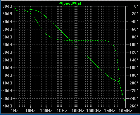

Below 2 is the bode that I know will allow me to prototype without misfortune.

I tried that with a hefty DC offset on the AC sweep and lost 10dg. margin. I also plotted my bode with different capacitive loads and saw the effect on phase. None would turn the amp into a oscillator and the UG point stayed rock solid at 775khz.

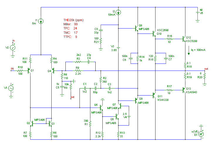

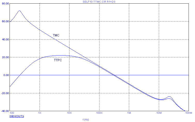

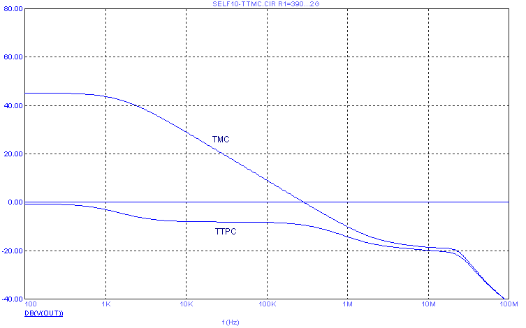

Hi Harry,
Actually, it is not that odd at all. The point is that TMC is only effective if the VAS has sufficient gain, a necessary condition that is easily overlooked. Adding C1 and R1 kills the local loop gain around the VAS and OPS, see the 1st picture.
We can increase the gain by unloading the VAS output, simply by connecting C3 to the emitter of the pre-driver. As you already remarked, this is not without danger, so I tamed the HF loop gain by means of a light shunt compensation network, see 2nd picture, C8 & R21.
Now the circuit works as expected: the loop gain isn't spoiled any longer (see 3rd pic) and THD20 drops to 9ppm, an improvement of about 6dB. Notice that no effort has been undertaken to optimize the component values. So, probably this figure can be further improved.
I suppose you are much happier now.
E.

This is quite odd. Any thoughts on what's going on here? Did you try with C1 and C2 reversed as you found in the normal TPC case this was oddly slightly better from a THD perspective.
[snip]
Thanks again,
Harry.

Hi Edmond,
I have also seen that taking the compensation feedback from the pre-driver is dangerous to the stability of the compensation loop, and have also noted the need for the light shunt compensation at the collector of the VAS. This shunt compensation makes the VAS act a bit more like it does when the Miller feedback is taken from the VAS, with the Miller capacitor providing some loading and controlling the gain bandwidth of the compensation loop. Taking the compensation from the pre-driver unloads the VAS, but sometimes by too much.
Taking the compensation feedback from the pre-driver can be especially dangerous when the VAS is a Darlinton-cascode, as the VAS self-loading is less and there are more transistors in the compensation loop, adding excess phase.
Bob
Unfortunately the ''VAS'' (TIS) output is now loaded by the shunt network negating the purpose of connecting C3 to the predriver.
Better then to stick to connecting minor loop compensation networks to the output of the TIS.
Yes, but that 'light shunt' comes into play at higher frequencies than if you would connect the network to the Vas output instead of the predriver output. Seems to me that there is a 'net gain' of loop gain in the higher freq region.
jan didden
True. But I reckon you need the relatively low output impedance (due to the shunt feedback) of a compensation network loaded TIS to properly drive the output stage.
