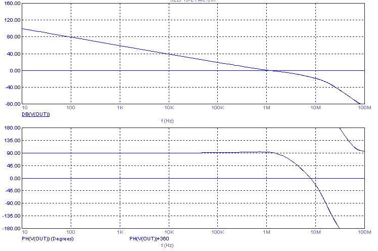

After fiddling a little with the compensation stuff, I managed to reduce the TDH20 even further: 2.5ppm.
This comes close to the performance of the ETMC variant.
The (internal) Miller loop shows a healthy phase margin of 94 degrees at 12MHz.

Hi Bob,
I agree with that. Nevertheless, it is possible to make such an arrangement rock stable. Below the magnitude and phase response of the local Miller loop. The circuit comprises a 'beta enhancement' tranny (resembling a Darlington) and a Hawksford cascode. The compensation feedback is taken from the pre-driver and the VAS output is loaded with a highly optimized R-C network.

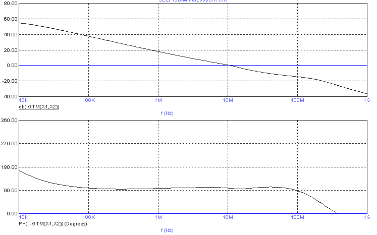

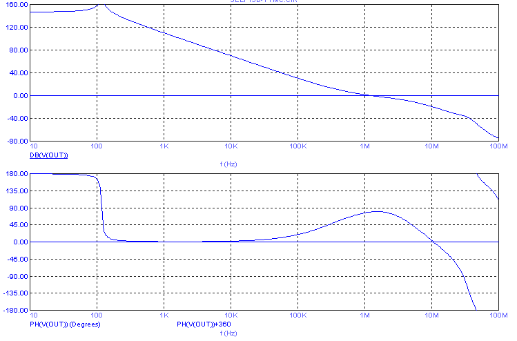

compensation
To all,
Below you see the phase and magnitude plots of the global FB loop of two nearly identical amplifiers, which differ only in the way of compensation. All other things are equal. Apart from THD, which of the two do you prefer (and why), A (1st pic) or B (2nd pic) ?
