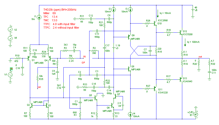

Hi Edmond, I'm pretty sure I'm not confusing the loop gain with the open loop gain, but otherwise this stuff is quickly going way over my head. I was simply asking where is the 0.1Hz or smthing pole coming from. Now that I see the schematic, I really don't get it. If you could post the method used simulate the TTPC gain phase (break point place and method, gain/phase probe used, etc...) then maybe I could figure it out. Thanks for your help, I'm only trying to get an apple to apple comparison in your post #3198.
Edmond, I noticed a factor of two difference in THD20 depending on whether the input filter is present or not. Do you know the reason for that?

Hi Jan,
It's the resistor at the non-inverting input together with the base current that spoils the THD figure a little bit.
Hi YWN,
Here it is. Simply feed the input signal as shown below and observe V(out)/V(in). that's all.
Good luck.
E.

Hi YWN,
Hi Edmond, thanks, I hate being a PITA, I see you changed the schematic re: your previous post, with a 1E6F cap instead of 1mF cap, was the 1mF cap the reason for the 0.1Hz or smthing pole in the loop gain?
I guess the signal is a voltage Vin, but where to feed to reproduce your results? Between IN and OUT, right? Are you not using a gain/phase probe (GP)?
1e6F is what I'm using in simulations. In real live however, it's hard to find a cap that large, so I've replaced it by 1mF for real applications.
The sudden phase transition at about 100Hz has no (or only a weak) relation with these caps.
That's right.
Actually, this is a simplified 'gain probe'. In this case, this method is reasonable accurate, because the impedance at node 'IN' (about 2k3) is much, much higher than the output impedance. The DC working point is preserved by the addition of R35.
(If the impedances are of the same order, you must use a Middlebrook or Tian gain probe. Whenever allowed, I'm not using such a gain probe, as it is a PITA with MicroCap)
E.
Thanks, then I am at lost again about the LF pole. Something is not right, but I don't know what.

As I said already, R35 is absolute necessary to maintain a proper DC operating point.
If I am to ignore this LF pole, if the loop gain is the same (hence the THD is the same),
The global loop gain is (about) the same. That doesn't automatically mean that the THD is also the same. There are more loops and more factors involved.
THD20 of the ETMC amp is at least five times lower than the TTPC amp.
Thanks again, I will look further in the schematic(s) and details; but otherwise, when making a choice, as you also didn't mention up front the circuit topology for each plot, I wouldn't think it is possible to figure out the presence of "more loops and more factors involved", and a x5 times lower THD, from the simple gain-phase plots you posted in #3198.
If multiloops are involved, then I think the stability of an amp may depend on much more than global loop gain/phase margin, be it with a phase dip or not.

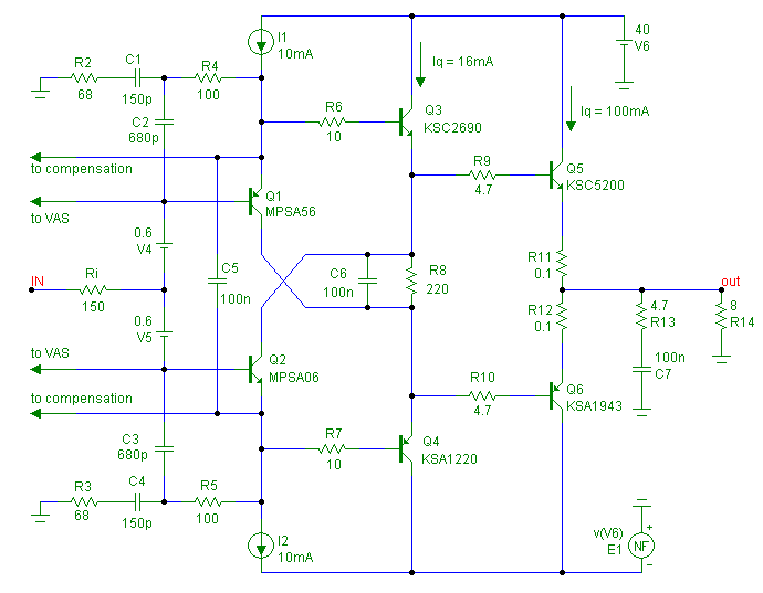

TMC shunt compensation
Hi Edmond,
I have also seen that taking the compensation feedback from the pre-driver is dangerous to the stability of the compensation loop, and have also noted the need for the light shunt compensation at the collector of the VAS. This shunt compensation makes the VAS act a bit more like it does when the Miller feedback is taken from the VAS, with the Miller capacitor providing some loading and controlling the gain bandwidth of the compensation loop. Taking the compensation from the pre-driver unloads the VAS, but sometimes by too much.
Taking the compensation feedback from the pre-driver can be especially dangerous when the VAS is a Darlinton-cascode, as the VAS self-loading is less and there are more transistors in the compensation loop, adding excess phase.
Bob
Hi Bob,
As you already know, I fully agree with above points. But.... loading the collector of the VAS with a (light) shunt compensation network compromises or might compromise the slew rate and increases the distortion. The schematic in post 3220 shows an arrangement which overcomes this unwanted side effect. See below for a detailed snippet. The crux is that the shunt compensation has also been 'TMCized' by means of C2 and R4, respectively C3 and R5. As a result, the VAS loading is only effective at HF, while at AF the loading is far less, hence the slew rate becomes far better and the distortion is about halved.
But that's not all. This arrangement addresses one more issue: a diamond driver with bootstrapped collectors of the pre-driver is rather prone to instabilities, in particular when it is driven by a not so low impedance of the signal source. The second picture shows what happens without compensation and Ri is (only!) 150 Ohms, The peaking at ~15MHz predicts nothing but trouble. The third (right) picture shows the response with TMC shunt compensation. Now, that ugly peak has vanished.
E.

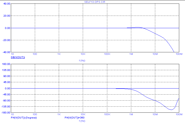

Hi
Many talk in this post about Overshoot depending on the topology, I did not understand in what condition (unconditional instability?).
I also have a overshoot with load 8//2u, I wonder if really this heavy load is required ???

Hi Bob,
E.
Hi Edmond,
Very clever!
BTW, wrt the peak with the bootstrapped diamond buffer, I have some feeling that the speedup capacitor C6 exacerbates it by closing a positive feedback loop at HF around each cascaded EF pair. Without C6, each predriver collector just gets a feedforward bootstrapped signal from the other (somewhat independent) side. Without C6, and with some resistance in series with each predriver base, I think the peaking is mitigated. Just a thought.
Bob
