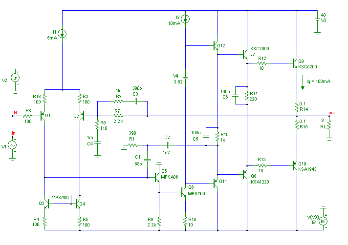

Indeed, that would be impossible for a second order system. The real reason for the absence of a phase dip lies in the fact that TMC is NOT a second order system. The difference between TPC and TMC is that TPC acts on the whole signal of the VAS output, while TMC acts on the difference between OPS output and VAS output, i.e. the error signal from the OPS.
So, one might say that only the error signal is "TPCed". As this signal is only a small fraction of the whole signal, the increase in order (due to TMC) is also a small fraction compared to a 2nd order system like TPC. If, for example, the error signal is 2% (which is equivalent to a OPS gain of 0.98), then the 'order' is 1.02. That is the reason why there is (almost) no phase dip and overshoot. (This also means that the lower the OPS gain, the more phase dip and overshoot. )
> On the flip side, TMC extra loads the input stage, with the equivalent lead-lag compensation network Miller reflection. For identical global amp
> results, this may require a beefier input stage (more current, more degeneration, etc...) compared to simple Miller or TPC compensation.

Is that So? Let's have a look at the (simmed) output current of the input stage for a typical blameless amp with respectively Miller, TPC and TMC compensation. f=100kHz and Vi=1V
Miller: 261.0nA
TPC: 265.9nA
TMC: 260.5nA
So TMC results in the lowest IPS output current of all of the three compensation schemes. Needless to say that I've no trouble with this alleged 'flip side'. :D
Bottom line: Never trust pen and paper math. Always verify the results by means of simulation.

Hi YWN,
For a schematic please look here: http://www.diyaudio.com/forums/soli...erview-negative-feedback-311.html#post2367976
but tie the left side of R1 to 'out' and omit R2 & C3.
I didn't look at the input impedance of the VAS. Instead, I looked at the AC output current of the input stage, as this was what Ophelia was whining about:
which is simply not true.

Hi Edmond, I'm afraid I still don't get it; where is the input signal, is the global feedback loop open or closed? I don't see how the input stage output current (or the VAS input current) could be the same, if the VAS input impedances are different. But then I see you have little patience with reconciling and explaining different views of the same physical reality and prefer to deal with things in a rather confrontational manner. So I'll leave it here and eventually try to draw my own conclusions. Thank you for your help, and I apologize again for intruding in a discussion that is obviously well over my head.
The input signal is delivered to node 'IN' by V1. Can't you read a schematic?
It's closed. Can't you read a schematic?
The VAS input impedances are NOT different, that is, in case of the original TMC amp.
However, Ophelia (Ph.D) has transformed the TMC stuff into something else, which is not equivalent to the original. As a result, she has drawn the wrong conclusions.

Here's a copy of the schematic (notice: a TPC amp):
Hi Edmond,
Your posted schematic reminded me of another thing that might deserve some discussion - that is the use of the speedup capacitor, C6 in your schematic.
I'll be the Devil's advocate here and say that I do not trust the use of speedup capacitors. They are a crutch for designs where the idle bias of the drivers was not high enough in the first place to adequately quickly turn off the output transistors under conditions of high rate of change of output current. They may make designers complacent in that they may improve static THD-20. Present company excluded, of course.
However, to be effective, it seems that if you do the calculations the speedup capacitor needs to be moderately large to thoroughly do the job of pulling out base charge. If they are large, and they have had to do that job, then they will necessarily have aquired a charge. The time constant of the capacitor against the emitter bias resistor may be long enough for the remant effects of that charge to persist over several cycles, possibly leading to an upset bias condition after the event that required the presence of the speedup capacitor.
On general principle, we always have to be very careful when we combine a capacitor (or other charge-storage device) with a nonlinearity (the emitter-base junctions of the drivers). What say you to this food for thought. I seem to recall touching on this in chapter 10 of my book.
I like drivers that really suck without benefit of a speedup capacitor :). The price to be paid is running the drivers hot. I have never used a speedup capacitor in any of my designs.
Bob

Hi Bod,
I fully agree with all these points. As a matter of fact I really hate that speedup cap, perhaps even more than you do. I only dropped that schematic (with that ***** cap) for the sake of simplicity, to demonstrate the principle of TMC and to avoid confusion and/or a debate on other topics.
Perhaps you've overlooked it (never mind, no one can read read all posts), but here you can see that I'm fully aware of the pitfalls of that cap and how to overcome the disadvantages: http://www.diyaudio.com/forums/solid-state/174218-rebirth-phoenix-3.html#post2336489 by putting two TT-diodes between the bases of the OP trannies
See also: http://www.diyaudio.com/forums/solid-state/174218-rebirth-phoenix-2.html#post2334955 for more details. That was a very clever idea. Again, thank you!

Of course you can do it that way, but for those who like 'green' amps, one can avoid running them hot by using two class-AB totem drivers: one for the 'top' OP device(s) and a separate one for the 'bottom' OP device(s). See for the basic idea: http://www.diyaudio.com/forums/soli...terview-negative-feedback-92.html#post1229115 Q9, Q10, Q12 & Q13 (D2 & D3 are LEDs).
Edmond.
